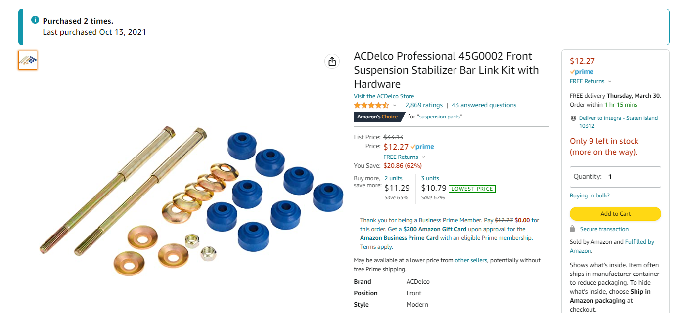

Also, any recommendations for the front sway bar end links? My bushings are pretty crusty looking. The bar-to-chassis mounts have already been replaced.

I've used this end link kit a few times just for the bushing. They are a bit stiffer than the OE rubber and a bit softer than poly. You can cut the tubes to size and source some new bolts but I think I just put some spacers becasue they were a bit too long.
