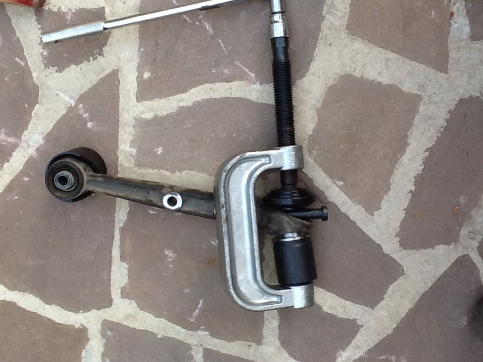

I replaced my lower ball jpoints myself with a simple balljoint press.
Dead simple, but you have to be creative

Well now Jochem00, is that a tie rod end you are using as an "adapter"? Nice... So I just need to find something to fit inside the recessed area where the outside angle is which negates the difficult issue of the angle. Makes perfect sense......so will the ball joint seat fully the way you have it setup in the photo?
Being the one asking the question I do appreciate everyone's input and we all have different experience and ability. That's the reason I asked the question, to learn and gain information so I can make a decision based on my ability and experience. So, I would not go so far as to call everyone else's own experience as nonsense. I fully appreciate everyone's input good or bad, at least those replying are involved in my question and helping as best they can.

yes, scrolled through everything, but there are also posts regarding the upper mount done with a press.
Nobody was saying the the lower one is easy to do at home with the C clamp. Well I show on the photo that it can be done.
I didn't take the photo when it was fully in, as I was happy and in a rush to get the arm back on the car and forgot to take a photo.

He does not seem to be disagreeing with using a ball joint press, indeed he is illustrating a trick that makes it easier with a ball joint press.

Because you wrote "but it is not easy"
It is easy, but with the c clamp you have find a creative solution to pull against the surface under an angle
