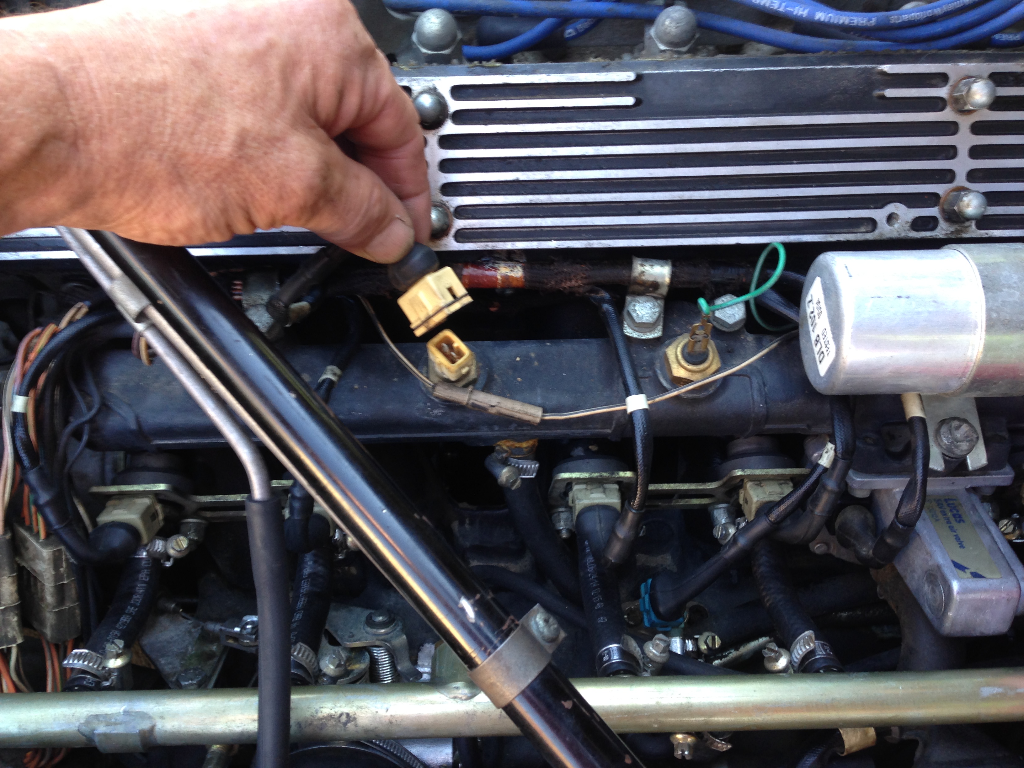

wheres this temp sensor at? one wire going to the fill tank, nothing to cross over there. looked through other forums, can't seem to find the info or a picture.
Old Jul 30, 2015 | 11:20 AM
amaezing's Avatar
Joined: Sep 2014
Posts: 547
Likes: 71
From: Colorado
im guessing this one?
Old Jul 30, 2015 | 12:43 PM
Doug's Avatar
Posts: 25,539
Likes: 11,738
From: Pacific Northwest USA
That's it!

Does that coil tag say "DLB102"?
You should have a DLB198
Can't remember how significant the difference is. Will have to check and report back later
DD

Funny you say that. I was thinking that something is wrong with the coil. Please let me know what you find out. You might have hit it on the head. The P.O. did that. Can we get Lucas coils? It just looks wrong with everything being original is what I'm thinking.

Yep thats what it says

The '102' coil has a primary resistance of 1.5 ohm and '198' coil is 1.0 ohm. That might be enough difference to be significant....I'm just not sure.
The Series III service manual shows use of the higher resistance coils circa 1979-82 and lower resistance coils after that. I've never heard a conclusive reason why.
Anyhow, for years and years the rule of thumb for Ser III 4.2 cars is it's OK to use any 12v with about 1.0 ohm primary resistance.
If none of the other ideas pan out I'd try a different coil....with lower resistance. I've used both DLB198 and DLB170 Lucas coils on a Ser III 4.2 with good results. If yours has a ballast resistor....some do, some don't.... feel free to toss it in the trash. Most of us do.
Yes, you can still buy Lucas coils

I think that the number are so low that that difference is 50% or 150% depending on how you look at it. that is sugnificant(where is spell checker?) and I'm going to change it out. Where can I get a lucas coil at?

alright, The local crap store had a comparable 198 with 1 ohm resistance for 20 bucks. they couldnt find out if it had a resistor in it or not. I told them "I'm bringing it back either way, working or not" "all I'm doing is finding out if this is the problem". Cool they said. So how do I test if there is a resistor in it? I'm not familiar with this. In my expiriences there would be a resistor on the firewall somewhere and if you had a coil with a resistor in it them it would clash with the one on the firewall and would run like crap. I don't see one anywhere, except there is that "box" next to the distributor that I think has a resistor in it. Damn, I don't remember(I did open it up once, but dont remember what's in it)
When Jaguar used a resistor on these cars is was under a tin cover and attached directly to the "+" post of the coil. You can't miss it.

Well you nailed it Doug. You attention to detail is awesome. Noticing the coil in the corner of the picture. Who would have thought? 150 miles today! the stalls are over!!! Woo Hoo!!!!!! I don't know what else to do besides say THANK YOU!!
