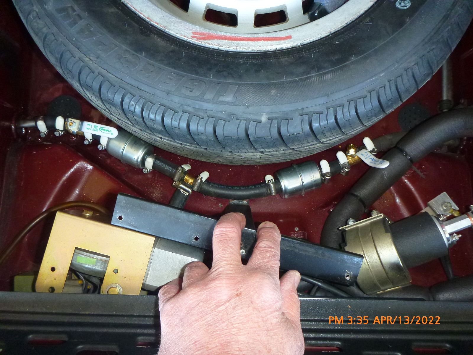

This is why lots of Series III owners add two filters (left and right) between the tanks and the pump.
I'm not familiar with Ser II fuel plumbing so I can't say if such a thing would be feasible. Might be worth thinking about.

Doug's comment about dual filters is very wise, FYI here is a picture of mine in an S3. In addition, the stock filter is still in place down stream from the pump.
Dave
