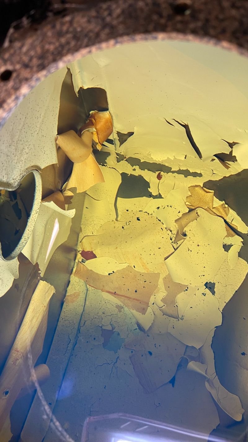

I would not use POR 15 either. Had a V12 E Type come through that someone had done a POR15 treatment to the tank and a year later it was all flaking off in sheets, completely filled the fuel system with particles of the coating that failed. Made a big mess, the entire fuel system had to be cleaned out.
I took off the access panel on the top of the fuel tank and this is what I saw:

That is not POR 15 - POR 15 is silver and sticks to everything -I have never had an issues with it
