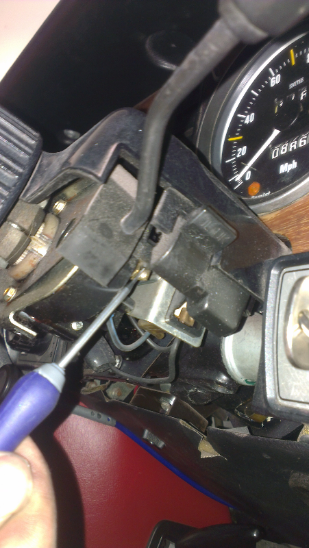

is the high beams switch on the right or the left side in the Series 2 ?
in my 1984, the high beams and flash-to-pass are on the left side stalk switch, the right side stalk switch being for the wipers.

Quote:
the tool in your picture is pointing to the wipers switch, the high beams function is always with the Turn Signals switch, usually on the left of the steering column, unless your car is Right Hand Drive, and the Turn Signals Switch is on the Right side of the steering column.Originally Posted by Anfield Dreaming
If it is Jose I'm going to sit in the naughty corner I'm sure it's the right but now I'm in doubt lol

so the turn signal switch is on the right side of the steering column, as in the picture?
Yes it on the right on the UK car. I tracked it to a faulty relay it a bash and hey presto! However my left headlight won't come on (I assumed it was the lamp blown) so I'm trying to tract that fault now. Any ideas?
