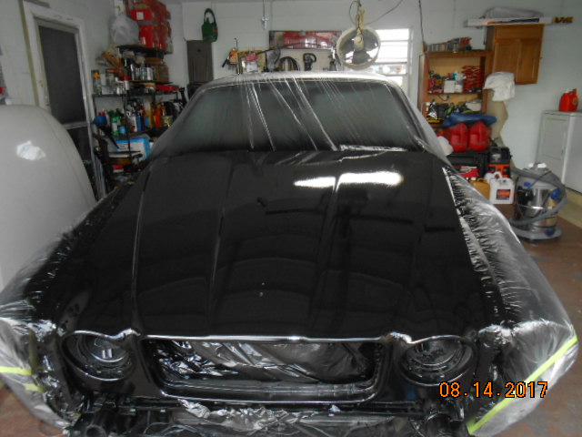

Old Aug 14, 2017 | 05:49 PM
sanchez's Avatar
Joined: Jun 2015
Posts: 1,514
Likes: 687
Progress is being made. I completed the paint job last night. This morning I saw some flaws on the hood so I sanded and repainted the hood. I also started to buff the sunroof.
I should be done by the end of the week.
