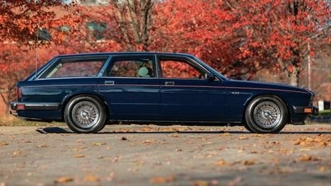

Not so much to add, but I came across this today. Series 3 GT sleeper?
Old Jan 12, 2023 | 10:17 PM
Michael AU's Avatar
Joined: Jan 2023
Posts: 17
Likes: 8
From: NSW Hunter Valley
Isn't that an XJ40 station wagon (or estate as the British call them)?
