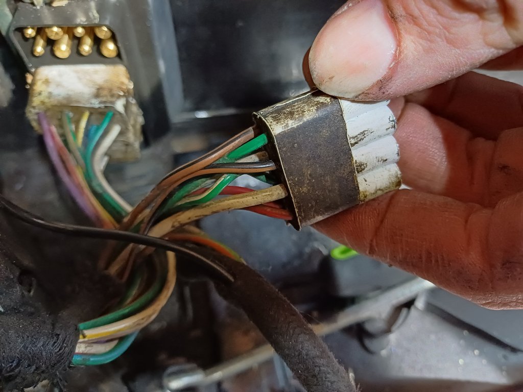

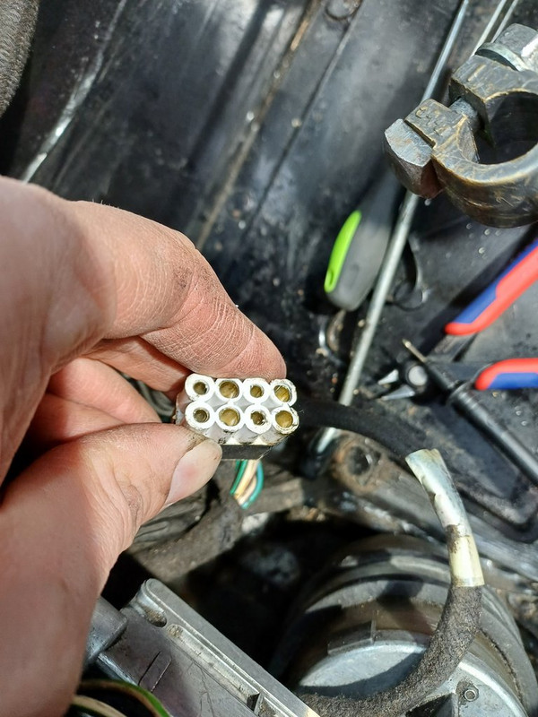

Ok, after 6 more hours in the workshop and almost loosing faith in my brain i found the problem
I was measuring and suddenly i had a connection to earth from both ignition + connectors - even between battery + and earth, even though the ignition key was not connected i measured 3 Ohm. the next moment it was 300 Ohm, then no connection.

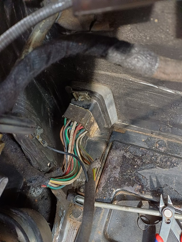

I tracked it down to this connector in the firewall, behind the battery:
when i unplug the first connector (with the ignition plus) the connection to earth is gone. I have a clean connection between the connetor on the cables to the coil and a clean connection from the connector in the firewall to the ignition key. When i plug it in onl a few mm everything is fine but as soon as i plug it all in i get a unstable connection and a connection to earth.
Both male and female part look decent.
Well, what now? change the connector on the cable?
I believe looks can be deceiving. If it were me, I would curl up a piece of 400 grit paper (grit on the outside) and work it in and out of each of the female connectors, then pinch each connector a bit. There should be a slit in each female connector that needs squeezing? Then do the same treatment to the male studs, this time with the grit on the inside of the curl. Then a bit of dielectric grease on the female connectors, then push the two connectors fully in. IF that doesn't cure the problem, then it's the wires to the actual connectors - either on the plug or the jack. The plugs obviously being the easier to cure. The jacks are mounted in the firewall and harder to get to the backside. Hope this helps.
Bill
Bill
That firewall block has a male connector on the other side. The problem could well be that side, as when plugged in the problem appears. I would take a look there before doing anything further.
yes unfortunly the plug is merged to the cables so its not easy to get/change. i have a old wireing harness that came with the car, maybe there is a better plug on it. Then i could change it with a short peace of he cables and then crimp them.

Have you changed BOTH coils and ensured they are corrctly connected in parallel by the two wires that link them (+ to+ and - to -)?
Have you checked the connectors on the coils (the copper breaks inside the insulation) fitting new connectors is always a good idea.
Check the connector to the 'dreaded white wire' the one leading from the Lucas amp to the loom
Check the connector in the V from the trigger on the dizzy bottom that exits the dizzy bottom in the front of the dizzy and leads to the amplifier.
Have you replaced the cooant temp sesnor on B bank thermostat housing? Also check that the air temp and engine temp loom plugs are not on their wrong sensors, as they both are the same. Some looms are marked "air" and 'engine", if not check the wire colours agree with the wiring diagram.
If all this is Ok, I say buy a new amplifier from Manners, which I suspect is the problem anyway..
I have a new high performance coil (single coil) instead of the two ones. Connectors are all new, even the one in the V.
The water temp sensor is new. I will check the wire colours.
Would a faulty amplifyer affect the running engine as well? maybe i check the connectorsin the amplifyer first and then maybe rebuild it....new amplifyers are really expensive here in austria - and ordering somewhere else we have high costums.
