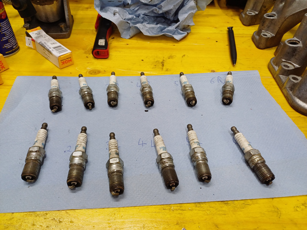

here is a picture of the plugs i took out after i got the car. the last drive was about 30min.
To me they look good - would not suspect it to run too lean. But maybe i am wrong what do you guys think?

Plugs look fine. Have you checked that fuel is being injected at the cold start. If so and if it is, it is spark. Can you borrow an amplifier from someone to try, if buyng a new one is impossible? If it was me, the amp would be the first thing I would try.

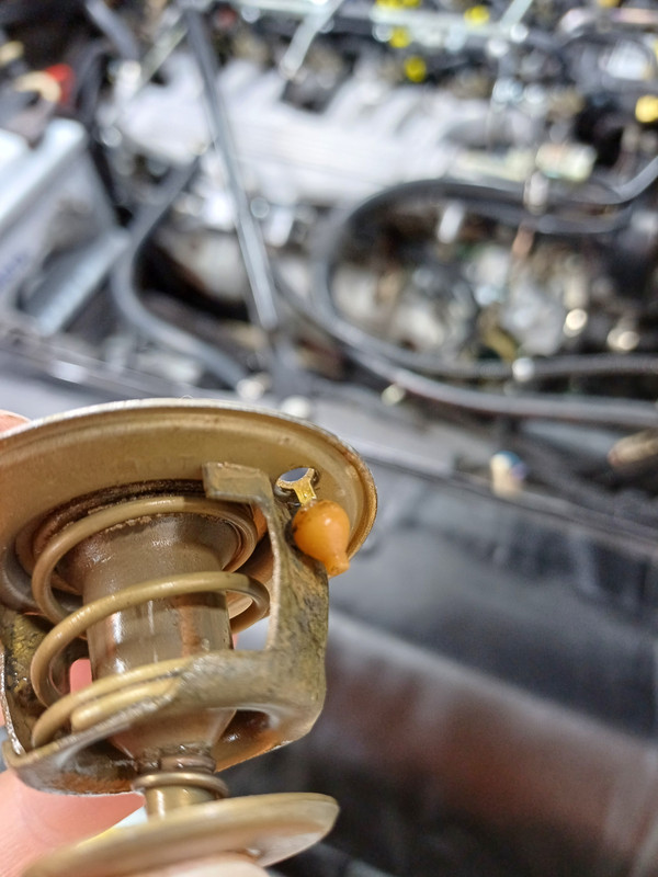

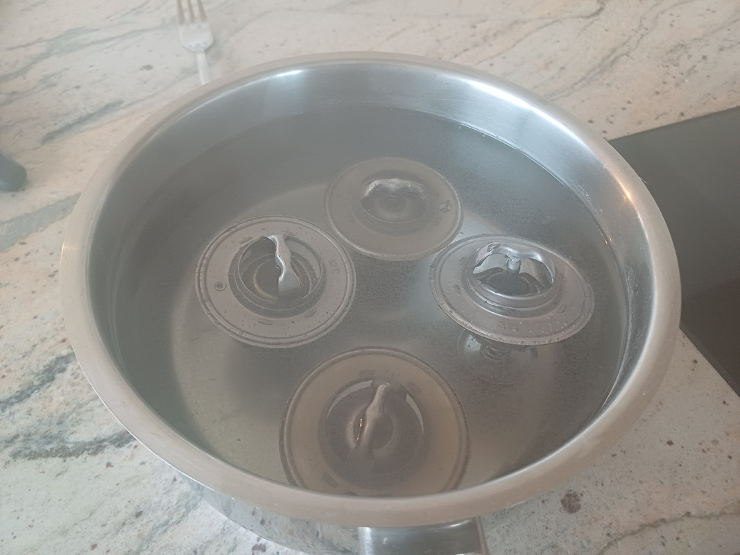

Today on the menue: thermostat soup
All four thermostats open at 82°C as rated and fully close again at 78°C

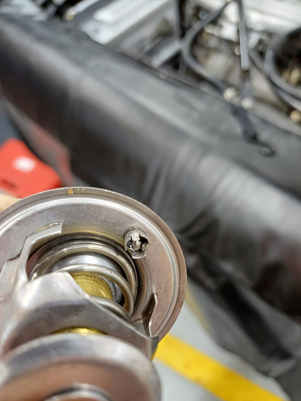

I noticed that the old ones have other jiggle pins than the new ones:
This ball in the new ones is veeery tight and i assume it makes bleeding harder than it is anyway. So i drilled it out and put the jiggle pins from the old thermostats in the new ones.
