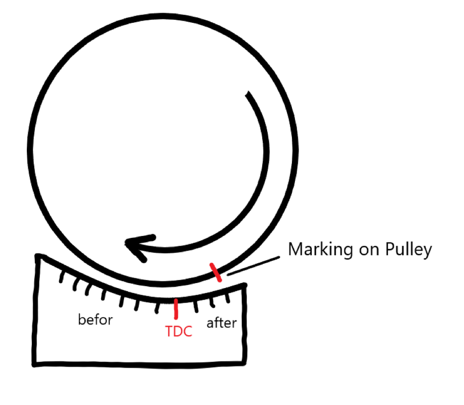

I spent hours thinking about the markings for the ignition timing.
maybe someone can help wrap my head aeound this.
The markings look like this from the front of the car looking backwards:
isnt that switched up befor/after when the engine is running clockwise? but the reading where correct towards "befor". I am really confused and got a bit nervous that i might have turned the engine in the wrong direcrion while doing the pressure loss test.

forget the last question i had a brain fart from being upside down under the car. befor and after are switched and therefore correct.
i have adjusted the timing and it runs like a different engine. definatly more power an way smoother while driving and accellerating. Sounds and feels way better.
slightly rough idle and hard cold start is still there but i think i can live with that for now. I will rebuild the aav next winter, now i want to drive
