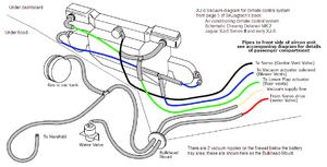

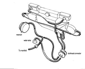

Good morning, hope someone can point me in the direction of a line diagram for my XJ6C heater vacuum piping. The tubing connectors have perished and dropped off. I have replaced a most and tested the main flaps etc with a small vacuum pump but when operating I am still losing vac somewhere.
A diagram will help, I'm sure, or, I just muddle along testing until I find the problem. Just so awkward to get to everything!

Here is what I have,.. may be what you are looking for.
Attached Thumbnails Heating and Ventilation vacuum diagram-jaguar-climate-control-vacuum.png   Heating and Ventilation vacuum diagram-jag-vac-3.jpg

Alyn:
Thanks from here as well. As clear a diagram that I've ever seen. I saved it for adding to my Jag lore.
