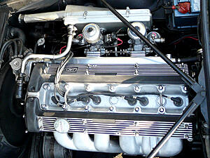

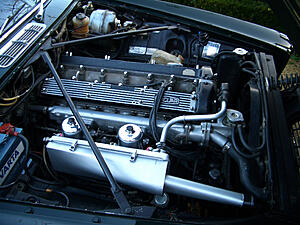

@mekon : your 73 model has a diferent setup than mine for the carbs I think. You probably have the AED and I don't. See a picture of my bay for information
Better pictures of the SU HD8 setup...

When you say "starter" - I now think you mean the starting carburettor device! And you have a manual switch to turn it on/off.
In that case it must be a fuel problem, or your switch is shorting something out.
And also your engine bay looks brilliant. Not many Jaguar cars of this vintage have clean engines.
