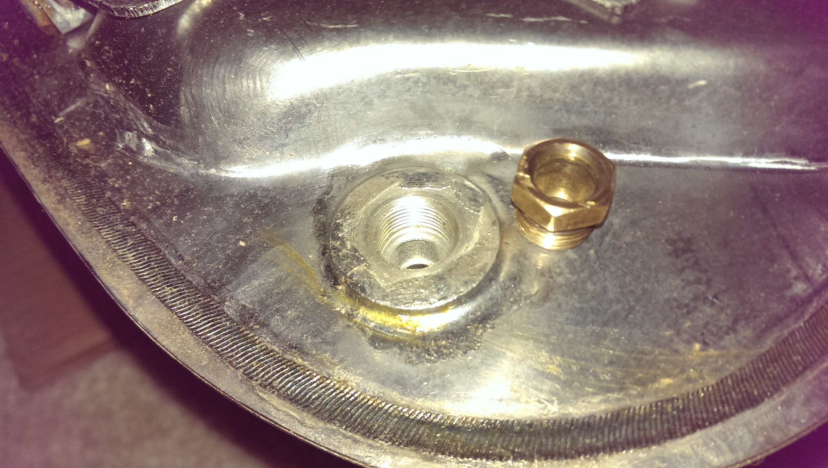

Hi All!
I posted this thread a while ago and since then I have found aftermarket tanks for my car. The problem I have now is that the tanks I got have two outputs (one to the fuel pickup and one to a vent) that are different size and thread count than the pipe/fitting my car has. I've been trying to find fittings that will adapt what is in the tank to what I have in the car, but have been having no luck finding size and thread counts that work. The fuel pickup seems to be 1/2" with a 24 thread count. The vent looks like a 7/16" with 24 thread. Does anyone know if there are adapters available? Also, my car did not have the vent output, but I figured I can just plug that one.
The tanks I got are Spectrum JA1E (ecat) and JA1F (ecat), which, according to Spectrum are replacements for a 71 XJ-6 4.2.
Any help would be appreciated!
Cheers,
Cheers,

When I bought my '72 LT/700R it had a new LH gas tank. The fuel injection needed return lines so I bought SII tanks to get the fuel senders in
the same position.
I have the tank for sale on this Forum and others for $100.00 plus shipping and I have a proper shipping box. The RH tank was too rusted to retain...
Give me your Zip code and I will get a shipping quote from So Cal to your home.

I used the fuel senders from the '85 VDP that I scrapped... just a plug in deal and I used the old wire clamps for mounting. This allowed the longer wires to reach the rear of the car and now fuel sender access in through the tail lights... I would suggest that you obtain some wiring from a car scrapper for this purpose and the friction clamps to hold the wires in place. DO NOT FORGET THAT YOU WILL NEED NEW FUEL CAPS FROM A S3... OLD CAPS WILL NOT WORK WITH THE NEW TANKS...MUCH DIFFERENT IN SIZING. Do not fully tighten the tank mounting pieces until the caps are installed... other wise their position may preclude them from closing properly. I had to push them fully to the front of the car for proper cap opening/closing.
Since I am using mine with a V8 and soon to be converted to EZ-EFI 2.0 fuel injection... I had to replace all the fuel lines in the car, add a new six port fuel changeover valve. I ran the new fuel feed line on the left hand side of the spare tire well and then using a 90 degree bulkhead connector - ran a
hard line across the rear of the trunk bulkhead. There I ran proper fuel injection hose to the front of the car.
The new return line was also run with fuel injection hose from EZ-EFI and clamped every foot or so underneath the car and back to the original feed bulk head connector.
I made up a new flared line for the new return line as it comes out of the tank..it does use a very odd fitting - I have a old one sitting on my desk right now and could not find any others around the LA area. David Boger from Everyday XJ sold me a couple of the short pieces of tank tubing so I would have place to start with the correct male fitting plus he provided some very good S3 fuel caps with keys as you will have to replace those as well.... you will probably have to do the same thing and make a short piece of flared fitting and attach a hose and use a bolt to seal off the return portion.
I tried to contact Spectra, but they claimed they had no source of the fittings either! They just sell tanks.. and some related tank stuff. I went to a major foreign car parts supplies and they had nothing of the correct size for the Jaguar tanks.
Tanks are working fine in my car for their intended purpose...just have a bolt in each of the rubber lines held in place with a hose clamp until I do the actual conversion hopefully the first of next year.

Yes, there have been changes after forty plus years... but the S1/S2 type tanks seem to have the same type of fittings..
Are your fuel senders located in the front of the tanks like stock? Then you should be able to use your current fuel caps and senders...
David can help you with the fittings for the return lines and just put a piece of quality hose onto the end and plug with a bolt and clamp.
Bry5on,
You can read about my exploits here (Jaguar XJ6 V8: Welcome to the 2013/2014 Project Car Season!), but the long and short of it is that I got a plug from Barret Motors for the fuel return side. The other fitting is a 9/16 x 24 UNEF fitting which was extremely hard to source. I finally found one from a marine hydraulics supplier that had the brass nuts and the pressure fittings that fit. I used copper tubing to go from the tank to the trunk. Unfortunately, I don't have the name of the company I bought them from, but if you Google the fitting size, you will see that there are several out there.
Good luck!
Good luck!
