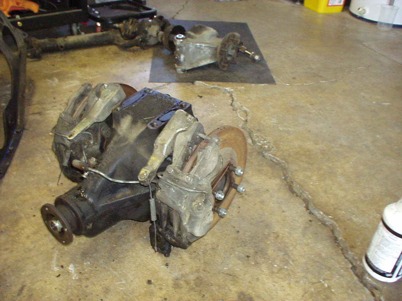

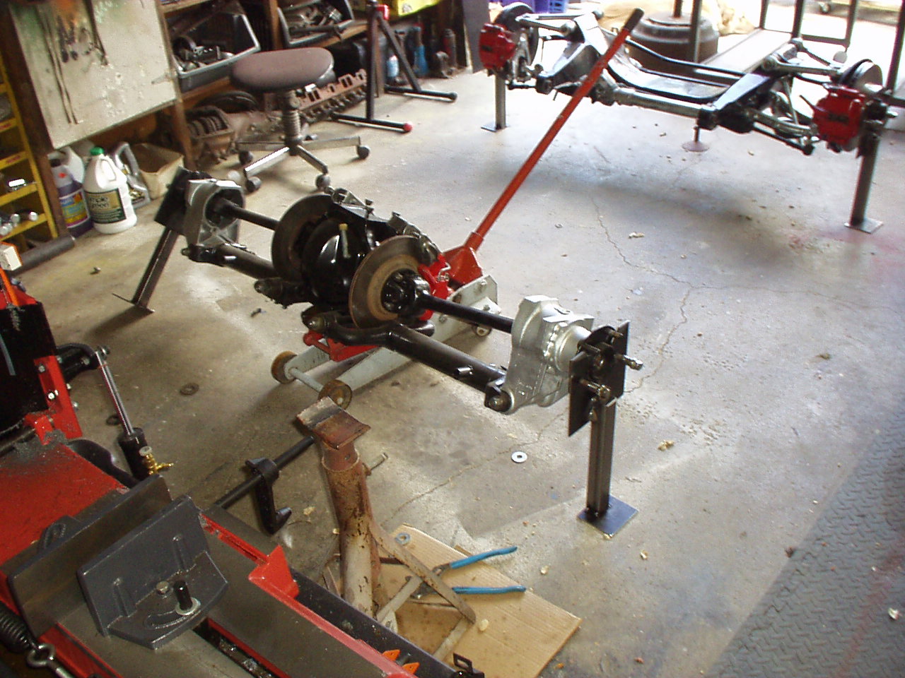

The rear end was bought from a junk yard and I think it came from an XJ12. It is a Dana 44. I went through it, replaced the bearings and seals.
[ATTACH]Here's my nonJag-jag-dana-rear-jig.jpgHere's my nonJag-jag-dana-raw-1.jpg

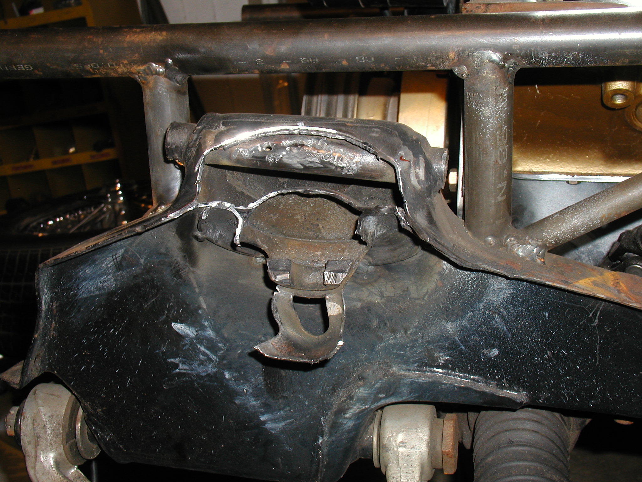

Looks like you've retained the original wishbones on the front cross member but entirely modified the spring?
I can't quite make it out from the angle on the LH picture.
Old Nov 17, 2014 | 01:32 PM
chaparral2f's Avatar
Joined: Nov 2014
Posts: 14
Likes: 9
From: Southern Oregon
Default Re:My non Jag
Yes, I retained the control arms, and built a shock mount that bolted on in place of the spring on the bottom. Next I modified the cross member for clearance.
Here's my nonJag-spring-tower-cut-1.jpg Here's my nonJag-spring-tower-finished-top-1.jpg
Then fabricated the upper mounts for the coilovers.
Here's my nonJag-top-coilover-mount-lt-2.jpg Here's my nonJag-engine-tube-chassis1a-.jpeg
Finally, to add to the stiffnes the engine was mounted on engine plates.
