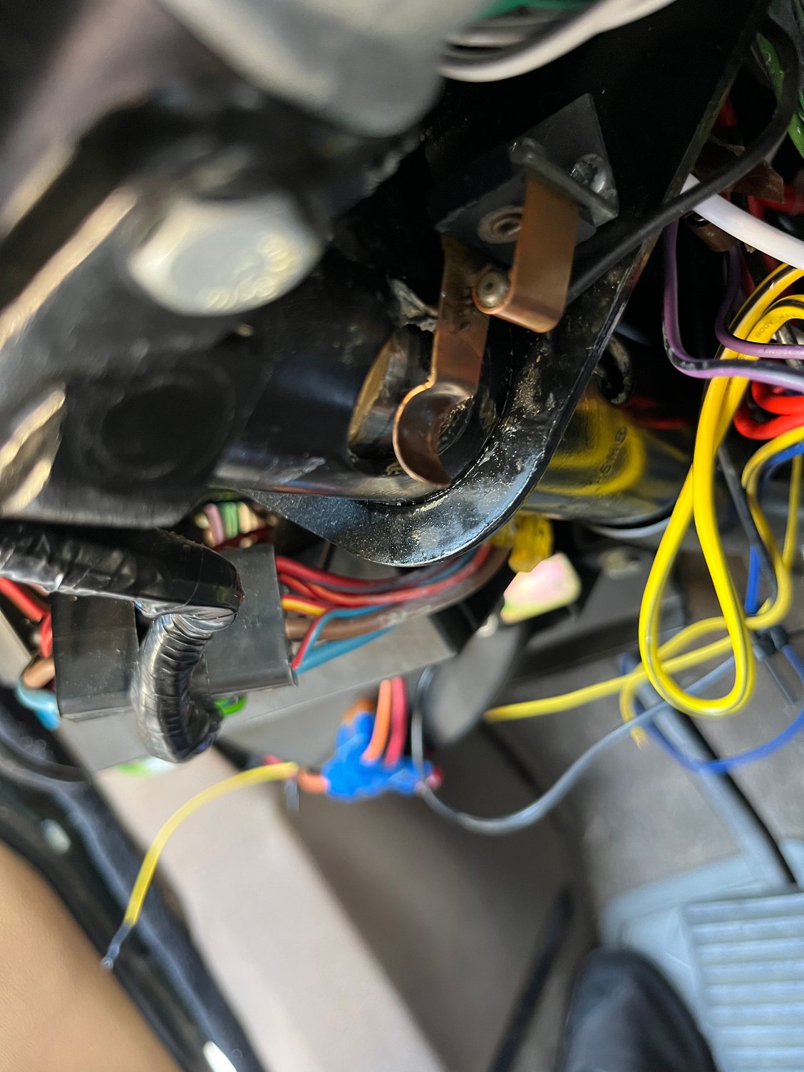

Originally Posted by Doug
If you remove the driver's side under-dash trim panel and look at the side of the steering column you see two brass "fingers". These connect to ground contacts inside the column. Make sure the connects are clean and tight and fingers are not corroded
DD
Are you talking about these “fingers”? They were really gunked up. Haven’t gotten any sound yet but will mess around with them
a bit more
Edit: ok, when I manually press both of them against the steering column,
the horn sounds. However, it seems to do this independent of the horn button. How is this supposed to work in terms of finger position?

More digging - here’s a thread from jag lovers that gets into details:
https://forums.jag-lovers.com/t/xj-s...tact/344208/13
it appears that the plastic sleeve around the steering column, which may support a shielded spring, is broken, so I have continuity between the upper and lower finger contacts, which should only happen when the horn button is pressed. Sounds like the only fix is a new steering column.

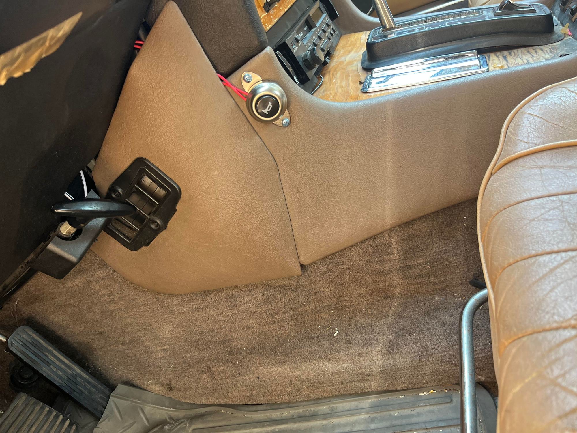

I’m leaning towards rigging up some kind of aftermarket horn switch to give ground to
the purple/black, and calling it a day.
Is the steering column ground necessary for anything other than the horn?
Old Sep 4, 2023 | 12:48 PM
benji808's Avatar
Joined: Aug 2018
Posts: 240
Likes: 98
From: Des Moines, Iowa
Simple solution for now. One wire tied into the purple/black, and the other tied into ground.
