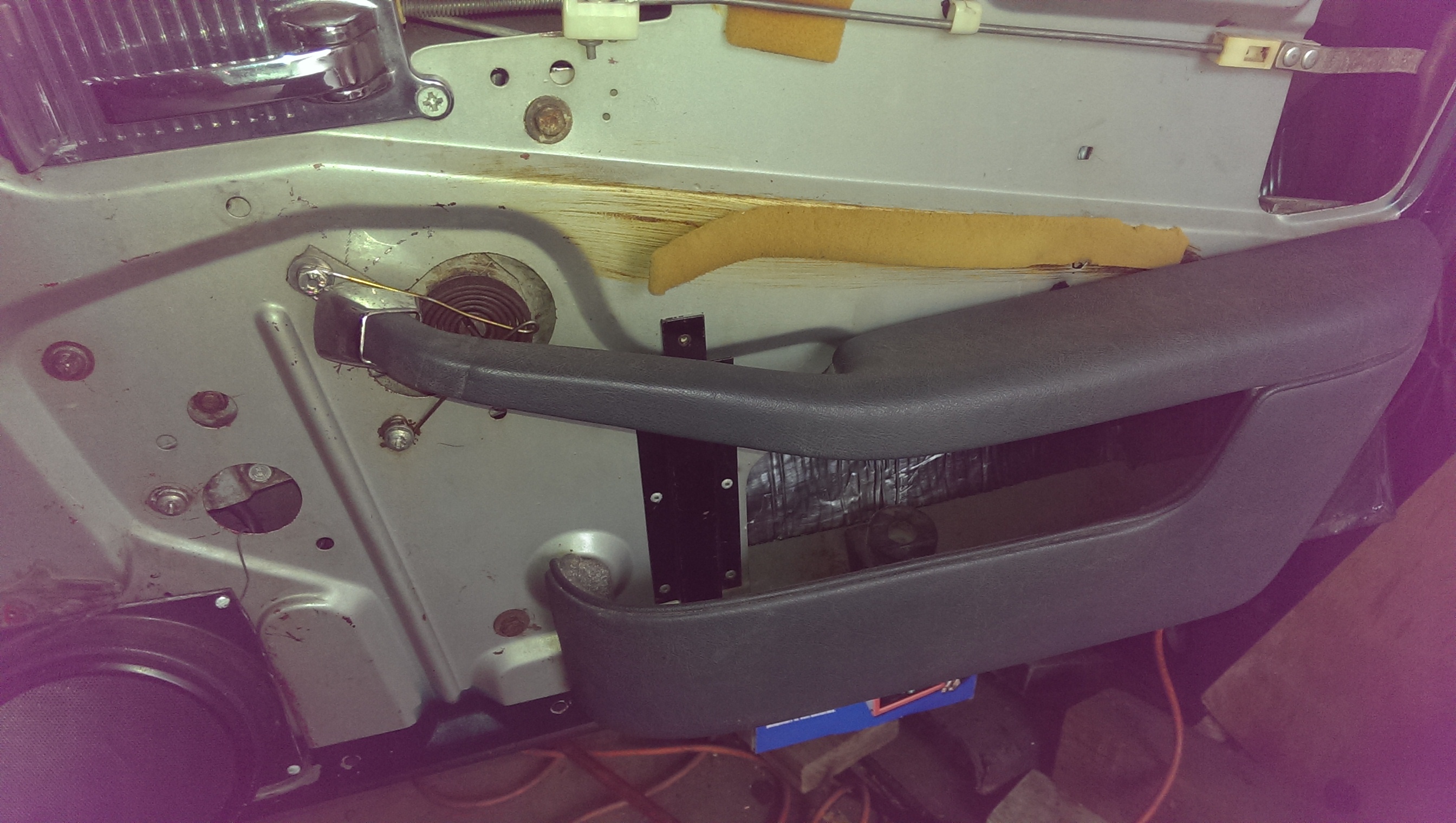

Arm rests in the front doors will need mounting pieces made up... but they will fit fine. I have them in my current S1.
