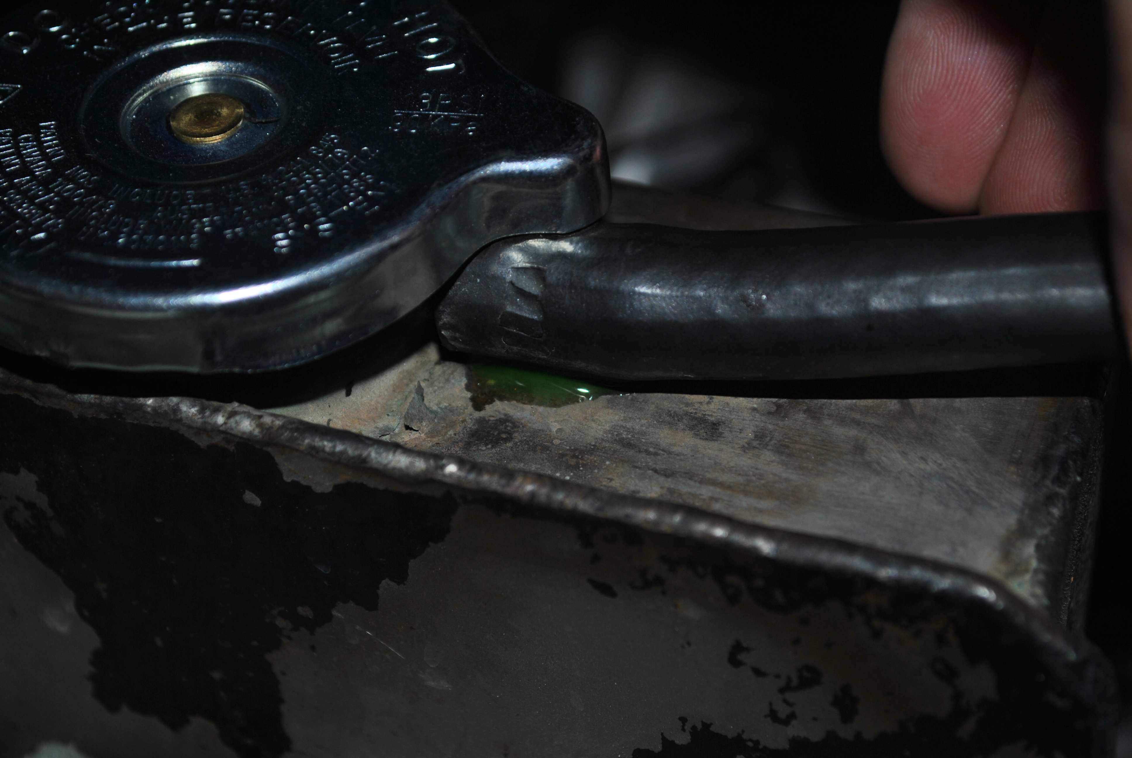

Hi Everyone,
One thing that has not affected me since driving my 85 VDP in March is coolant loss.
Until a couple of days ago.
When I first purchased the Jag, I checked all coolant hoses as a matter of course. I even replaced one two weeks ago because a bubble of dried coolant on the outside wall of one marked the spot where a crack was developing.
Heck, on first inspection of the car, I had even checked the rubber seals of the radiator cap and was more worried about the correct pressure cap than the very small tear in the outer cap seal.
I am a frustrated airline pilot obviously, as I do a walk around the car every morning and check fluid levels every day.

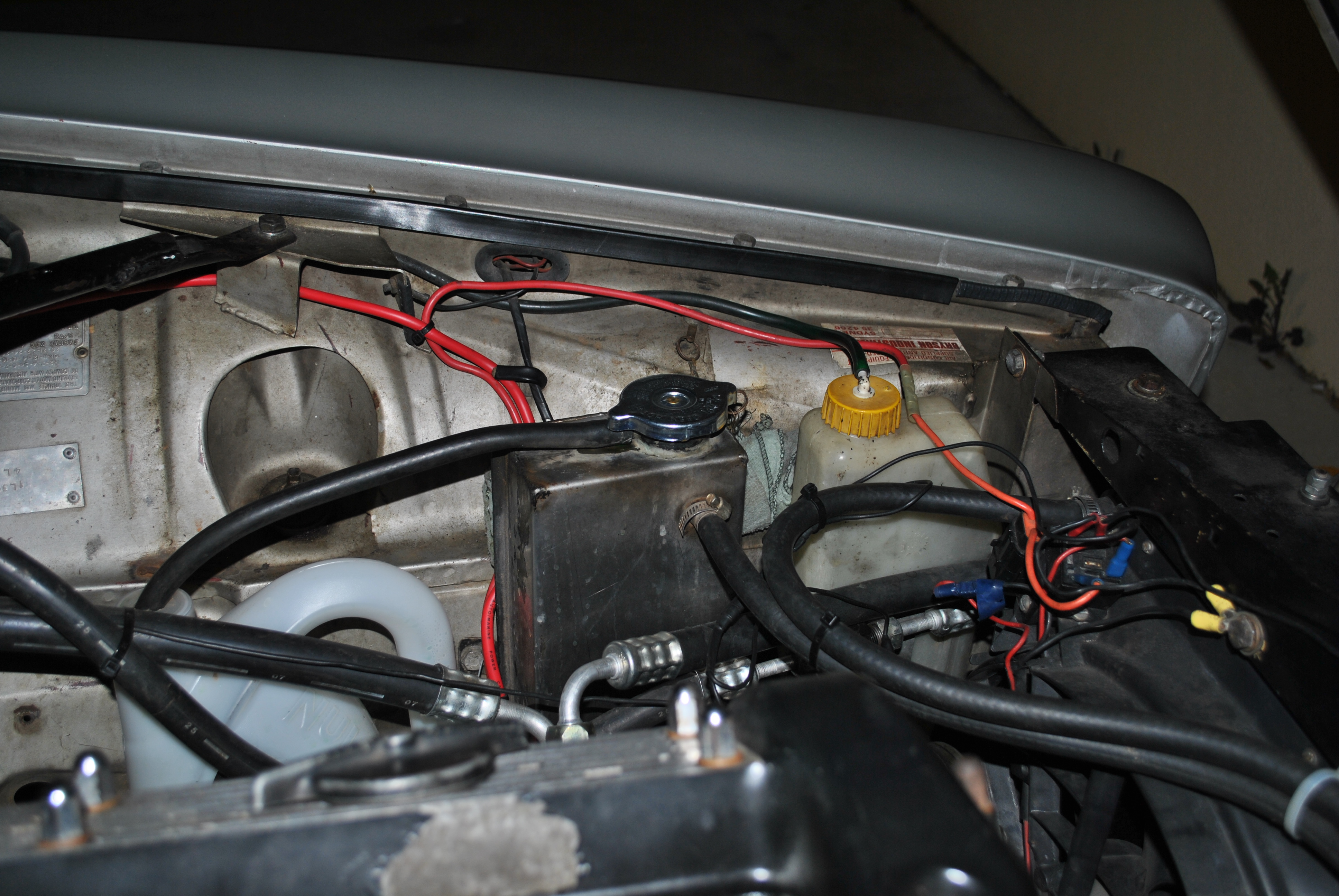

Two days ago, shock horror, the expansion tank was well below low tide. I topped up, checked all the hose clamps with a flat headed screwdriver but didn't check the seals on the radiator cap.
As I couldn't find loose clamps, dried coolant residue, or oil / water mixed anywhere, I was at a loss as to where the coolant loss was.
The water temp gauge never rose to an alarming degree, so failed head gasket was luckily ruled out as well.
As there was no obvious puddle of water under the car anytime I came back to it, I was starting to wonder if the heater matrix was the suspect.
Yesterday, during morning routine, the expansion tank was again well below a comfortable level.
I topped up and drove for a while, stopped on a flat clean area of concrete and watched for while.

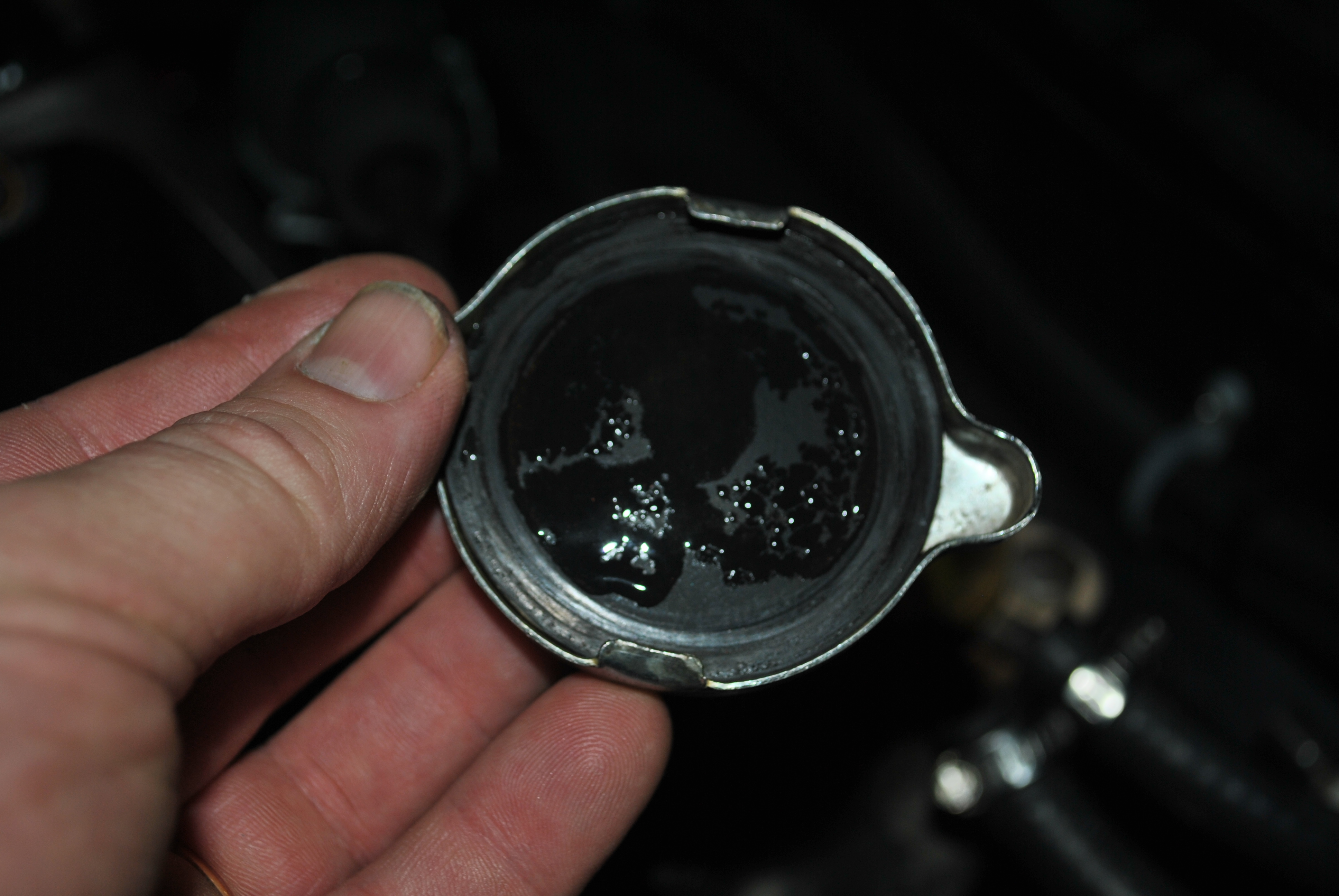

Then it happened. After 5 or 6 minutes, coolant started to seep from the overflow tube. Not enough to draw attention or a big puddle, but enough over seven or eight stops over a couple of hours to significantly drop the coolant level.
I let the engine cool down and removed the radiator cap, this time taking note of the caps' seals.
Needless to say, the small tear from a couple of months ago had worked its' way across most of the seal and another hole had appeared on the other side (or I hadn't noticed it?).
Luckily I had a spare cap in the toolbox, so fitted it, topped up and continued.
This morning, no coolant leak.
It just goes to show how vigilant we need to be as it can sometimes be the smallest things.
When was the last time you checked the seals on your radiator / expansion tank cap??
Cheers and happy motoring,
Nigel

The other cap which is the one we have been referring to is a pressure cap, it is on the expansion tank located on the left inner gaurd,yours may look a bit different to mine as your car is newer. 13 PSI, Repco part No.RC50-13, $10.
How a Radiator Cap causes fluid loss-dsc_3919.jpgHow a Radiator Cap causes fluid loss-dsc_3914.jpg
