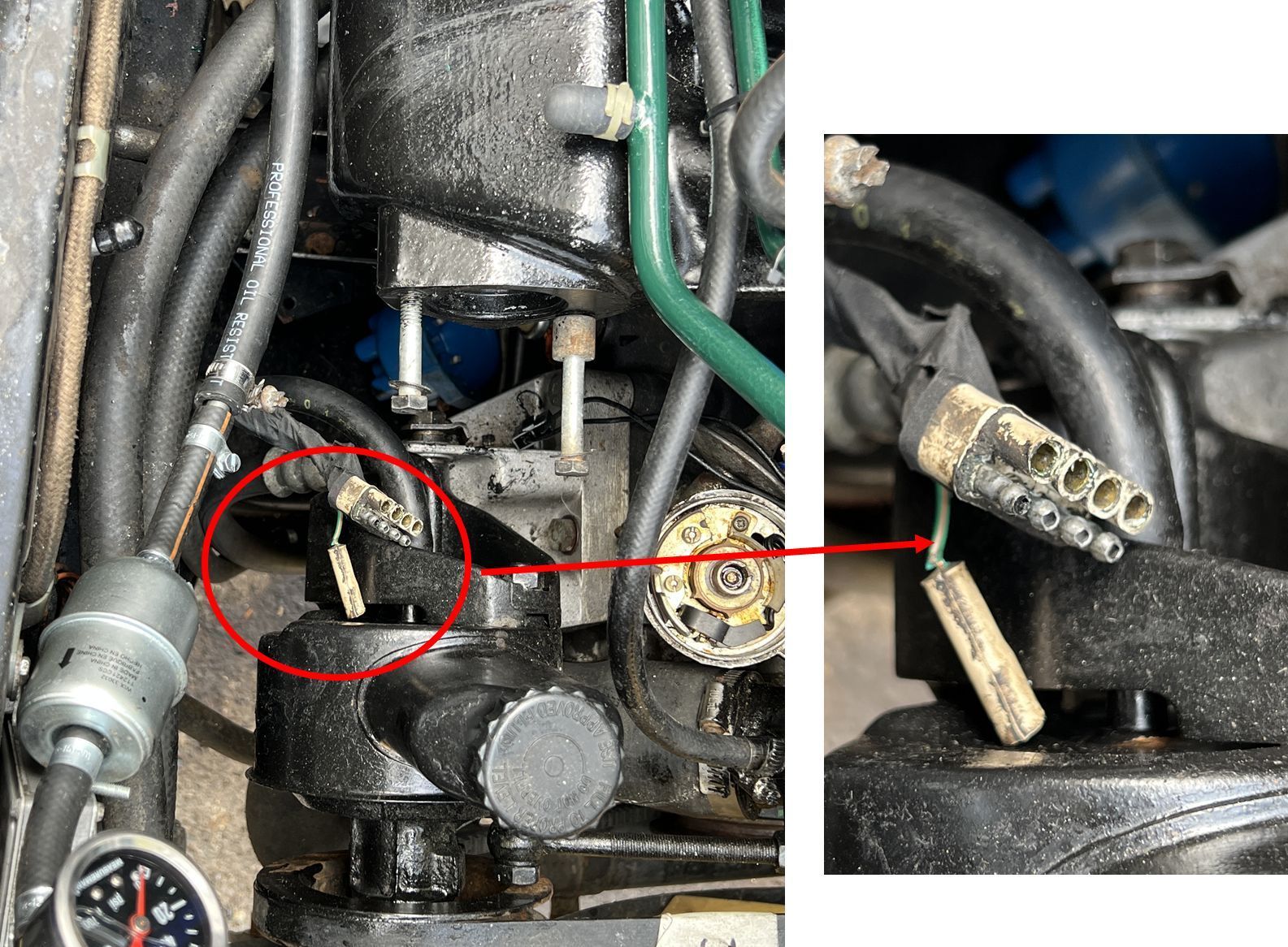

A question for the electrical experts. I've been up and down the schematics but have not been able to identify a wire. Photo attached, it is the single connection wire Green-Brown Strip next to the multiple-connector. Should have done a better job marking wires prior to disassembly

I can not make it out from the pictures.
I can suggest that you obtasin the Jaguar Schematic S57. The color code may identify the wre.
Are you far nough along to just try various functions and see what does not work. lights, horn, wipers, ignton etc.r

Hi, think you will find its the feed for the AC compressor clutch?

it sure was, thank you for the direction.
