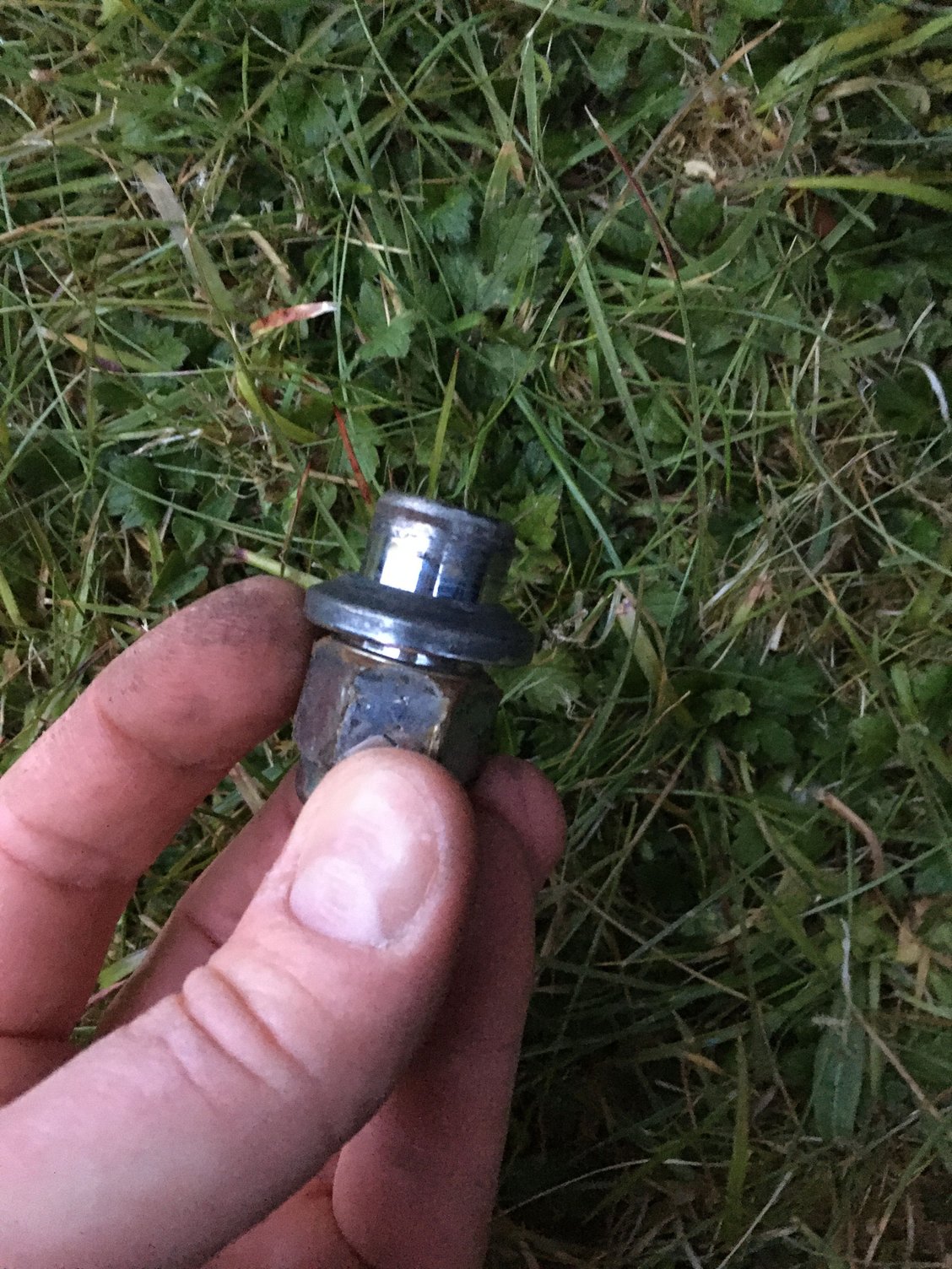

ive left it with him for now, but he thought possibly my bolts are non standard, so here’s a picture - can anyone confirm?
Has anyone else had that? Wheels are standard pepperpots.
bit worrying...!!!
thanks a lot, Al

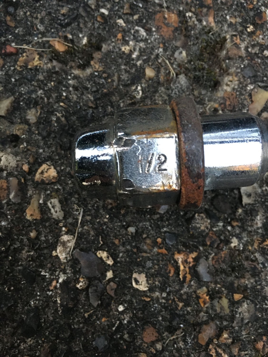

Originally Posted by awg294
Thanks do you know if the washers are meant to be flat or shouldered?
They are supposed to be flat, as I remember, and thise nuts do not look correct to me, partly because the Jaguar nuts are NOT marked as "1/2 inch".

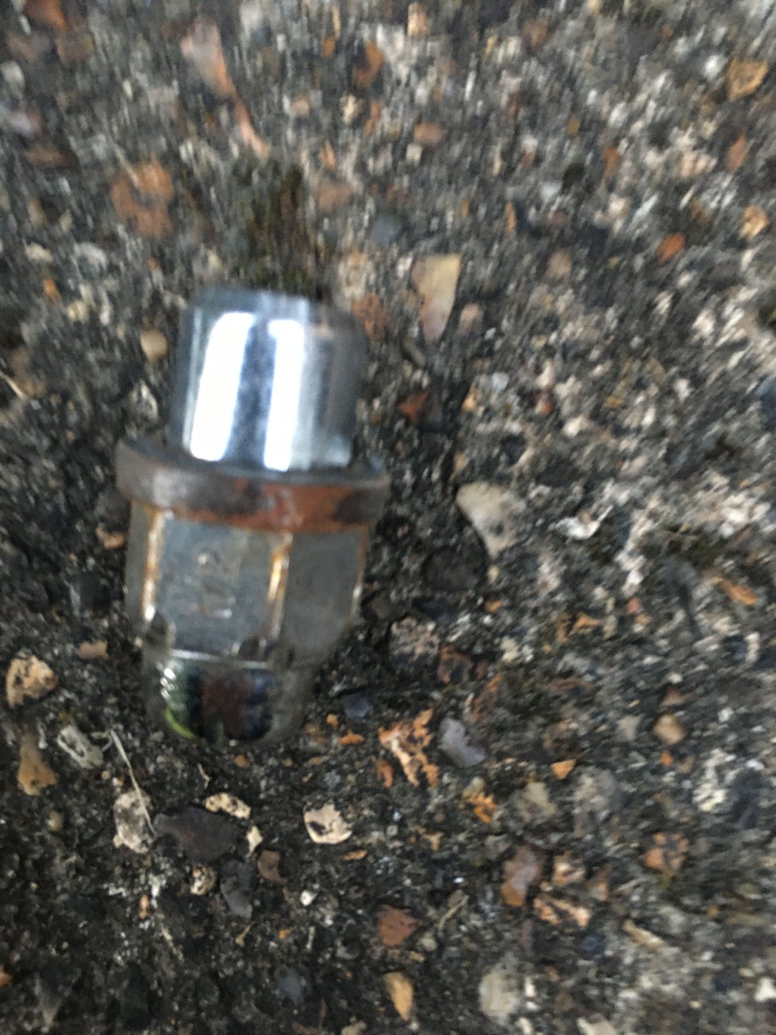

As mentioned you do not have original Jaguar lugnuts.
Below are a couple pics of nuts typically seen on a Series III XJ6 with Kent wheels
The first is the early style which is a solid nut, chrome or some sort of shiny metal, part number CAC4549 (this part number is subject to some catalog discrepancies).
The second pic is the later style which is an open nut fitted with a stamped stainless steel bright cap part number CBC1262
Both have an integral washer fitted
In the case of your existing lugnuts I suspect (again, as someone already mentioned) that the shank portion is too long and it bottoms against the hub before the wheel is tightly clamped down.
Or.....
The diameter of the shank is too small, making for a loose fit through the wheel, allowing the wheel to wobble.
Wheel wobble from either cause may have damaged/enlarged/elongated the holes in the wheels
DD

Hi,
Those are definitely aftermarket nuts and the washer flat side should go towards the rim. I just upgraded to a set of the new polished Kent wheels that Moss sells but haven't had time yet to make a post about all the issues with nut and center cap differences ( 12-14 hour work days right now ! ). I know some of the nuts I bought / looked at are smaller diameter and / or longer shank than factory. Either or both could make your rims wobble even when tightened to spec. I don't have a set of pepperpots to measure but I know some of the nuts I checked out could cause similar issues if used on factory Kent rims.
With a wheel off the car, put a nut in the lug hole and see if it has any wobble / play and if it is flush or protruding on the inside.
Either would be bad and both REALLY bad !
The other thing to check is how deep the hole is in the nut, the stud might bottom out in the nut before it can clamp the wheel.
With the wheel off, thread down a lug nut and measure the gap between the washer and the hub face when it bottoms out. Next measure the thickness of the rim at the lug nut holes. If the rim is not at least a 1/16 to 1/8 thicker than the lug nut gap, I would not trust the nuts to hold the rim.

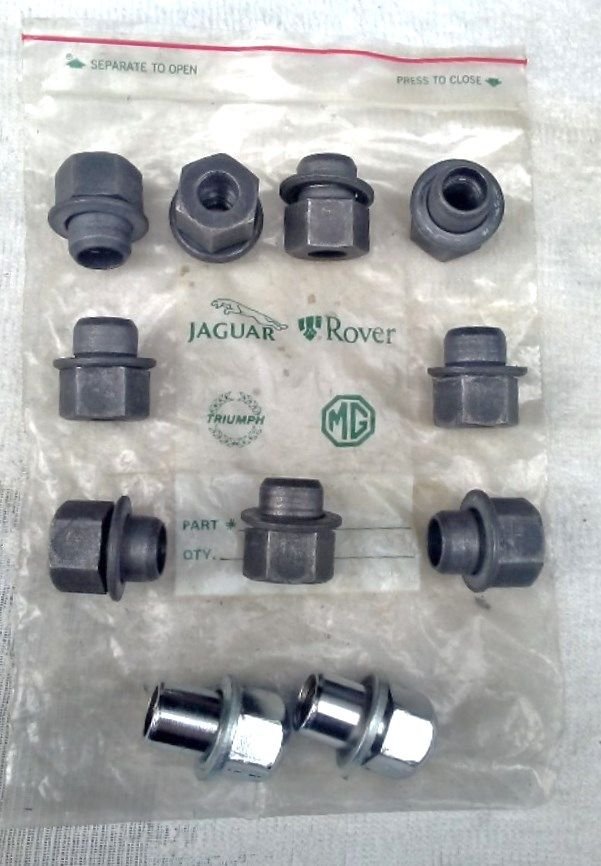

here's 9 of the original lugnuts from my 1984 XJ-6 Kent wheels, Black anonized. Don't remember what happened to the 10th lugnut.
**the two chromed lugnuts are spares for the front Teardrop wheels.

Jose...with respect, the black wheel nuts are not OEM. Jaguar did not use black anodised nuts for the Kent or the Ogle wheels. They were all chromed.

I was thinking the stainless steel caps may have been removed?
