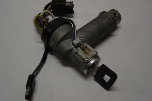

The Ignition Key is larger than the other two:
Other than removing the Ignition Switch and dismantling it to remove the lock barrel, the only other option is brute force.

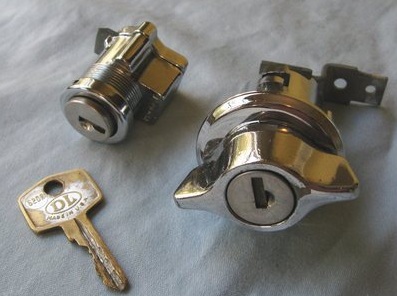

The second square or round headed key fits the Luggage Compartment and the Glove Box:
The Luggage Compartment is the lock on the right in the above picture.
The third six side headed key fits the Fuel Filler Caps:
