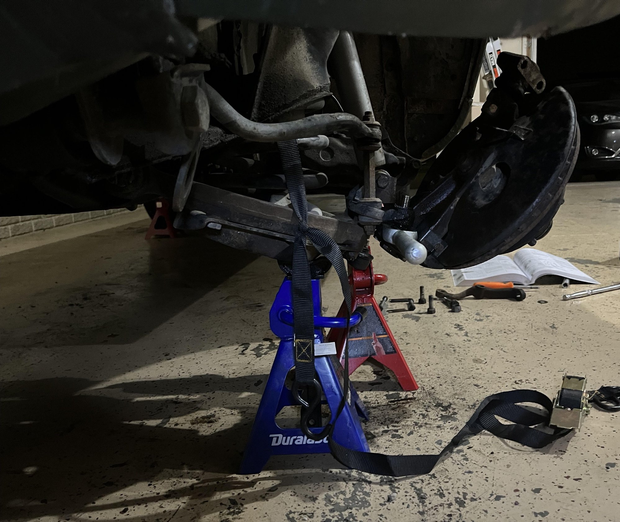

After hemming and hawing, and even scheduling with a shop, I decided to try the ball joints myself. Reading in the shop manual, I realized it spells out a really simple way of securing the springs for a ball joint job: Namely, jack up the car, put jack stands under the spring beds, and lower the car. Simple, easy, and very secure. Got the driver's side done tonight; planning for the passenger side tomorrow or this weekend. Thanks for all the advice and encouragement!
See picture...the strap was a sort of 3rd fail-safe precaution, although I don't know if it would have done anything in case of emergency.

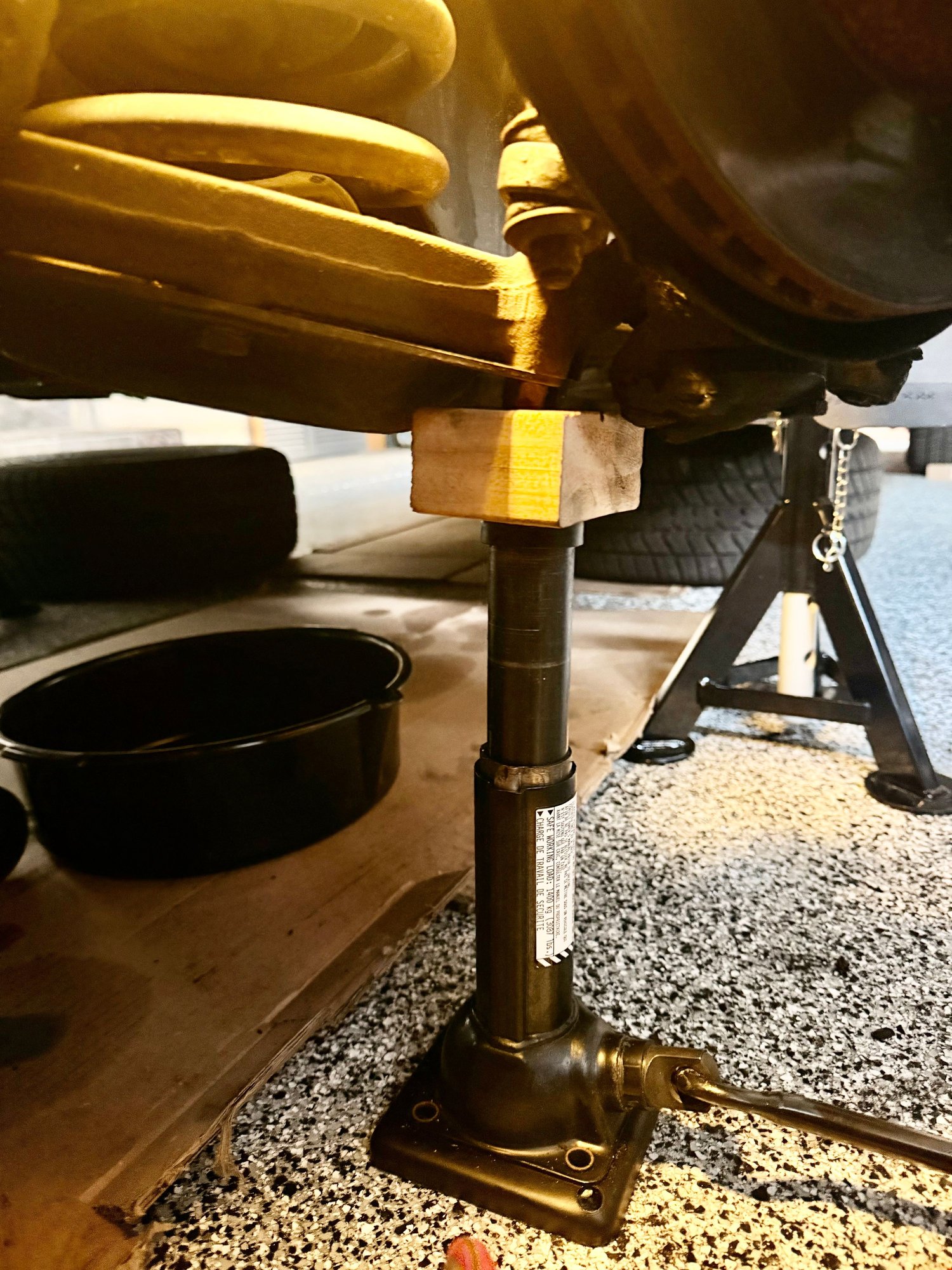

I am getting ready to tackle my upper and lower ball joints this week. Here is my setup for the spring. Is this the right approach?
Thank you
