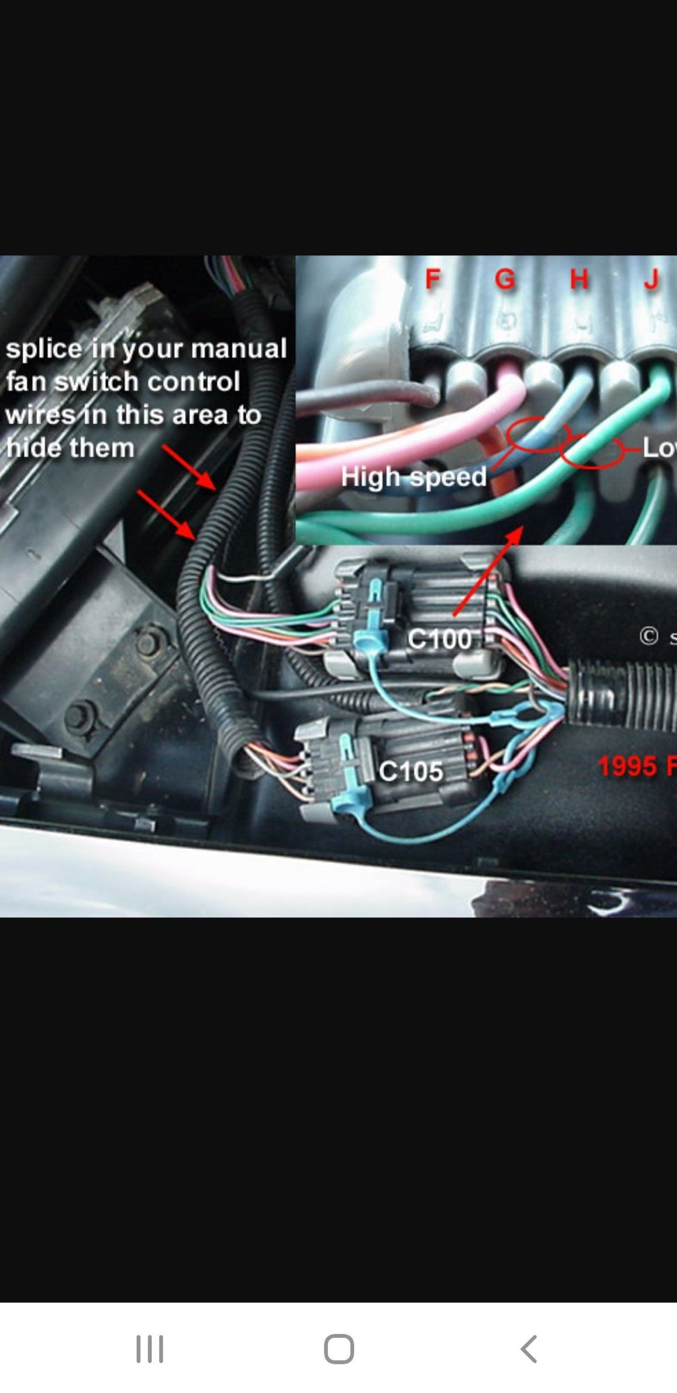

I have added a relay, however not to operate the compressor, mine is spliced into the compressor 12 volt feed, and actually throws a ground over to the relay for the high speed cooling fan, found the diagram for this on shbox.com.
or domyou have a different setup.in mind to control the cooling fan without using the pcm???

I'm going to use a separate fan controller with adjustable on/off temp from Flex-a-lite. It also has the capability of turning on with the A/C, but I haven't considered that yet, the way you set yours up is probably how the instructions will say to wire it. I plan to have a switch in the console to turn the compressor on/off and a couple of other things in the Delanair unit.
Dave
