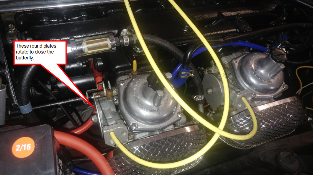

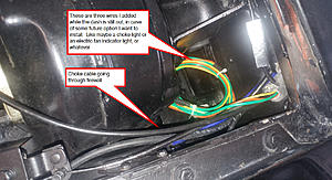

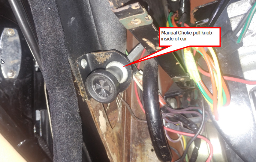

Old May 29, 2018 | 08:25 AM
yachtmanbuttson's Avatar
Joined: Jun 2016
Posts: 1,413
Likes: 627
From: Palm City, Florida
Default Joe Curto Manual Choke Hardware
Works great!
Attached Thumbnails Manual choke for XJ6C 1976 series lll-manual-choke-1.jpg   Manual choke for XJ6C 1976 series lll-manual-choke-2.jpg   Manual choke for XJ6C 1976 series lll-manual-choke-3.jpg   Manual choke for XJ6C 1976 series lll-manual-choke-4.jpg
