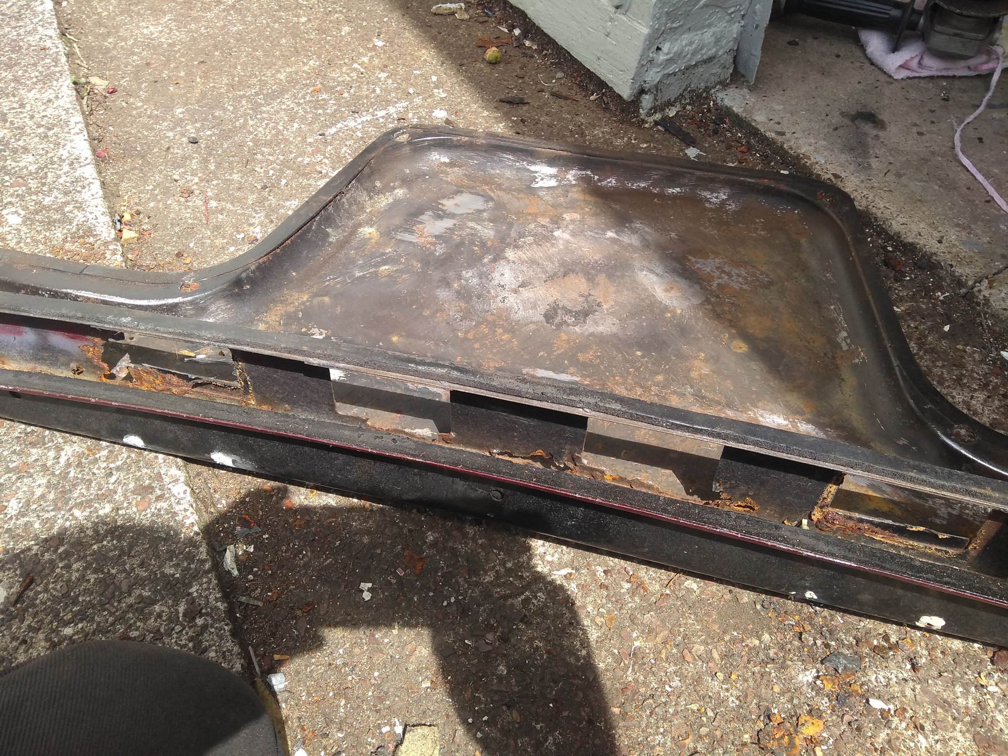

Is the singular purpose of the drip tray beneath the rear window in the boot to balance air pressure in the cabin and boot as to allow for ease of closing/opening etc?
It has the drainage elements only because the method allows the elements limited access and any water that enters must be drained off?
In that sense drainage in only a secondary service contingent on the essential purpose of the tray system?
I have made that sound like a Greek philosophy question but I imagine you understand what I mean.

mine seems to be more rust than metal in places.
needs renovation.

very likely, i say drip tray as everything rusty and wet has dripped into mine.,

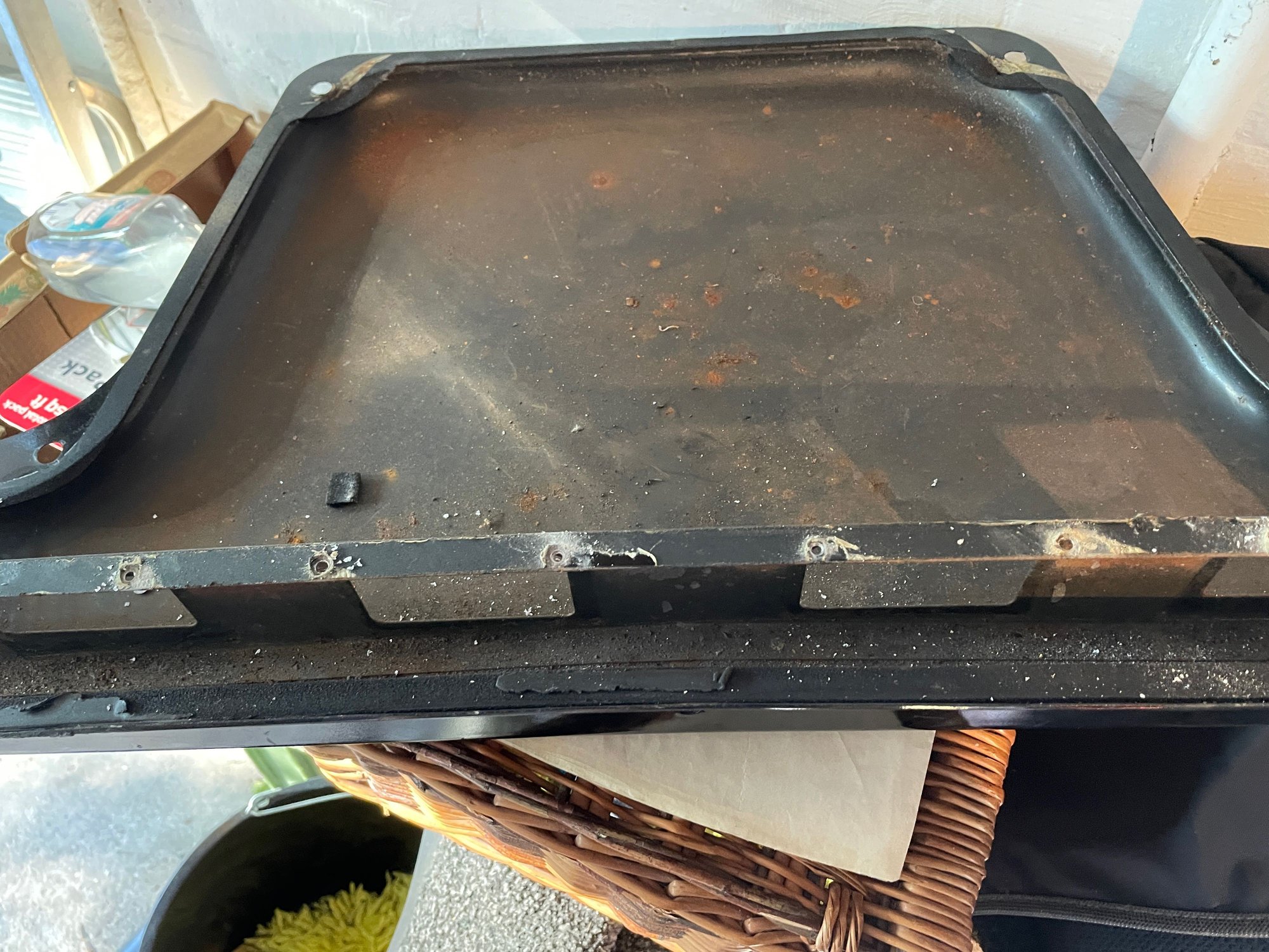

I think you've got it exactly right so far as you've gone in respect of the drainage elements but the main purpose is to ensure extraction of air from the cabin and prevention of fumes from the back of the car coming in - I say that because once I fixed the cowbells on mine, the cabin became more fragrant... You must take the opportunity of having the air extractor out (that's what it's called, by the way) to put new felt on the cowbells.
This is what mine looked like before I cleaned it up and painted it with Hammerite

So which was do the flaps swing? i forgot to record this detail before i pulled all the rusty chunks out, i think i know but I can get almost anything sdrawkcab

towards the rear of the car.

ah so they are just 'hinged' as such by fine fabric dangled from the arching bar above them... ingenious ... for a time...

a metal square is rivetted to a piece of I don't know what in two places, so the metal squares "hang" freely.
The factory glued pieces of headlining fabric over one side of the metal squares to eliminate metal -to-metal contact noise.
but after years, the glued dried and the fabric came off the metal squares causing the famous "cowbell" noise when the doors were slammed shut or when the sunroof was open, or when the car rode over bumps, etc., etc.
I don't know about "cowbells", to me it sounded like the kind of tiny bells you put around the neck of cats. Took me a while to figure where the sound came from. It was a mystery. I kept finding squares of headliner inside the trunk. Still didn't dawn on me. Difficult to SEE unless the trunk lid is open and a second person opens and shuts the doors. It's an air pressure thing.
then came the learning curve, how to get to the metal "vents".
