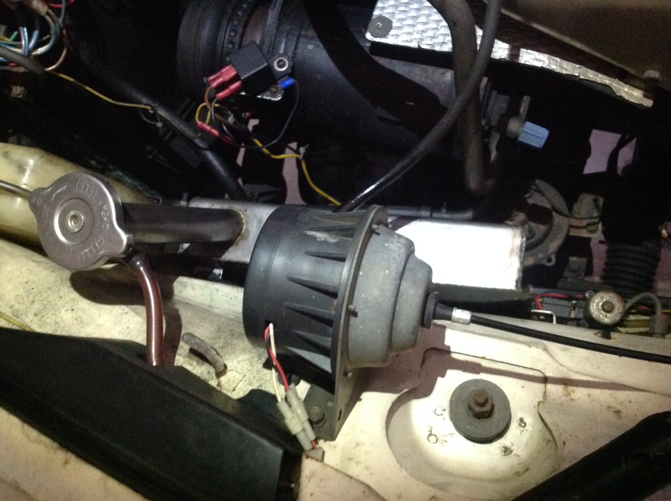

Originally Posted by Daf11e
My series 2 has this stainless steel tank and I believe early series 3 had the same......
Correct.
The plastic tank used on the Series III was part of several cooling system changes circa 1983. Plastic tank, different thermostat housing, different fan clutch, etc.
Earlier Series IIIs used the same stuff as Series II cars
DD
