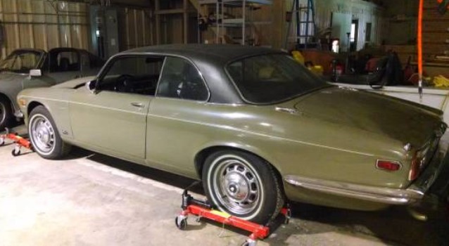

if you have the money, I know of a low mileage, 1975 XJ-C (Coupé) in beautiful, unmolested condition, unrusted, original everything, leather in excellent condition, but it needs engine work. This is the rarest of the rare XJ models. Yes, carburetted 4.2 liter engine, has not been run in a while.
That should be worth buying! Engine work is easy compared to a rusty body.

yes, it is the only Coupé I've ever seen in such preserved condition, even the vinyl top is original.

Very pretty car, definitely one of the best looking cars jaguar ever produced, but then I may be biased. Surprised you haven't snapped it up. Got to be worth doing up even if to sell on.
Mind you once you've got it, you may not want to let it go.

that's just it, if I buy it I won't sell it, I've owned my XJ-6 since 1989, best car I ever had, then the S type since 2004. But a XJ Coupé has always been in my radar.
