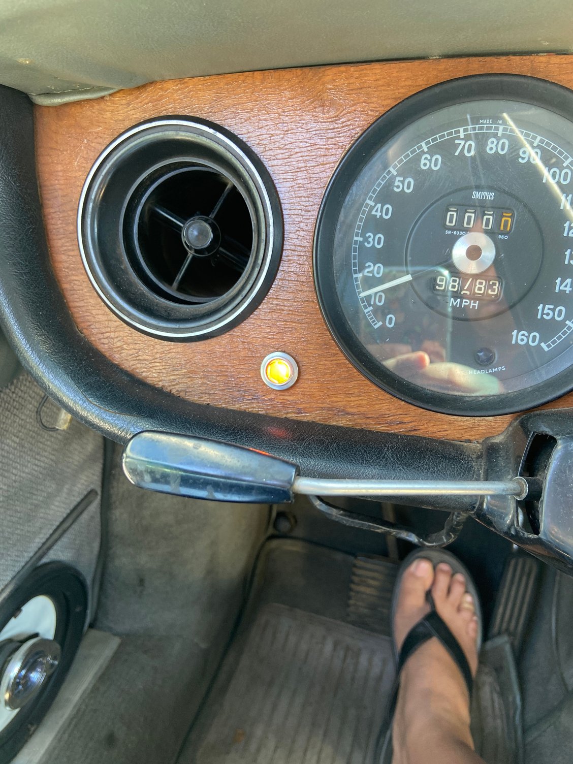

as I wait for the manual to a newly inherited 1973 Jaguar XJ12, I was hoping someone could brief me in a few of the interior options before I start pressing buttons and pulling knobs.
1) There’s an amber light on the driver’s side that has no label but flashes from time to time. Not sure if that’s an indicator of something wrong or something else.
2) Not sure what the Pull Air knob is on the passenger side.

might be an aftermarket alarm system?
the pull/air handle is to open a fresh air Vent located on the driver' and passenger side kick panels.

That light is illuminated by a micro switch on the choke lever. Perhaps check the choke linkage, etc to make sure it engages/disengages properly.

Thank you so very much! I cannot thank you enough. I’ll look into both.
