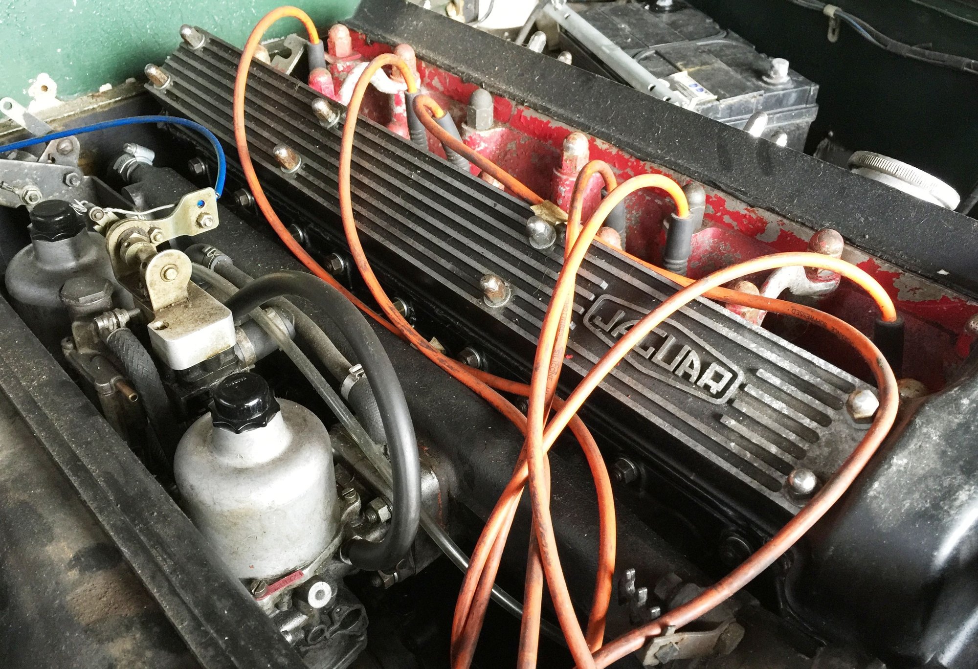

Take a pict of the carbs and post it. Since the car is a bit of a project it may be best to see what we are dealing with.

When the fuel line is taken off the carbs the petrol runs our at a fare (?) rate. When I nip up the tube the the pump ticks away for 5 or 6 seconds?
Old Apr 13, 2020 | 08:55 AM
icsamerica's Avatar
Posts: 2,291
Likes: 1,466
From: New York City
Those are not CD175's and I dont have any experience with those carbs. They appear to be older carbs with a manual choke converted AED. Someone else will have to chime in about those carbs but I suspect a float issue all the same.
