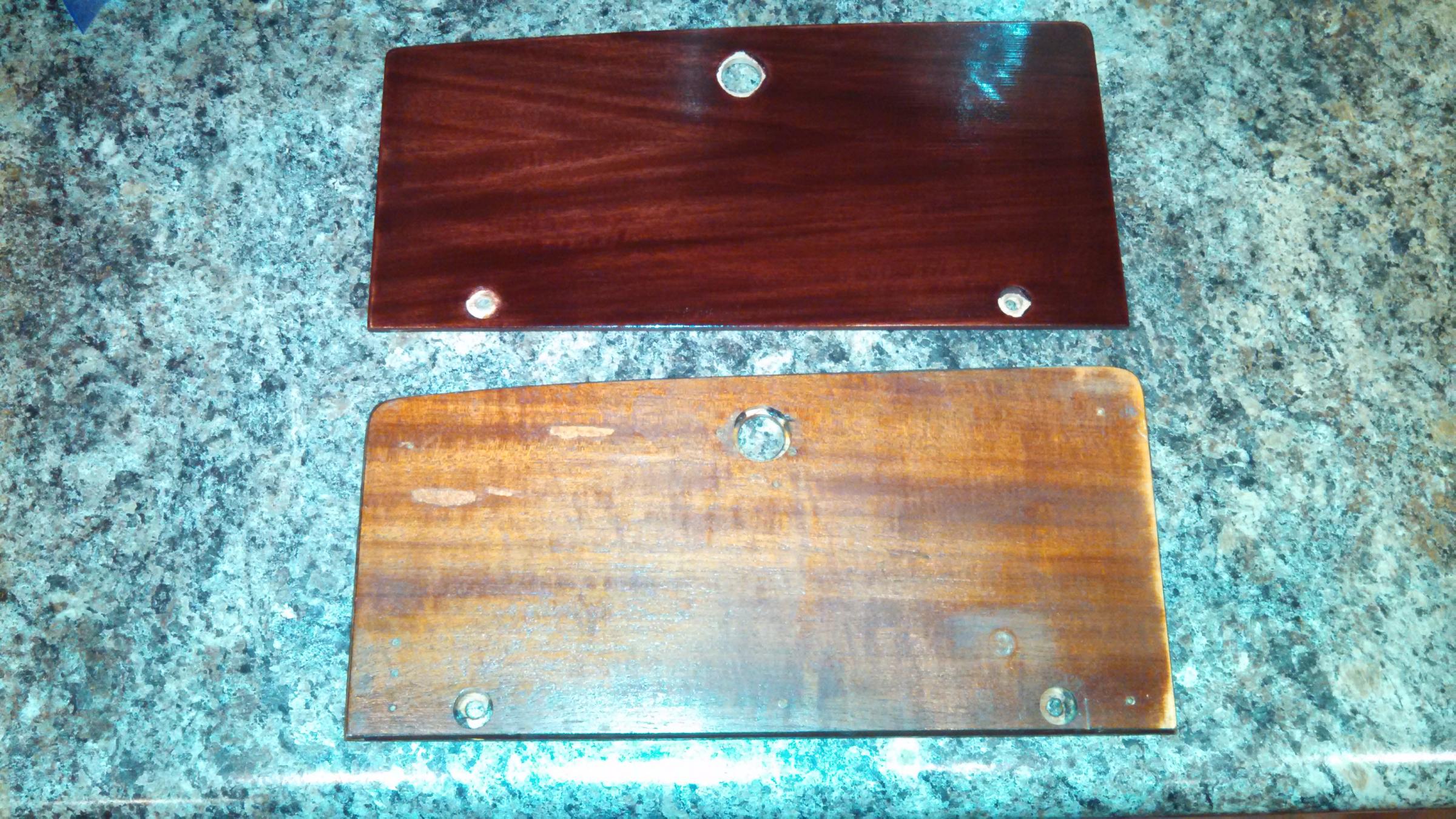

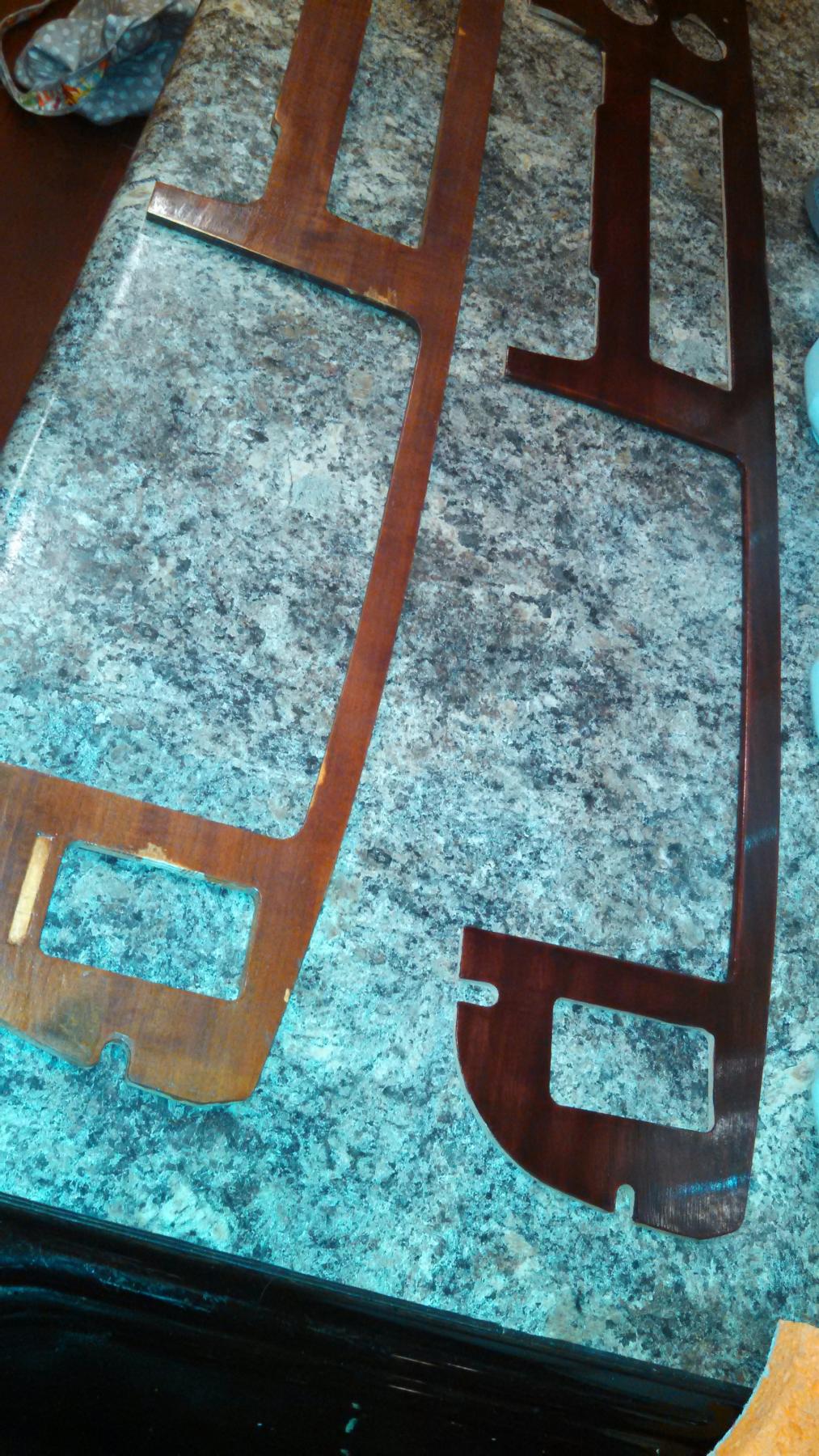

Here's a few pics just so you get an idea. I've got 6 coats of clear and plan to wetsand tomorrow and assemble it all back together.
Attached Thumbnails pics of my XJ6 project "unghetto"-img_20140820_194942_526.jpg   pics of my XJ6 project "unghetto"-img_20140820_200531_203.jpg   pics of my XJ6 project "unghetto"-img_20140820_200544_659.jpg

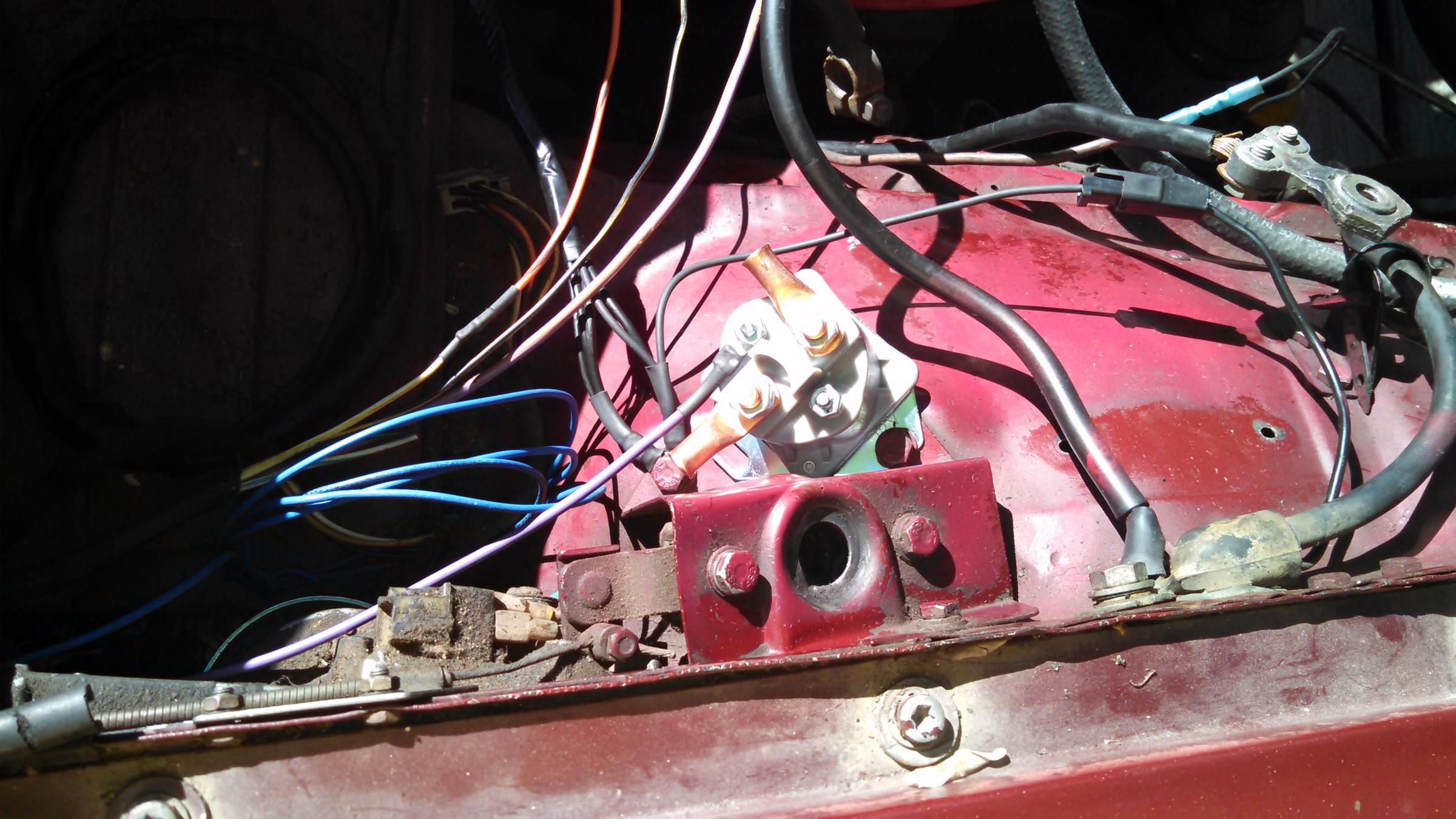

Ok...here's a couple pics of the wreck of a wiring harness which I've begun modifying. As of today I've replaced the stock starter relay with a 70A Hella relay, deleted the diode pack relay, main relay and fuel pump relay. I've isolated a white 14ga wire from the main loom which is an ignition switched source so that will serve as my ignition source for the HEI BAT terminal, as well as the electric choke on the carb and will serve to "excite" the regulator on the 140A alternator which is part of the serpentine setup.
Also located is a white w/yellow stripe 18ga wire which is the starter solenoid trigger. I actually like the relay bank bracket and relay bases in how they mount to it-I wish I had a stockpile of them-I could find a ton of uses for them! Anyway, there's a myriad of white wires and such which I am unsure of their original uses since the PO just hacked them off...anyway....these pics give you an idea of what I have to sort out.
Attached Thumbnails pics of my XJ6 project "unghetto"-img_20140902_174412_515.jpg   pics of my XJ6 project "unghetto"-img_20140902_174429_903.jpg   pics of my XJ6 project "unghetto"-img_20140902_174442_511.jpg

If you can lay your hands on a S57 original jaguar wire diagrams book, it will ID, these odd wires and allow you to decide which to use and which to tape off.
For example, there are a bunch that travel from the engine bay, through a grommet under the battery tray along the console to floor transition in the cabin on their way to the boot. As I recall only two were needed for my purpose, the fuel pump wire and the starter neutral/park interrupt.
Electrickery at it's best!!!

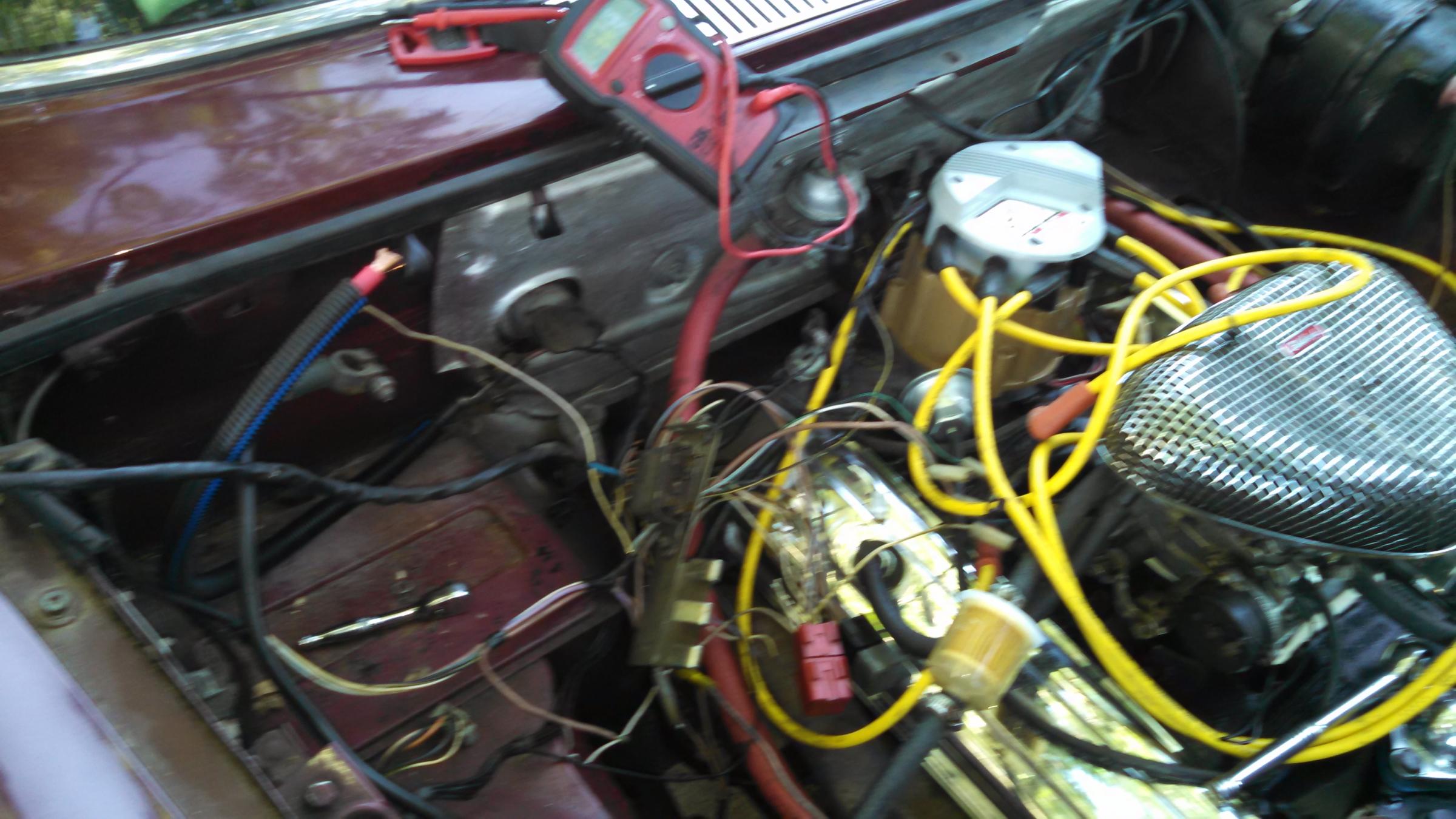

Ok....I got a few pics to show the electrical progress. I am using the stock relay location and bases for my 70A starter relay, IGN coil, low and high beam headlights. I'm adding a Ford solenoid, running the 4ga charge lead for my 140A alternator upgrade and just basically cleaning up the OEM wiring.
After the engine harness is complete, I'm gutting the OEM headlight relay/wiring and building a new relay triggered system with weather-pack connectors/terminals.
Attached Thumbnails pics of my XJ6 project "unghetto"-img_20140907_154215_110.jpg   pics of my XJ6 project "unghetto"-img_20140907_153823_482.jpg   pics of my XJ6 project "unghetto"-img_20140907_153831_859.jpg   pics of my XJ6 project "unghetto"-img_20140907_153838_400.jpg

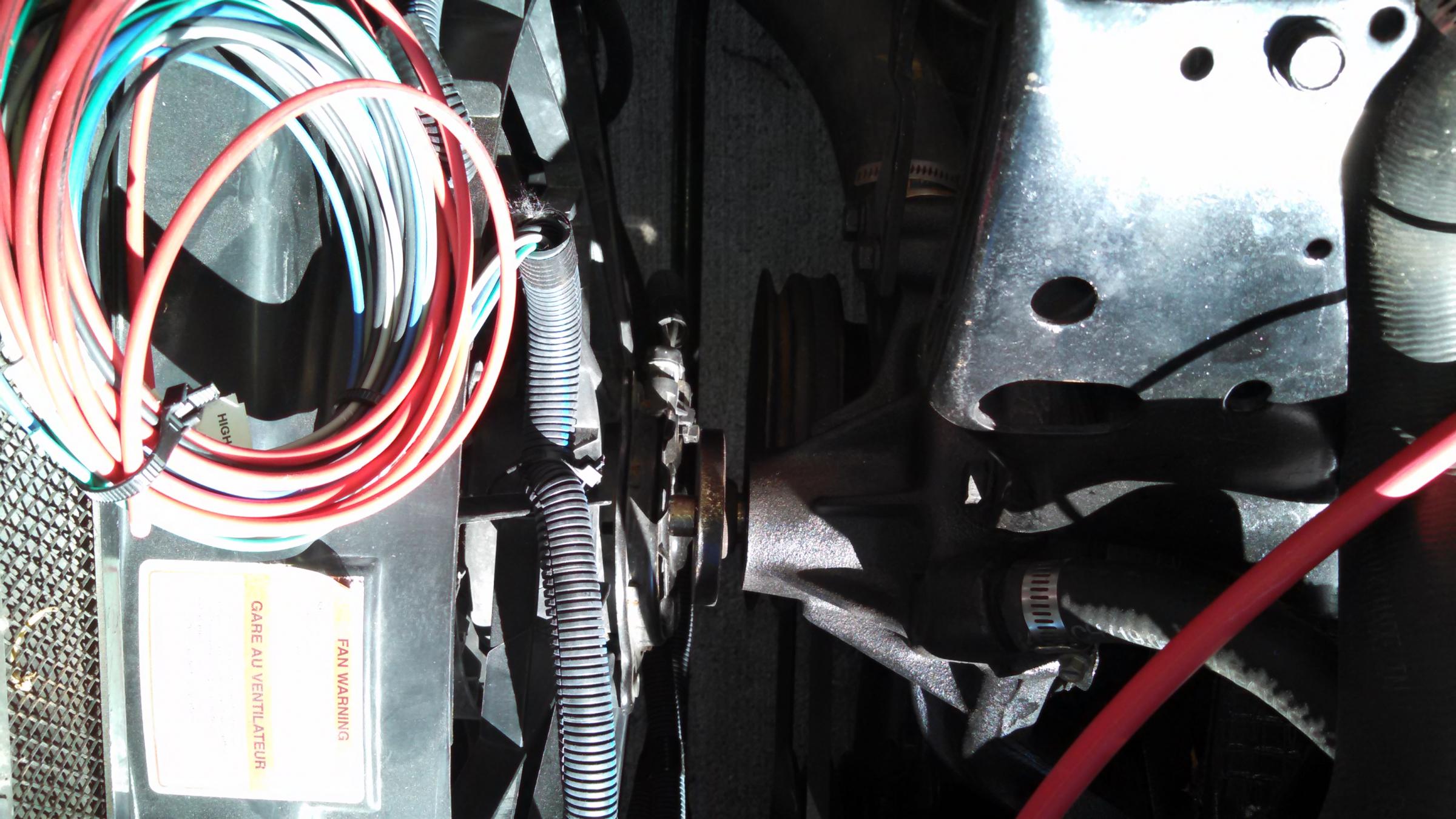

Here's a couple pixs with just the 2-speed fan sitting in place to show the basic look of it. Its a RF24 4200-4400 CFM fan on high speed and I built a control harness for it using a Volvo 2-speed relay epoxied to the side of the fan assembly. I use these types of fan systems a lot and they move a LOT of air! I'll be making aluminum bracket mounts for it at the same time I replace the front lighting harness.
I also found an air cleaner assembly and plastic cold air ducting from a TBI Cadillac in the junkyard which keeps with a stock type look-need to modify it a bit, then sandblast and paint it-pics on that coming soon.
Attached Thumbnails pics of my XJ6 project "unghetto"-img_20140907_154119_973.jpg   pics of my XJ6 project "unghetto"-img_20140907_154145_135.jpg   pics of my XJ6 project "unghetto"-img_20140907_154203_082.jpg
