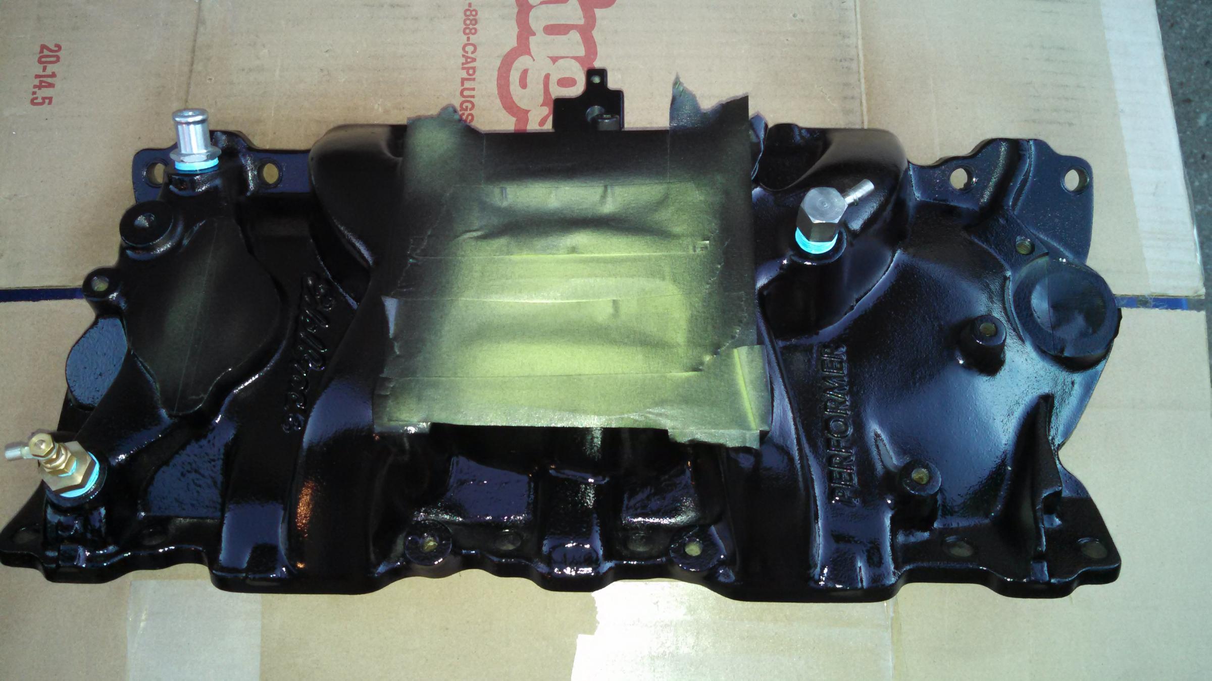

So aside from cleaning up the engine bay, I'm getting the serpentine parts in place, and taking the stock GM aluminum intake off-PO used a 1" adapter spacer to go from quadrajet to EDELBROCK and this is killing my hood clearance for a stock type air cleaner assembly. So, I murdered out a Performer intake and I'll be swapping the GM intake for an Edelbrock so the carb will bolt on without a spacer which should give me the clearance I need. You may notice the adapter brackets I designed for this serpentine setup to be able to bolt on a GM CS144 style 140A alternator.
Attached Thumbnails pics of my XJ6 project "unghetto"-img_20141021_160658_981.jpg   pics of my XJ6 project "unghetto"-img_20141021_182339_239.jpg

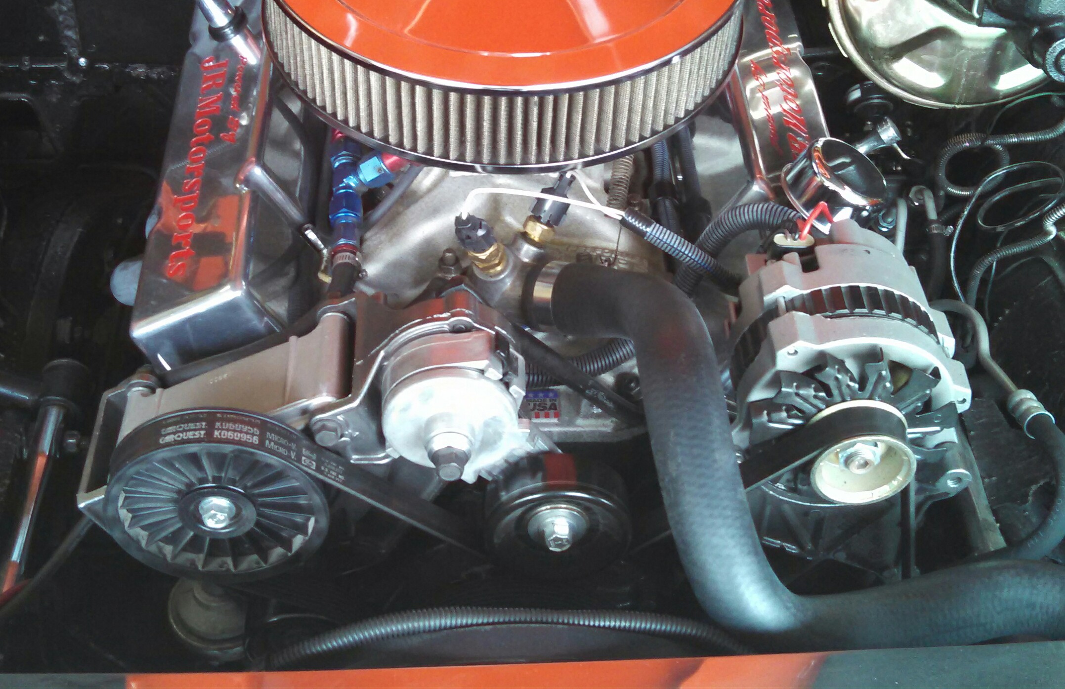

Here's a setup I did recently on a 1969 Camaro for a friend so this should give you an idea where I'm going with this as far as a belt drive.
Attached Thumbnails pics of my XJ6 project "unghetto"-img_20141017_140800_858-1.jpg

Did a little detailing under hood tonight. I added my cooling fan temp switches/t-stat housing on the Performer blacked out intake. Still working on an air cleaner solution. I could notch out the under hood brace to clear the Cadillac TBI350 air cleaner I thought about using, but I would rather not cut into it. I am trying a different, lower base GM air cleaner next to see how well it fits. Hoping to get the radiator fan assembly mocked up next.
Attached Thumbnails pics of my XJ6 project "unghetto"-img_20141026_163256_989.jpg

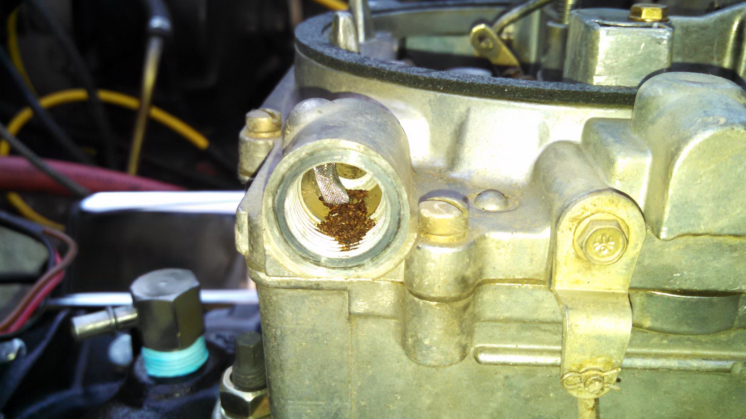

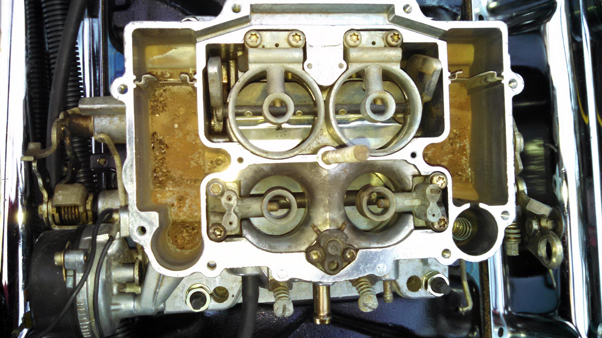

Unfortunately, the carb is not as new as the PO lead my dad to believe-I went to swap the stock hose barb fuel inlet fitting for an inverted flare seat so I could make my own steel fuel line and found crud inside the opening-I pulled the top plate and itbaint any better. So, an overhaul kit and an assortment of jets/metering rods are on the way.
I think I'll have to make my own air cleaner to keep it looking stock but functional. The Caddy air cleaner base is a drop style but the height is still a problem so...., I think I'll cut the base in half, remove an inch then tig weld it back together. As long as it clears (I really don't wanna cut the under hood bracing at all) with the hood shut, I think leaving the tig welds exposed but primed and painted will look killer.
Attached Thumbnails pics of my XJ6 project "unghetto"-img_20141026_163847_284.jpg   pics of my XJ6 project "unghetto"-img_20141026_164931_428.jpg

I have learned with my car, if Anything the PO told us turns out to be absolutely true, or even mostly true, it's an occasion to celebrate!
I have decided that PO stands for Pathological Obfuscation.

LnrB: Vorsicht, PO can also stand for "present owner"!!
Gmachinz:
This might be an exception. except for the crud, it looks quite fresh. My suspicions would go to the fuel fiolter (s) or a steel line along the way, or even the fuel pump, if it is a mechanical type.
But, yeah, that crud is likely in other carb passages as well, messing up things.
Nice work.

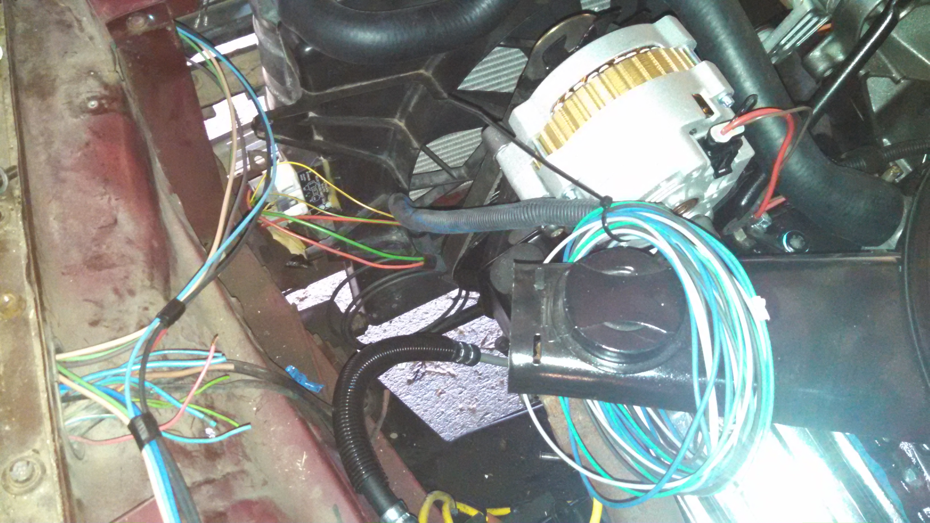

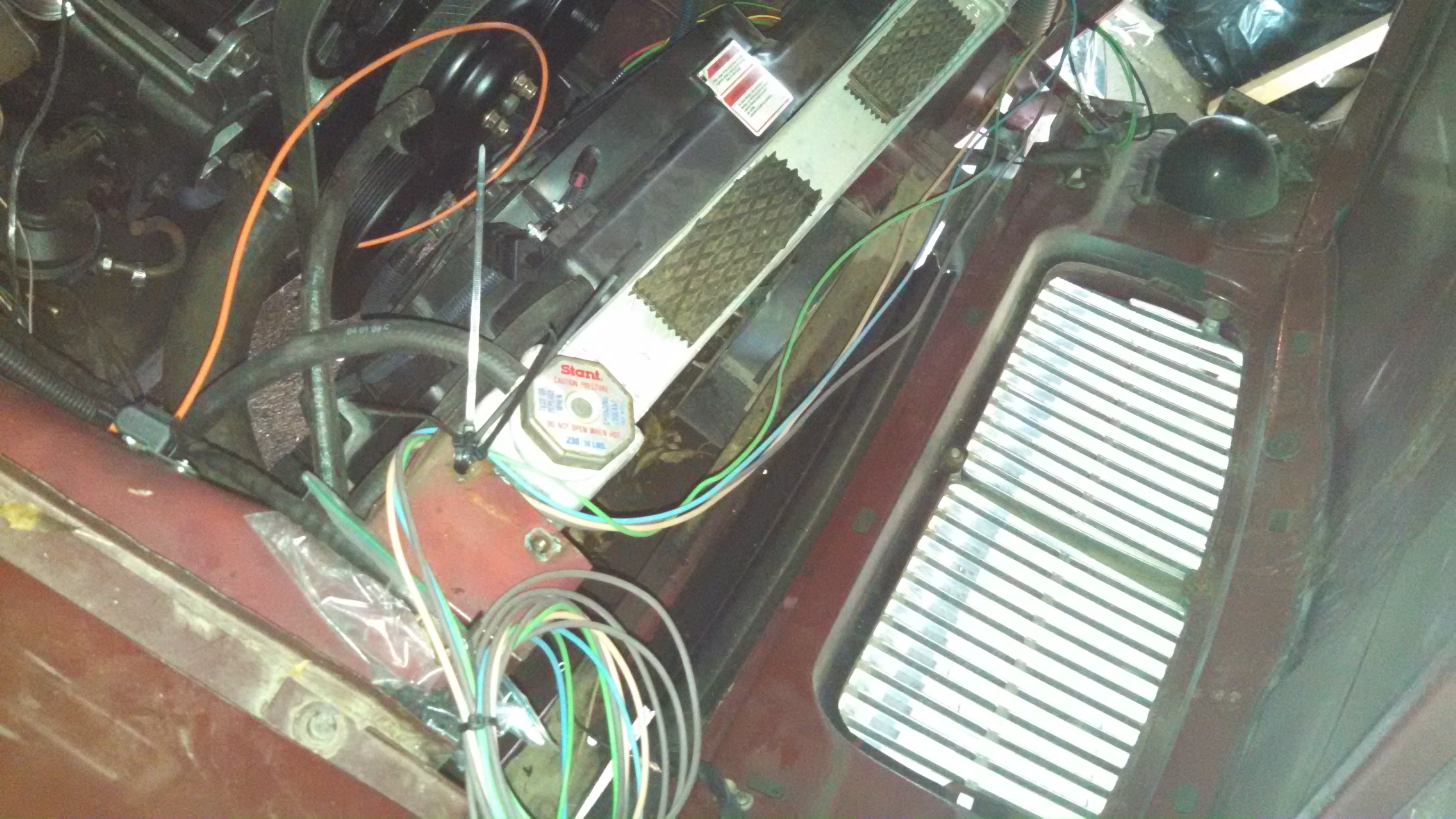

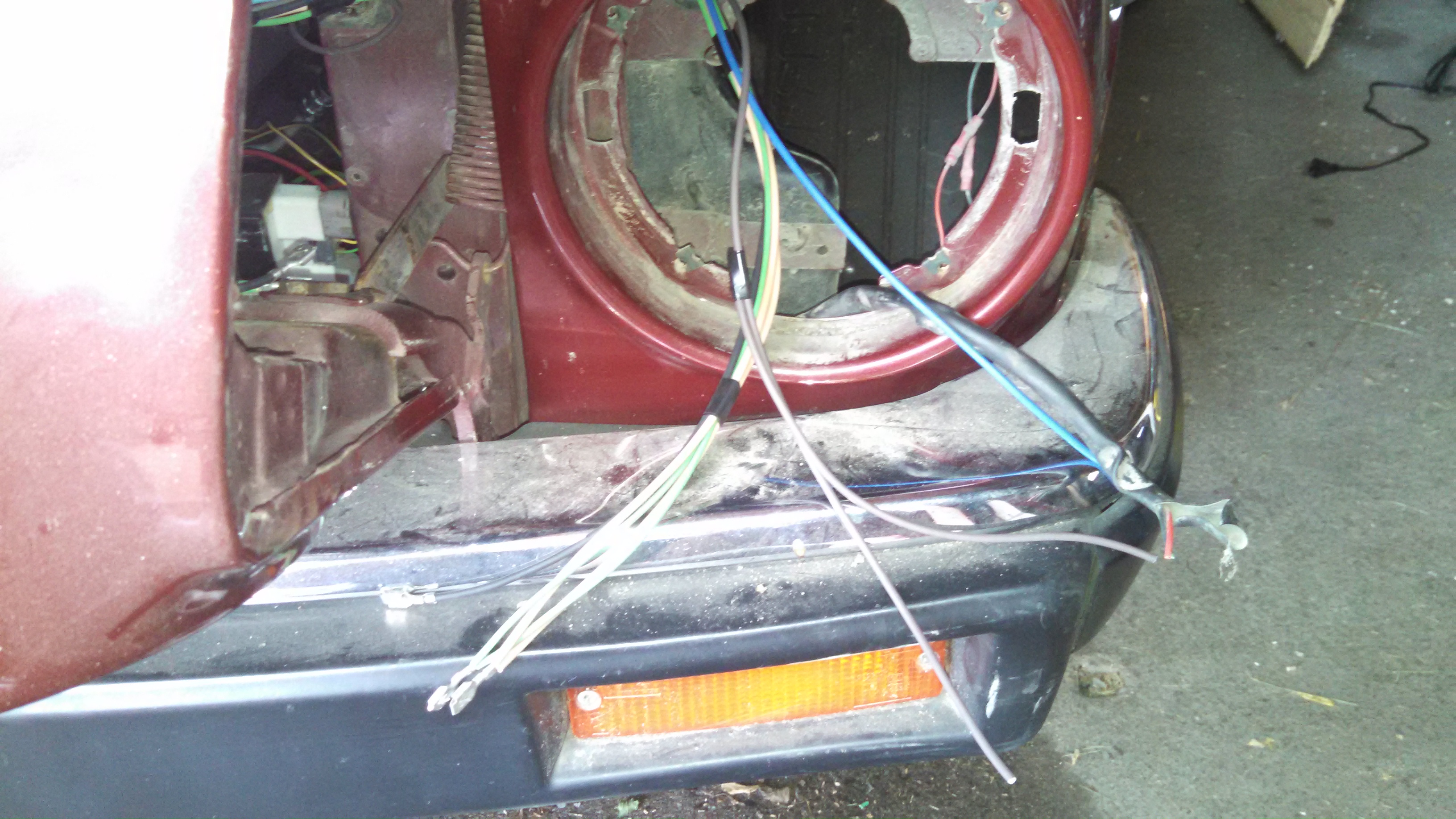

Working on the Jag after a short storage break-adapting the Lucas front lighting harness to a GM style one...
Attached Thumbnails pics of my XJ6 project "unghetto"-img_20150621_134810_808.jpg   pics of my XJ6 project "unghetto"-img_20150621_134756_656.jpg

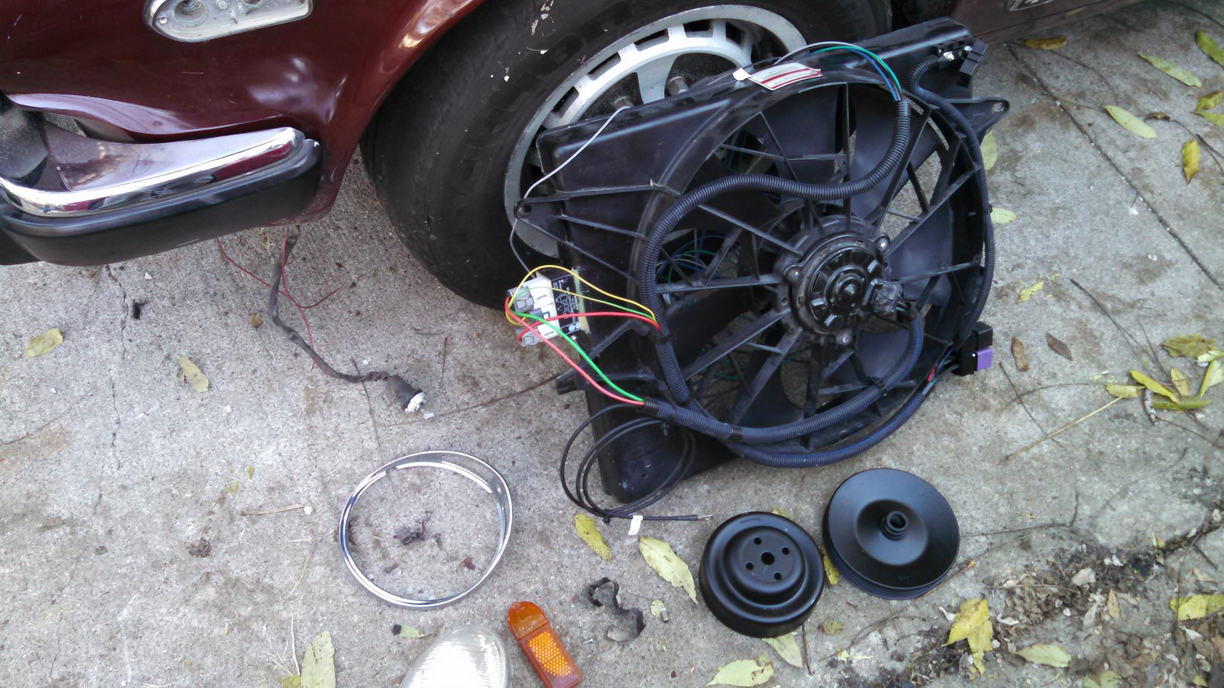

Here you can see where I epoxied the 2-speed Volvo relay control for the dual speed Motorcraft to the side of the shroud...
Attached Thumbnails pics of my XJ6 project "unghetto"-img_20150621_134746_939.jpg   pics of my XJ6 project "unghetto"-img_20150621_134738_579.jpg

From here in the stock location, I'm using the Lucas leads from the headlight switch to act as triggers for the headlights, turn signals and parking lights. This is also where the relay bank will mount to run the low and high beams-taking a major load off the headlight switch.
Attached Thumbnails pics of my XJ6 project "unghetto"-img_20150621_134730_535.jpg
