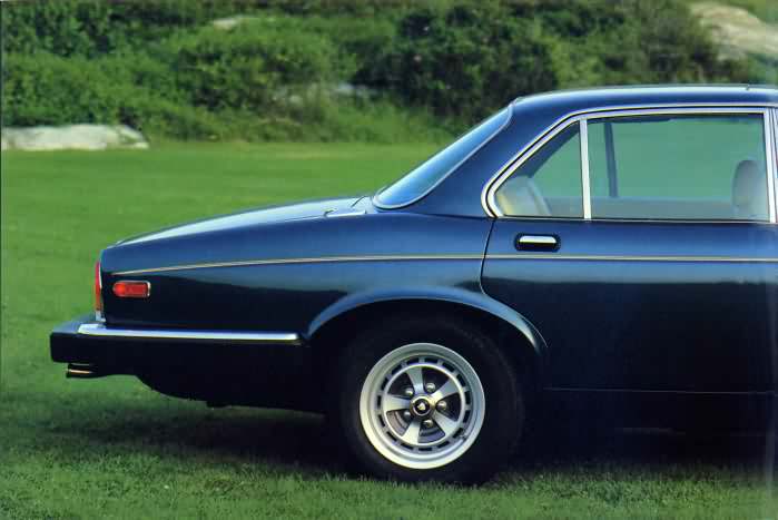

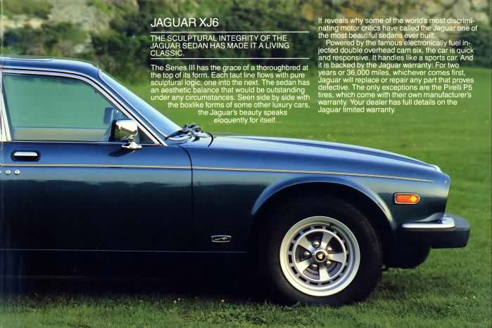

The question then is where does it start and end, and how high above the body line is it?
These pictures show the stripe better than what I can explain it, but are of low resolution. Hopefully someone else will post close ups with measurements to verify.
And I'm not really sure why there are two door locks on the advertised model below?

Well, I had to go look at my car. An 83 XJ in Grosvenor Brown. Original paint and in very decent condition. Striking when washed!!
Two very thin gold lines along it's flanks, closely spaced. At e front the get closer together til they merge in a point.
I'm reasonably sure they were applied at Brownslane as decals. Pulling a line in real paint, a lost art.
