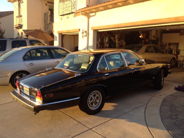

Before you tackle your car take a look around and really look at the numbers. My current car was involved in an accident and to repaint it properly (going back to bare metal, removing all trim, taking all glass out, taking out the interior, and most importantly putting it back together properly) cost the insurance company $8,500.00... and remember my car is rust free and was in mint condition before the accident.
Not to get upset but I ended up getting into a fender bender that put scratches down both sides of the car. Of course the other two drivers did NOT have insurance and one didn't even have a drivers license and was illegally here.(sorry for the quick rant)
Then you have to look at your interior. To have a new leather interior fitted would cost $2-3k+ and sometimes doesn't look as good as the original. My wife didn't like the faded dash- not cracked, just faded. I am having a new dash fitted and it is running $1,200+.
But before you tackle the cosmetics how does the car run and go down the road? You don't want know what it will cost to properly rebuild a neglected XK engine... then there is the transmission. If it doesn't stay planted on the road either front or rear suspension units will require attention.
There is one bright side. The cars are old fashioned and built using old techniques. I've had the door panels off a few times and they go back without rattles. The dash comes apart and has SCREWS to put it back together. I wouldn't want to see what happens to my Lexus LS when the dash or door panels need to be removed in 25 years since everything seems to clip together with plastic clips.
Sorry for the long rambling post.
And contrary to what some people think make friends with a GOOD-HONEST British repair shop and it will save you money in the future. They are the ones that recommended me to scrap my family car and start over. With their help I found a car that had front and rear suspension overhauled, was local, was always garaged, and serviced every 6 months regardless of cost whether it was driven or not. Once the original owners widow realized I would maintain the car to the same standards that her late husband did she sold me the car for less than it cost for the suspension overhaul.
Sorry if it is a little messy - Typing on an iPhone.
