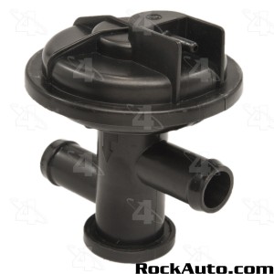

I thought it was a heater valve, but the 3 that are on RockAuto (including the one I ordered) doesn't seem to be right.
Is this something other than a heater valve?

all the valves in the pictures are Heater Valves, also known as Heater Taps, but only 1 is a Jaguar XJ-6 part.
if Rock Auto is telling you that the First, Third, and Fourth pictures are for a Jaguar XJ-6,
run, don't walk. Stick with the original Heater Valve.

Why? Many an original metal vacuum operated heater valve has ben replaced with a plastic generic unit. If he default on/off matches, why not. And, much easier to install.
But, if absolute originality is an aim, sure get one of the metal units.
My car's generic plastic one works just fine. That is when I get the ignition/start issue resolved. I am taking a break from that.

because of the mounting. In the XJ-6 the heater valve is mounted to the firewall with nuts and bolts. In fact, all Jaguars have their heater valves bolted / secured to a bracket of some sort.
even my '65 S type has its heater valve bolted to the firewall.

Absolutely correct. But, unnecessary.

The generic unit is supported by the heter hoses alone, sans any support to the bulk head.

So, theoretically, the generic RockAuto units (all 3) could work?

I'm not sure about the third one, but you can get the plastic ones at any Autozone or Advance Auto Parts locally, no need to order it by mail.
make sure the one you get is NORMALLY OPEN / CLOSES WITH VACUUM.

If it were me, I'd fit the correct valve. SNG Barratt have two listed but one is an aftermarket item, so a bit cheaper, and will probably last OK. Only the Jaguar-pattern valve has the inlet and outlet ports in the correct relationship, plus fitment holes to secure to the bulkhead bracket. Why try to save a measly few $$s on your pride and joy ?
