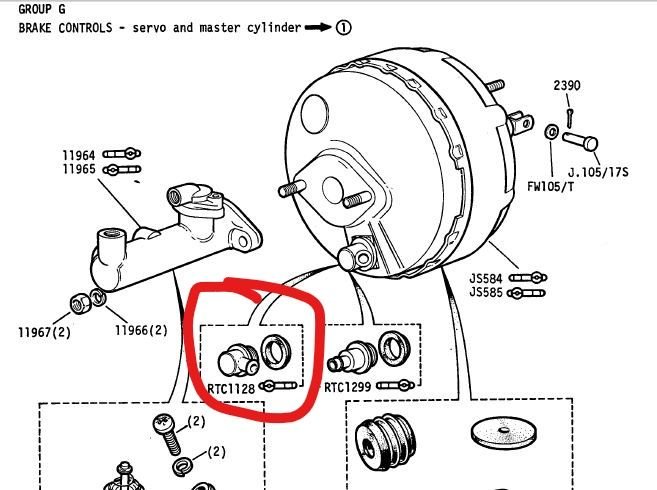

It's feeling like my power brake servo isn't power brakes anymore. I haven't checked to make sure there's vacuum to the servo yet, but I'll do that tonight. Part RTC1128 says it's a "check valve". My definition of check valve is that it allows flow in one direction, but not the other. I don't see that as the function of my RTC1128. It just seems to be a 90d angle plastic elbow. And it seems to be mounted on the top portion of my brake servo as versus the picture below, showing it on the bottom side. I can't imagine that makes any difference though. I do have a check valve mounted just below the vacuum connection at the intake manifold that's dedicated to the brake servo.

Some manufacturers have the chheck valve in that elbow, or fitting AT the booster, Jag do not, that i have found over the years.
The S2 cars in my fleet had a metal check valve under the Inlet manifold, near the oil filter (memory only on the actual location).
Also had that fitting in the boosters at the bottom, and that could have been for plumbing convenience, as, like you, I see noiw reason for 6, 12, 3, 9 o'clock orientation.

The check valve-vs-plastic elbow is just one of those catalog errors that comes along from time-to-time

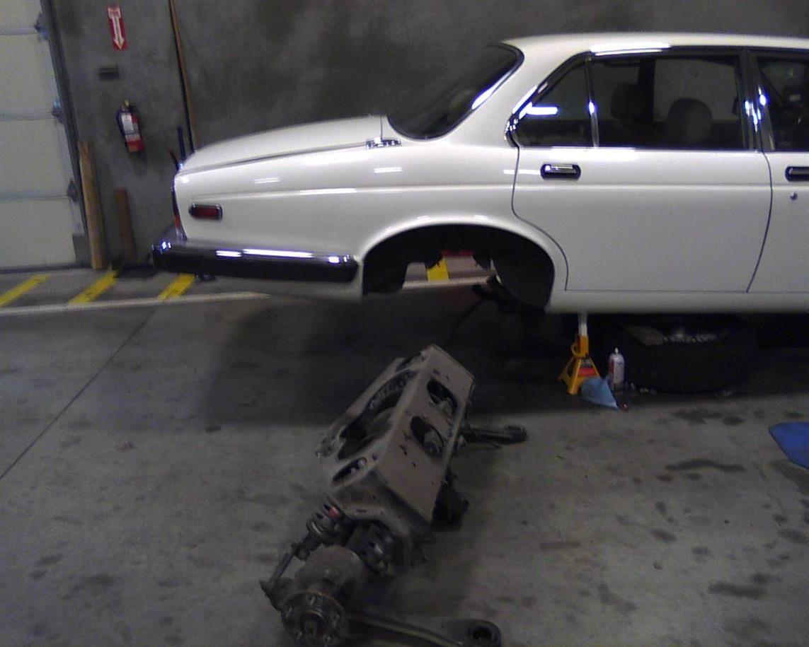

Sidebar - It's the highest I've ever put it up on jackstands. And I know at some point fairly soon I'm going to have to drop the rear end assembly. Anybody know exactly how high I have to go to have clearance for the assembly to be pulled out from under the car?
Never measured, sorry, but the pic should give you a rough idea

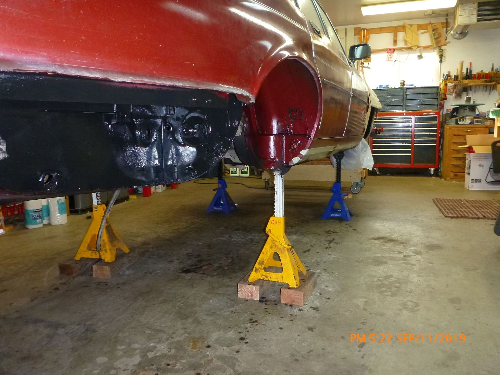

Mine is sitting 44" from floor to top of wheel arch, both ends. I didn't pick that distance, that's just all I got with my jack stands. I had my Son and Daughter-in-law steady the hubs while I lowered with floor jack under the center and then rolled it out the rear on the jack. Removing the rear assembly is the ONLY way to do any work back there, in my opinion.

Don't skimp on the jack stand, Bill. The ones in the picture are 6-ton models for about $70/pr. at Autozone. I have lighter duty ones, but these have much more range and a bigger base. Stacking 2x4's or anything else that is not flat and pretty hard will make the car more unstable.

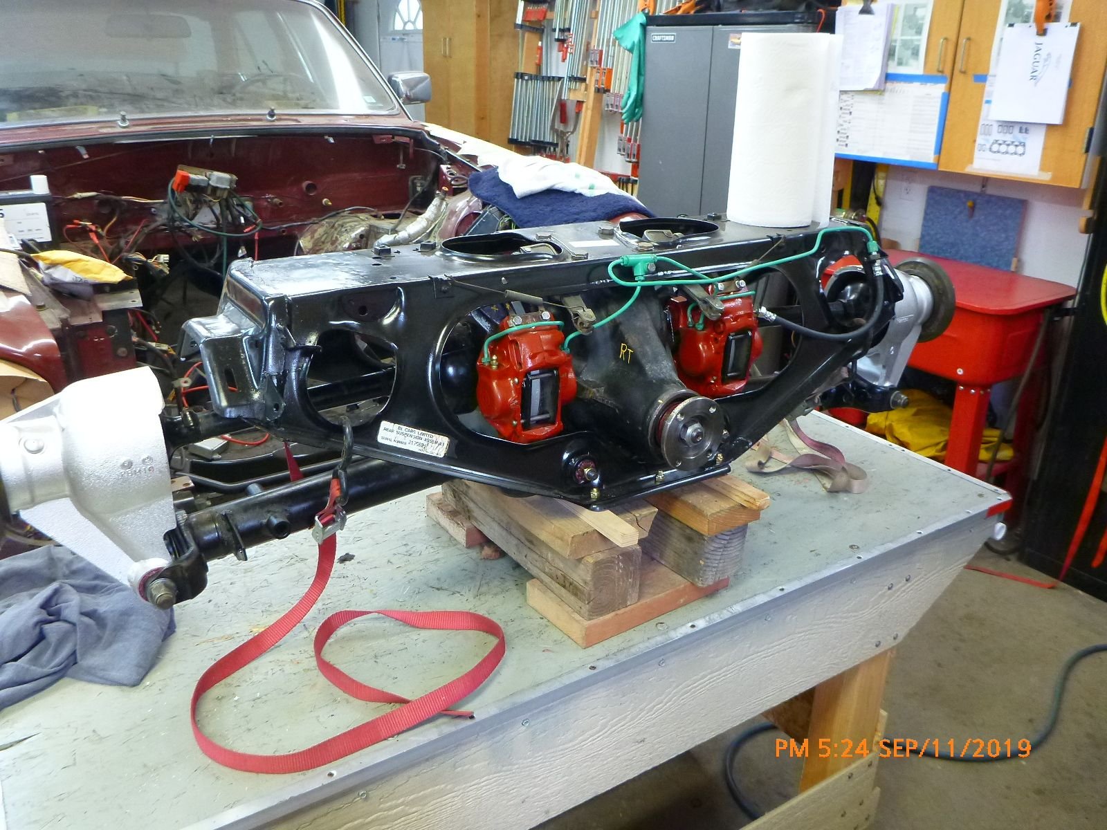

The rolling cart at the front of the car is something I built just for the rear subframe. I knew I couldn't work on it laying on the floor and putting it on my work table would mean that I wouldn't have room to actually work on it. I was able to disassemble/reassemble it on the cart and work on the pieces on the table. I am constantly rolling it around the car to get it out of the way, but at least I can.
