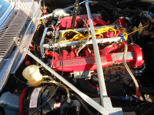

Got it, thanks. The car is in an old skool custom muffler shop having a new system built, so once I get it back from there we will experiment with a bit more advance. Certainly the 8° we adjusted it already makes a huge difference in performance and also running temps.

i run 25/28* BTDC at 950rpm,(any more has startup kick back), 48/50* all in at 3000rpm!
runs great no hunting/surging, custom curve,(just finding what works for Pre-HE combustion chamber).
93 oct, USA fuel, and Grant's right almost impossible to make pre ping, 9.2 pistons.
i use stanalone ECU ,SDSefi.
