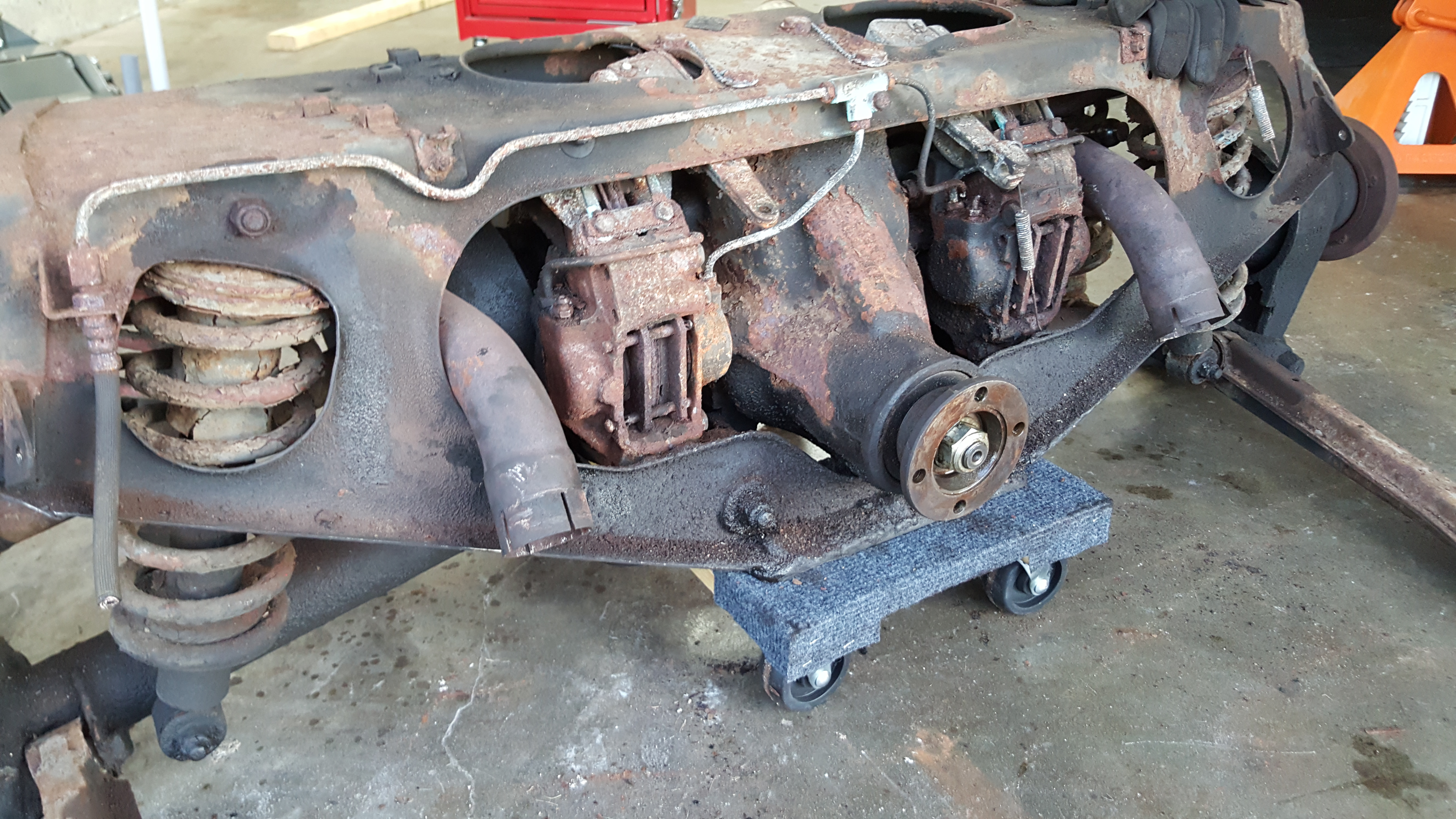

@Panhard
We just did this on our 76 XJ12C a few days ago.
The bolt won't come all the way out, but when you rotate the caliper and pull the caliper out, the bolt comes out with it. Putting the caliper back on you just put the bolt back through the hole in the caliper then offer the caliper up to the diff and find the hole there.
Old Mar 7, 2016 | 03:03 AM
Panhard's Avatar
Joined: Mar 2016
Posts: 6
From: Harderwijk
Than you for your reply Sarc.
I understand what you mean and with the other calliper the procedure you discribe was succesfull. But with the right calliper it isn't. I read somewhere that the holes in the subframe of Series I are smaller than on the Series II and III.
Old Mar 7, 2016 | 06:03 PM
Sarc's Avatar
Joined: Oct 2008
Posts: 1,930
Likes: 537
From: San Jose, CA, USA
Oh :-(
Attached a pic of the front of the Series 2 cage. Once the handbrake mechanism is taken out, the caliper comes out the front easily, even with the bolts still in it.......... Why is the bolt not letting you take the caliper out ? How close is it to the diff ? (I can't mentally picture where you are getting it stuck)
Is it possible to rotate the caliper around the disc to another place in the cage and take it out that way ? Like could you rotate the caliper all the way over the top to the other side, then pull it out there ?
