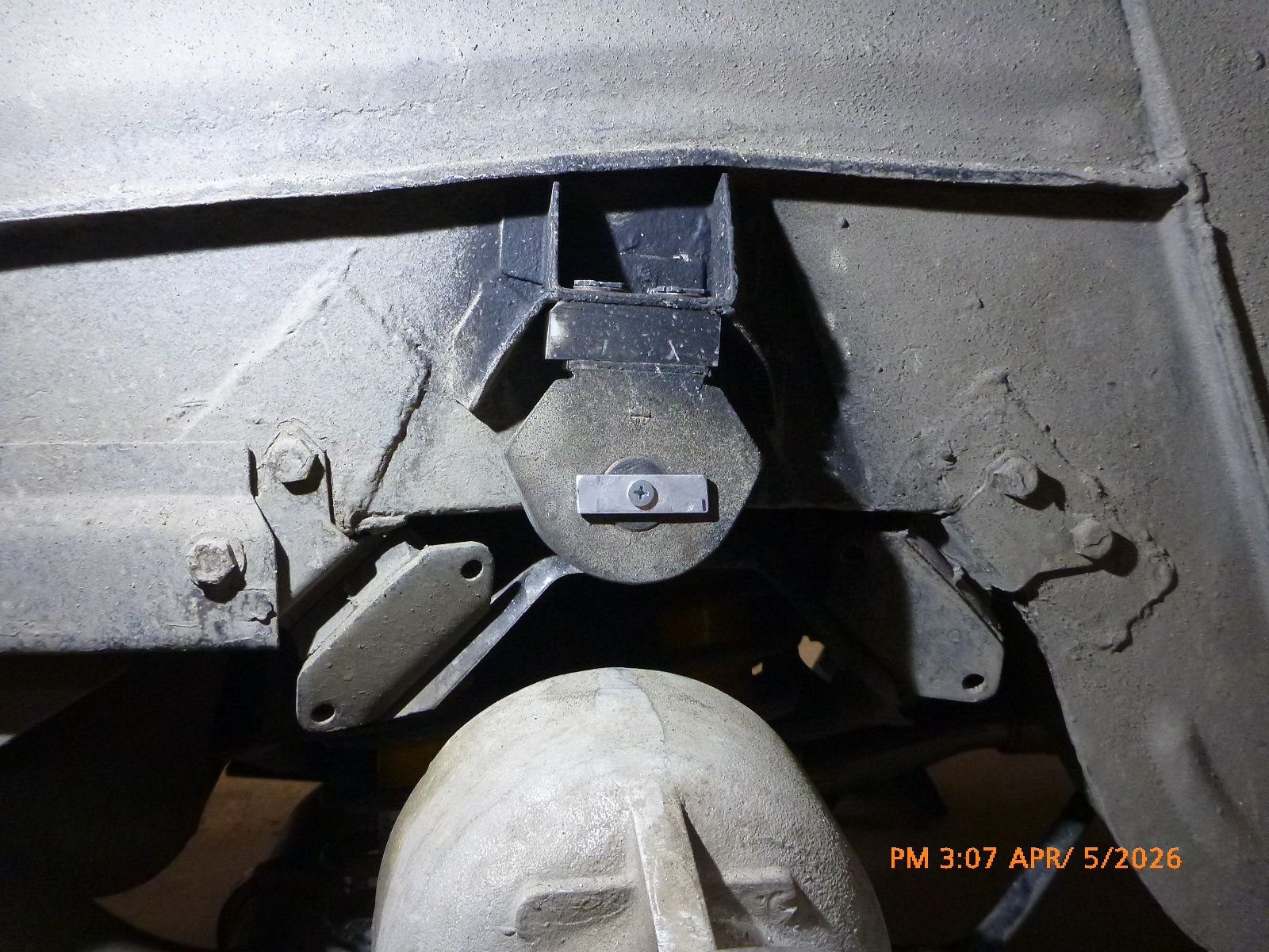

I've had an irritating problem since I finished rebuilding my S3. I chose to route the exhaust under the rear cage instead of through the suspension parts. Of course that removes about 2 1/2" of road clearance, and so began my problem.
Hitting the exhaust on dips in the road. The suspension compresses farther than the exhaust clearance and we have contact with the road. With four people in the car I managed to ding a catalytic converter enough to break the matrix inside. This spring I was bound and determined to find an answer.
I could see the bump-stop was made of relatively soft rubber and there is a big whole in the middle of it. There was also almost 3" of clearance between it and the hub carrier at road height. Add another 2" of compression to the stop and it was more than my exhaust could withstand. I added 3/4" spacer above the stop and inserted a piece of 1" Delrin (just what I had in the shop) in the hole. Test drove today and will call the problem fixed. This may not be of interest to most, but if you are experiencing road-rashed exhaust this could help.

You didn't hijack, Darren. But you brought up a good point about the age of the springs, mine are original.....41 years. I had thought about stiffer springs, but I would want the ride height to stay the same. They would have to be aftermarket and they would more than likely be expensive. I figured massaging the bump-stops would be the cheapest first step and I'm satisfied with the results. I'm going to start picking my battles in life and try to enjoy some of what I've accomplished, which includes the Jag. I've done a little tinkering on it in the last year and I'm going to call it good. Now I'm just going to drive it and smile.
