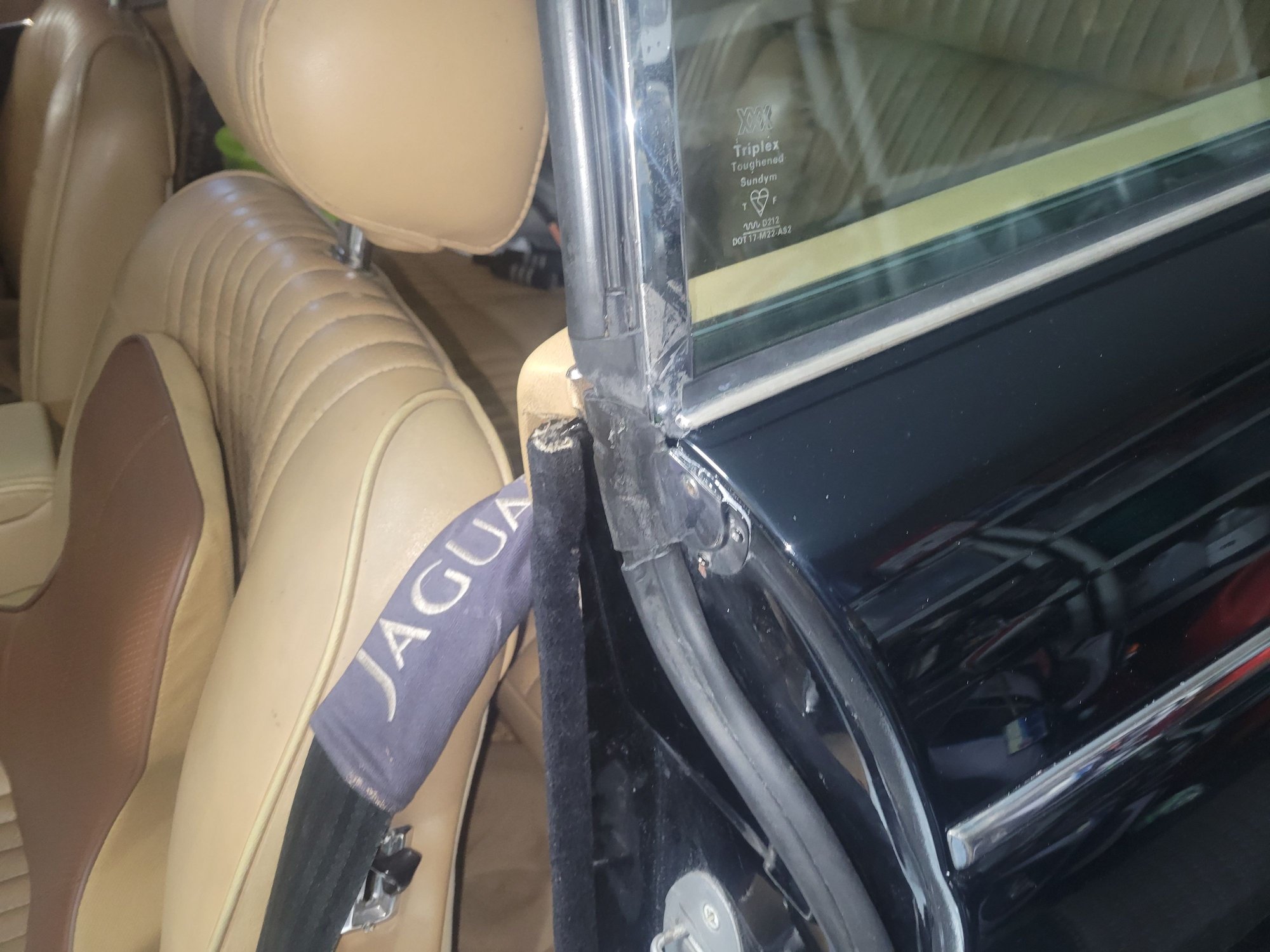

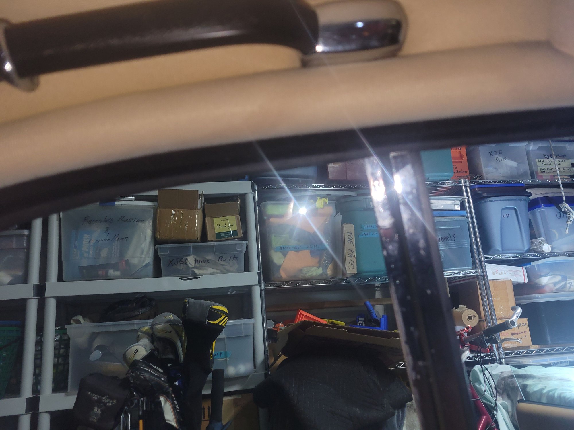

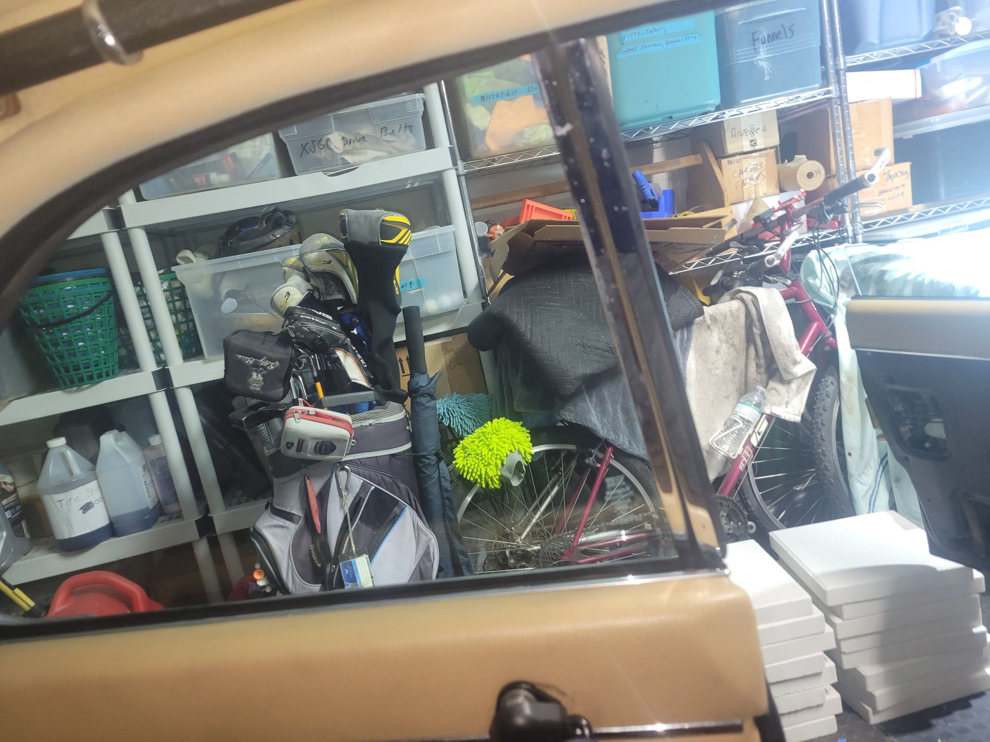

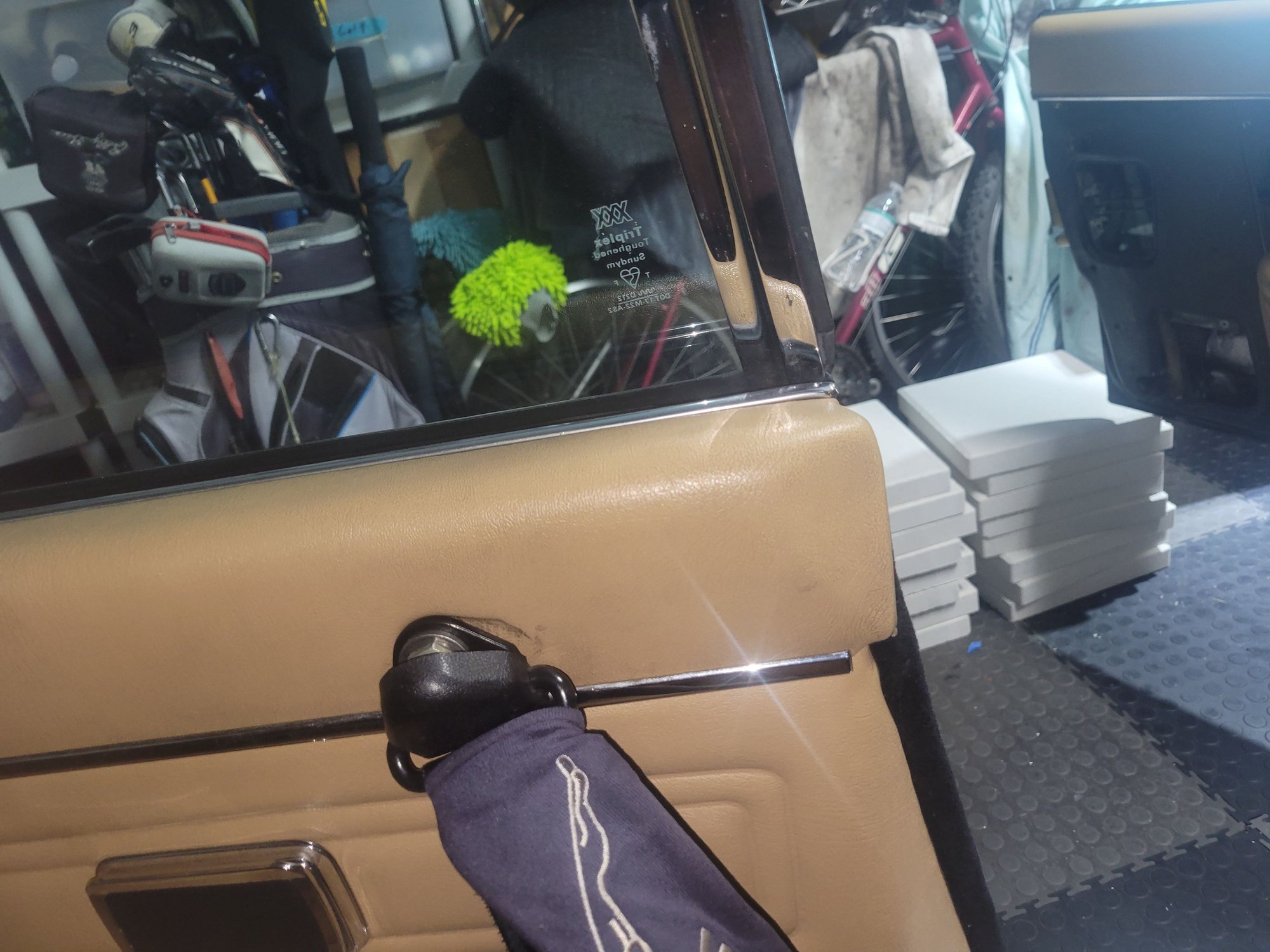

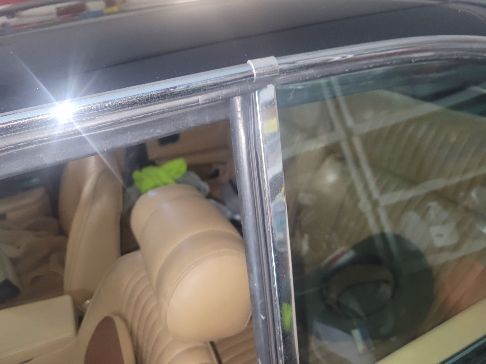

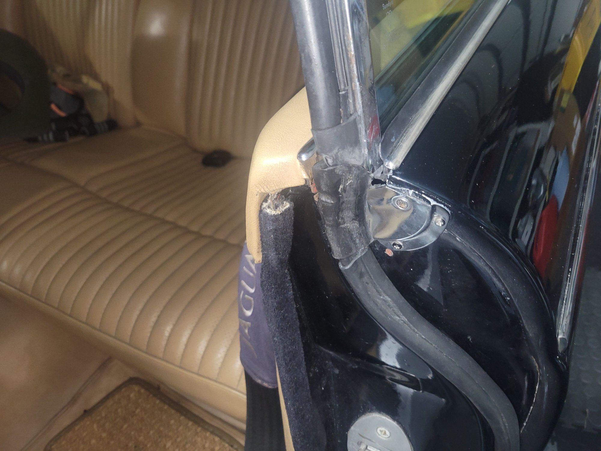

Hi, I am after some help with rear side window alignment on my XJ coupe project please.Can I ask if someone could send some close up high resolution images square on to the side of the car I the forward lower corner of where the rear side window sits when in the raised position, with the door open please.
Currently I don’t have the skin in the rear quarter panel but have fitted the glass assy. I am convinced that the window is sitting too far forward. But without the door built up with the glass I cannot tell.
If possible 3 or 4 images taken around the periphery of the window showing it sitting in the rubber seal at the top and back of the window would help….. many thanks.

Don't know if this helps or not -

Hi Yachtmanbuttson, thank you so much for the images they help me a lot. Would you mind if I ask for one or 2 other images if I need them please?

Happy to help. Just let me know at what angles.
