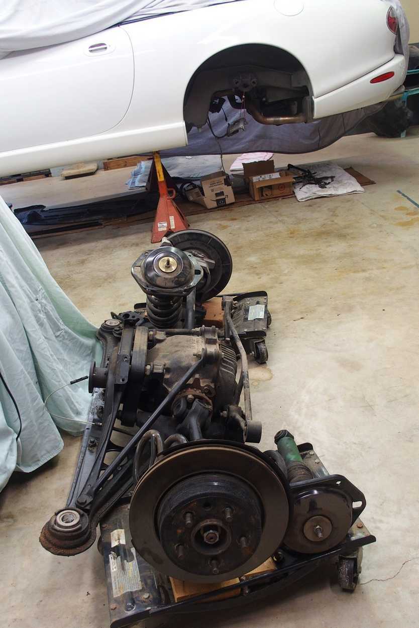

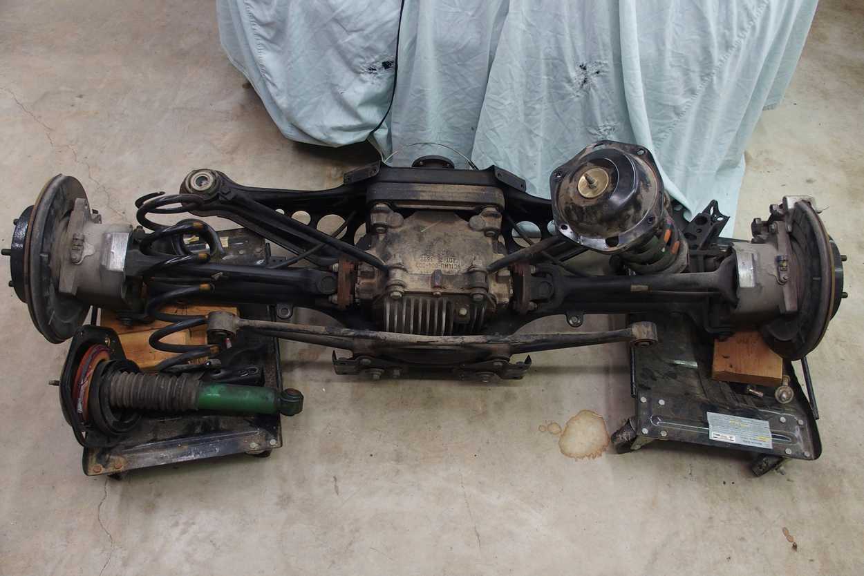

I took PKWise's suggestion and also enlisted the great help of a fellow forum member, Steve Masey.
We dropped it out with no muss, no fuss...now the work begins.
