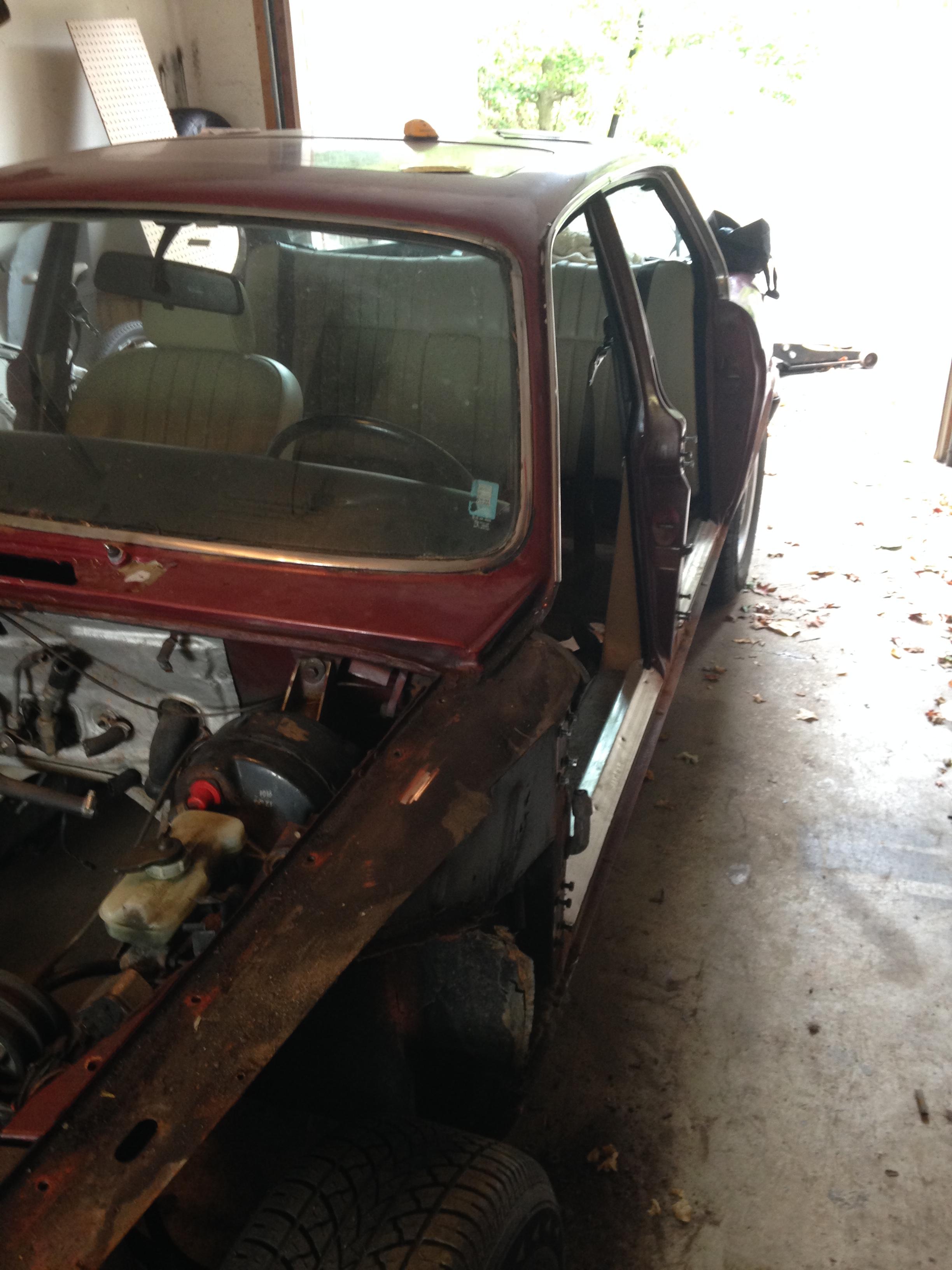

So i saved this car from going to scrap about a year ago. its been the most fun rewarding (infuriating) car Ive driven. But engine problems (surging and leaks) a rusted gas tank and a leaky borg 66 have forced my hand into taking everything off and starting over from square one.
Now Ive built the engine thats going to be taking the place of the ever so reliable XK 4.2L. A 350 small block out of a 1970 z28 making about 410hp/tq (ish) at the crank (i've upgraded and worked every aspect of the motor now).
I've read that the small block swap is possible and somewhat ?easy? I found trans dapt engine swap engine mounts. would it be a good idea to use these? http://www.summitracing.com/int/parts/trd-9906 ??
also im looking into getting a 4l60e or a 700r4 (which ever one i can get in better condition for cheaper). im looking into swapping the rear end aswell. Has anyone swapped the center sections and axles? How did that work out for you? (dana center section i hear is good)?
Last question, are there any companies that have suspension upgrades, I'm ok with using the oe spec shocks struts and coils from SNG Barret, the front springs and shocks were replaced and it made an enormous difference.
Sorry if im all over the place but im really excited to start working on this beauty.

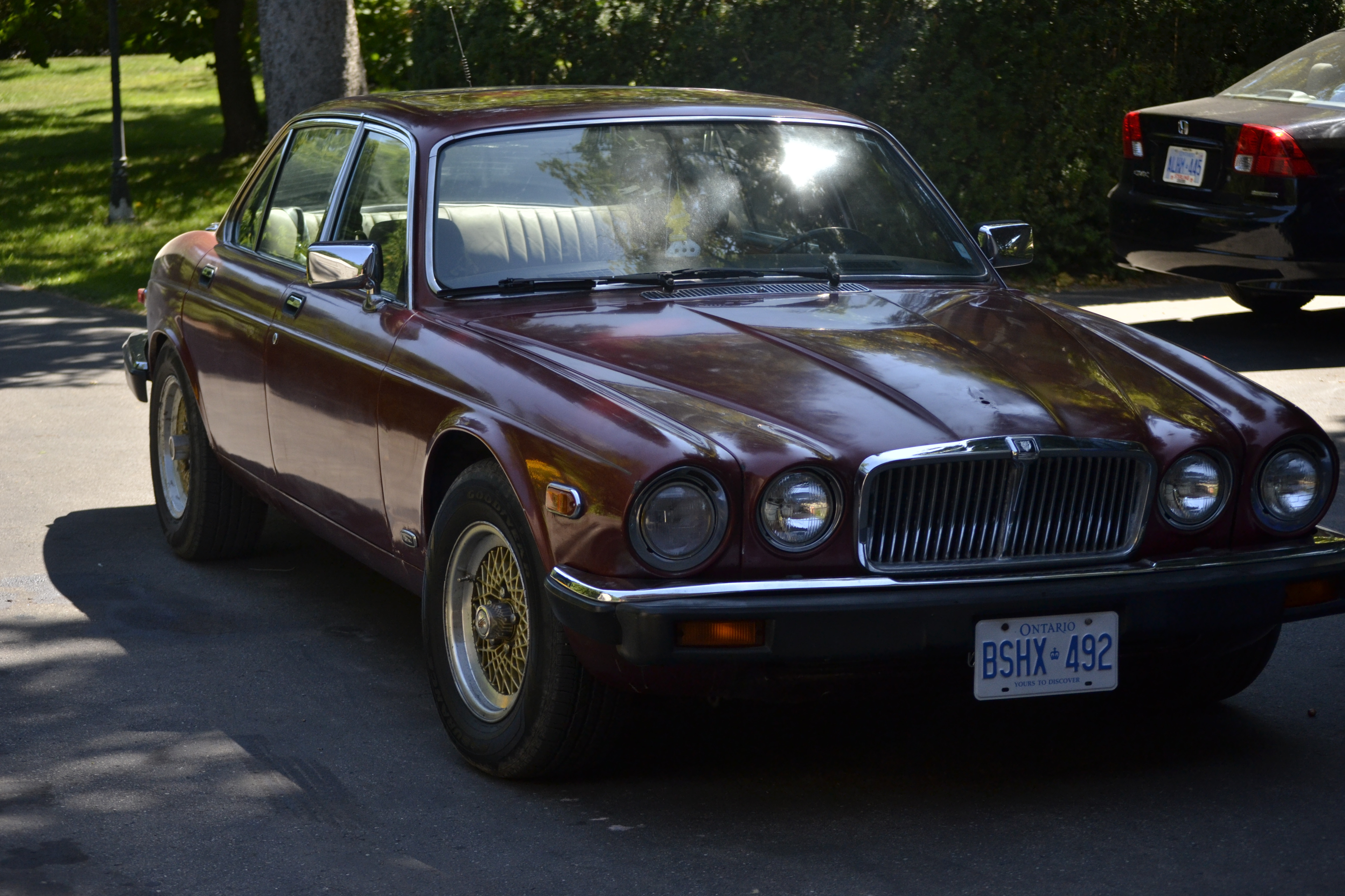

Anyone have any info on the wheels on this car??? i love them, they would look great on my racing green car!!! i have always wanted spokes but have heard nothing but bad things about them! ie spokes coming loose, hard to clean high unsprung weight. etc etc
Perhaps i should clarify before i get the "its a lattice wheel" response, I like the gold center part, is that a factory finish or was it done later, etc, if its a factory wheel i would like to know the part number..

thanks ill keep searching and stockpiling parts. The wheels are bbs mags i believe and they are for sale. ive had them sand blasted and primered. let me know.

The wheels look like the ones on my car. A friendly local KIWI upgraded his beautiful XJS. They were offered for free. Pristine, as his car and his home.
It was time for new tires, so I had them mounted on the lattice wheels.
I did shop EBAY for the center caps.
I guess that means they are no longer gold... do you have a price in mind??

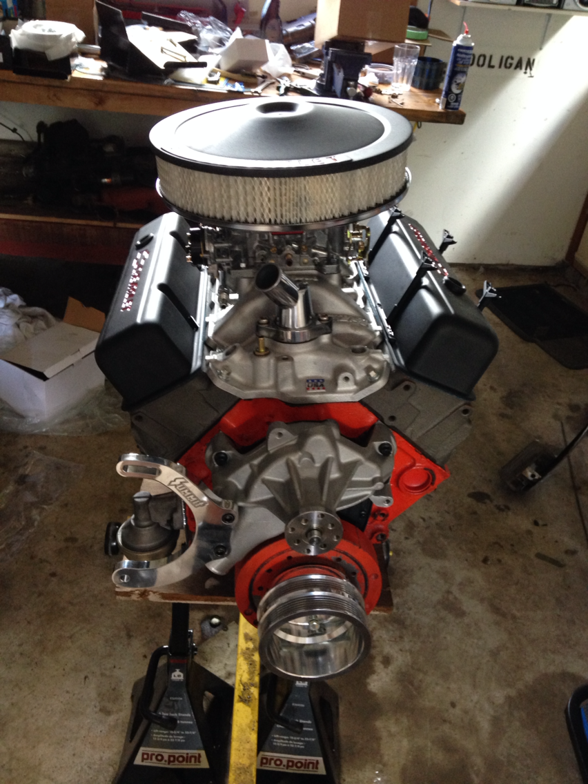

heres a photo of the new engine. 350 chevy small block, .500/.512 lift cams, 1.5 ratio compcams roller rockers, 11:1 compression. I'm hoping it'll be over 400 at the crank.

Oooooooo!! Pretty Rockers!! Shiny things!!
I just showed husband that pic and asked, "Can I have some of those??" And he took me into his room in his closet and showed me a box of BLACK ONES to match my car!!
And then he said if there's any way the smog cops can see down into my valve covers I can't run them because the SMOG cops stick a mirror in and if they see roller rockers it's an illegal engine modification (for MY car) and they fail it. Well, there is. Through the oil filler.
More STUPID California laws!! What possible bearing can rockers have on emissions??!!

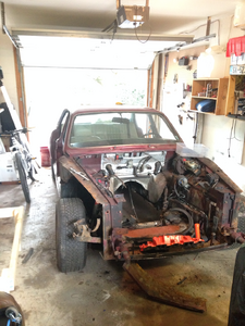

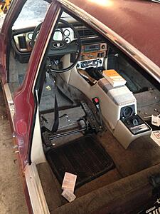

Did some work today, actually a lot of work. Finally got the fenders off (with some help from an angle grinder) then proceeded to take off the doors and take out the seats. I'm pleasantly surprised to only be finding surface rust and not heavy British leyland ROT.

can i remove this and just mount the seat directly?

don't know for certain if you can bolt seat directly there! if your motor is dead i have a spare seat motor and frame, its yours for $25 plus shipping if you want it! or are you just trying to delete it?

im tall so i wouldnt mind trying to delete it, maybe through it up for someone to try and fix, or fix myself
