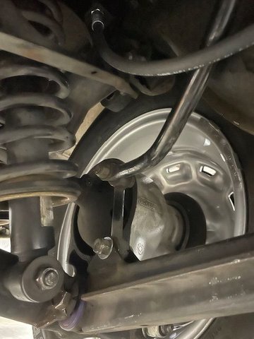

Dave I have xj40 wheels on my 86. The centers are good but as Doug said, the plastic hub caps lack a couple mm depth to fit back on the fronts, as the grease cap protrudes through. Maybe find a style that doesn't use the flat plastic hubcap? Also get the corresponding lugnuts or they could cost as much as the wheels.

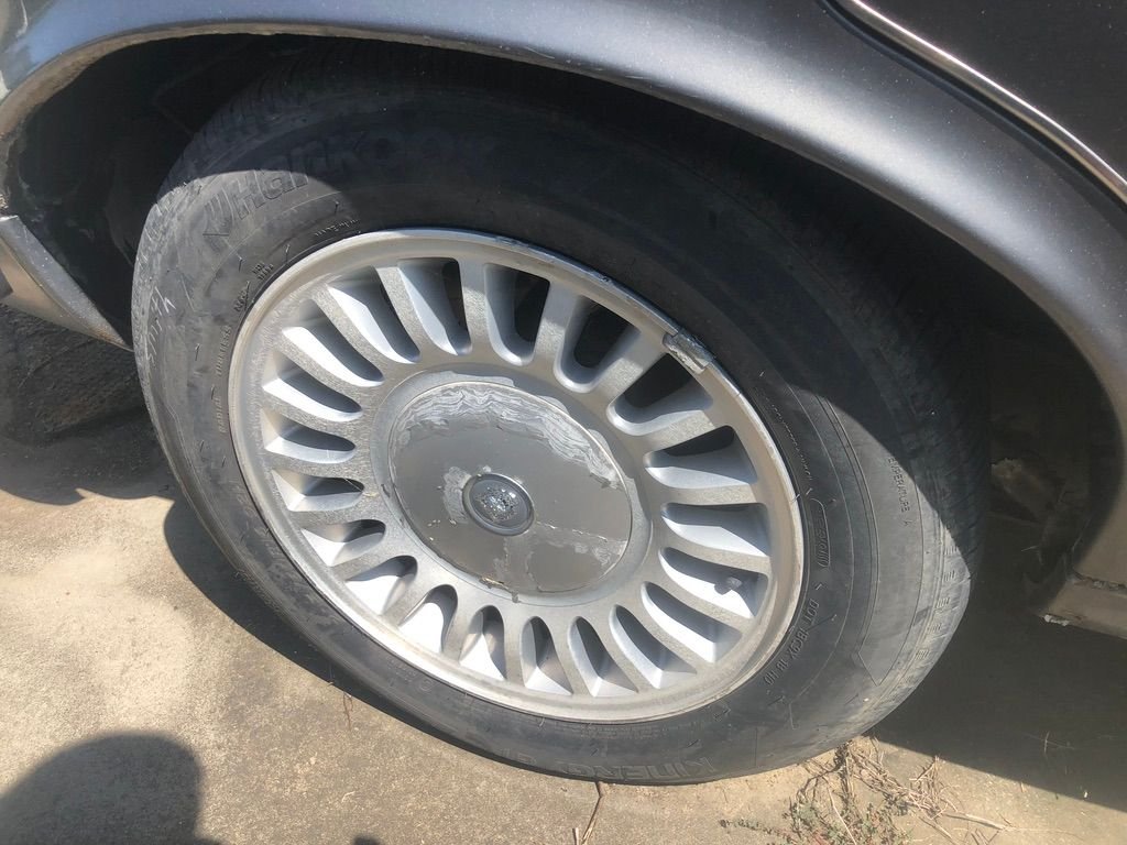

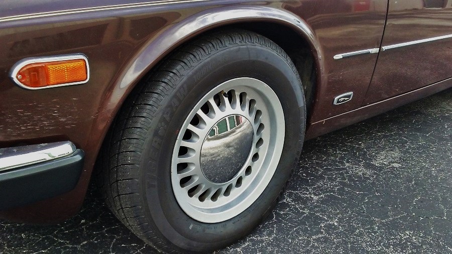

Pics of xj40 wheels on ser3,

I see what you mean about the dust cap on the front hub, are there other styles of lug covers that would not create that problem? I see the second picture has a dust cap cover, is that a standard XJ40 piece? As far as the wheel goes, that's a keeper to me.

I use a 7/16" spacer for the front hubs, got longer nuts at PepBoys.

Elinor also has "Teardrop" wheels in her XJ, ( CHROMED !! ), she also used spacers at the front to clear the hubcaps. She calls the spacers "concentric".

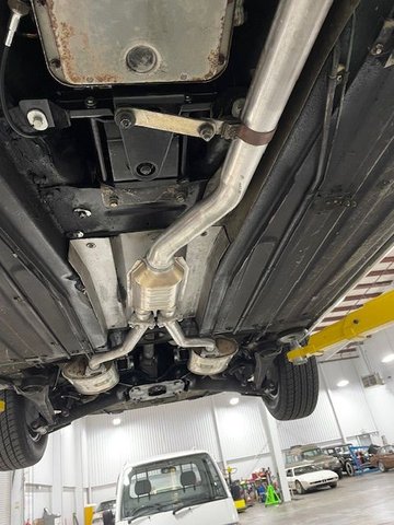

The rear cat convertor was breaking away from the exhaust pipe which itself was badly bent.....although how it could've happened is a mystery to me.
I took a gamble and bought one of these off Ebay:
https://www.ebay.com/itm/20480776862...UAAeSw~eNor2zI
It was about $35.00 cheaper a few weeks ago ! Anyhow, I am pleased to report that it fit perfectly. Installation took maybe 45 minutes; one section of pipe needed very slight trimming; 2 minutes. the most time consuming part was separating the old pipes from the mufflers. The new kit includes the long pipe to the forward converter and the two pipes going to the mufflers, these latter being clamped rather than welded. I can recommend it to anyone needing a low cost, easy replacement.
