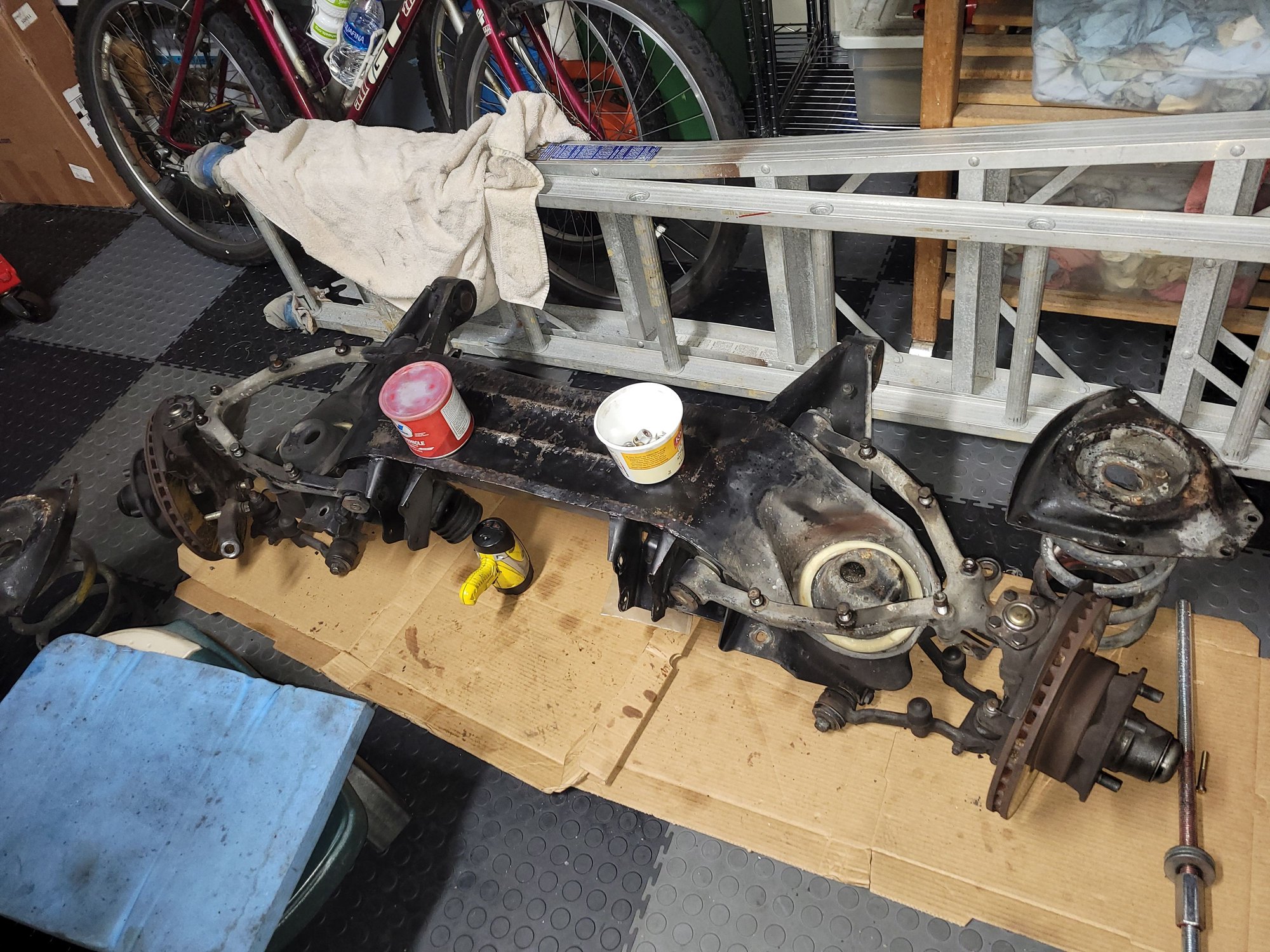

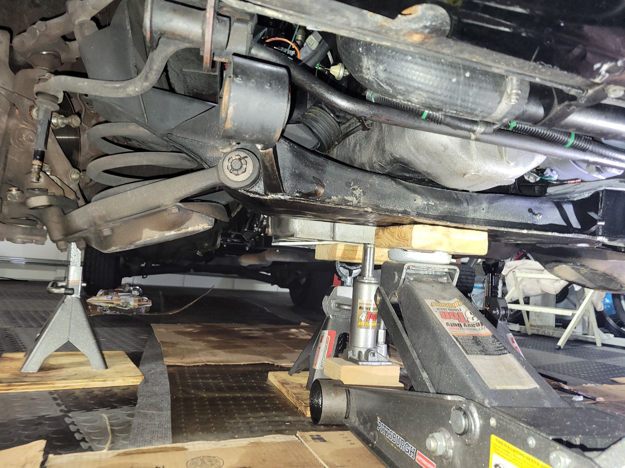

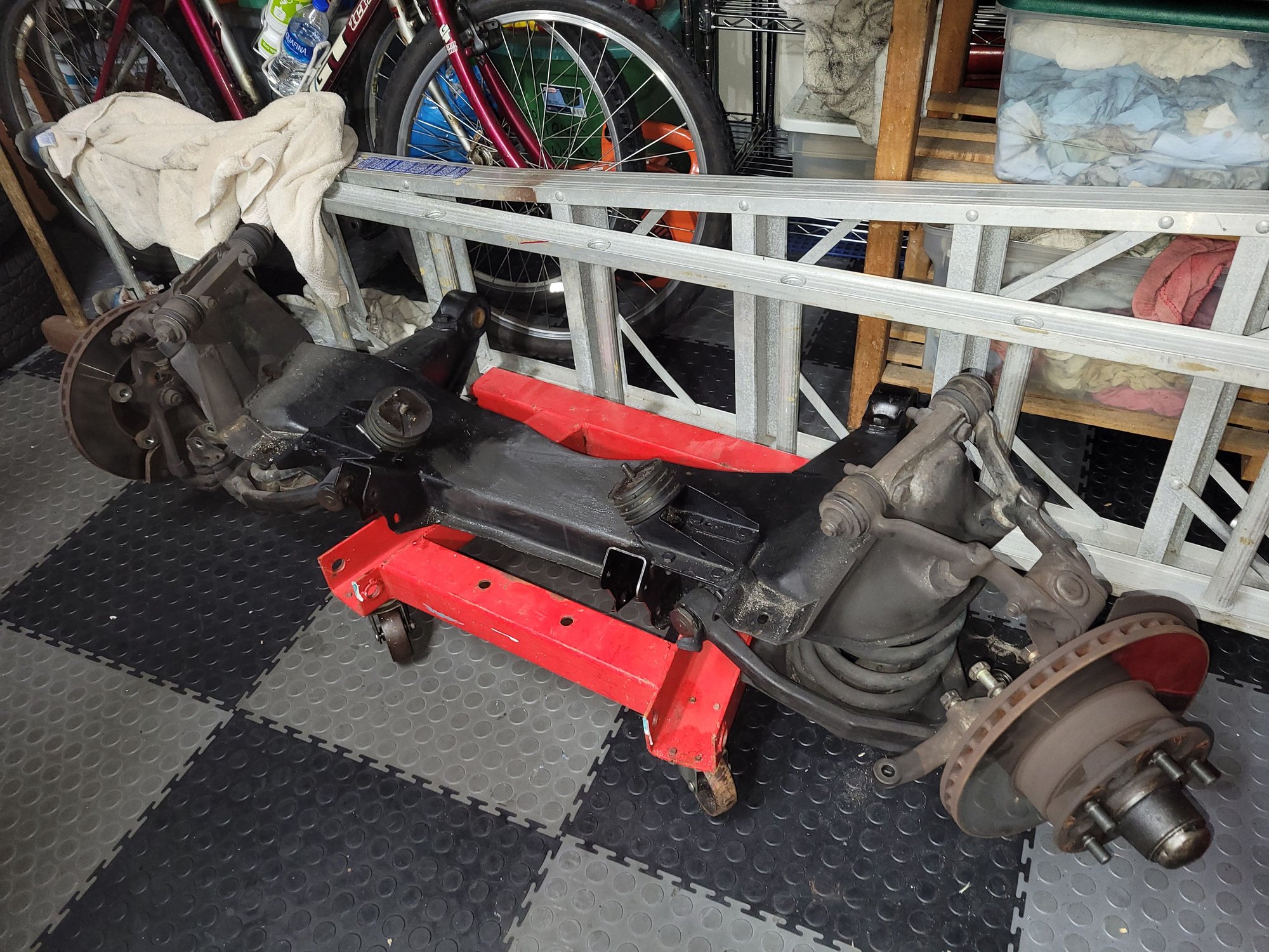

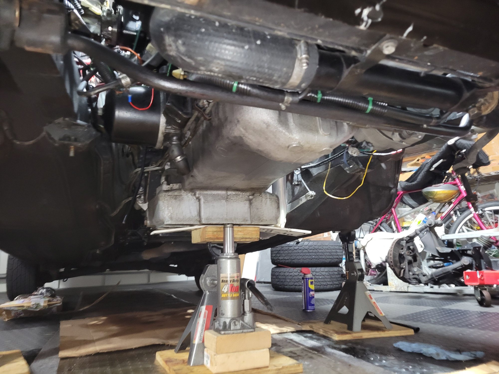

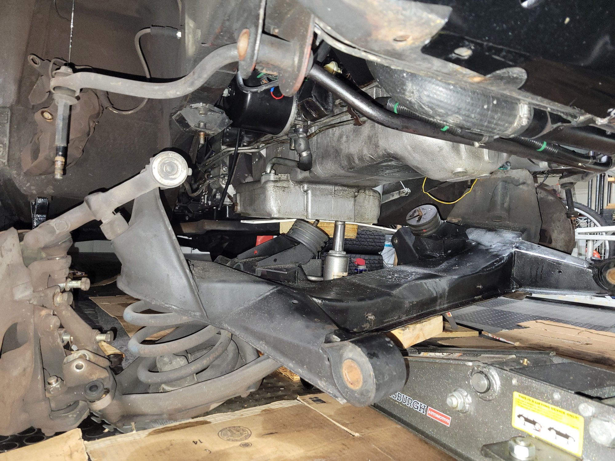

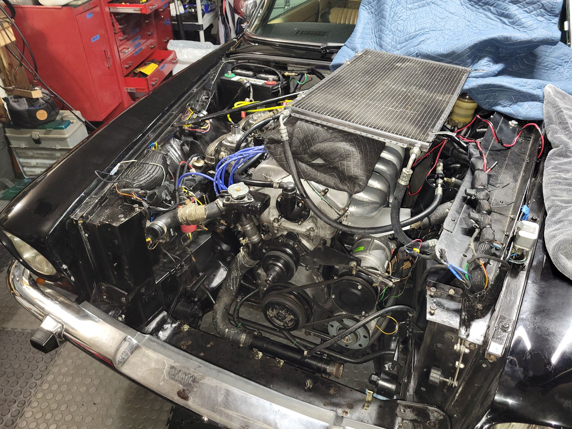

Update 4/8/2022 - Disconnected battery. Removed grill and two headlights and headlight retainers to gain access to six hood hinge bolts. Removed bolts and hood latch. Removed hood and stored in front bedroom. One man job. Removed custom aluminum radiator cross brace. Removed A/C condenser leaving hoses attached. Now don't have to worry about emptying or refilling R134A. Drained coolant from system. Removed radiator hoses then radiator. Removed two electric cooling fans. Removed PS/H2O drive belt. Removed power steering pump and disconnected hoses from it. Jacked front end up and put on third notch of jack stands. Removed steering rack. Removed brake calipers from front end assembly and hung by safety wire inside the wheel well. That way don't have to bleed brakes when done. Removed lower sway bar vertical links. Supported engine under rear of oil pan with jack stand and bottle jack. Supported front end suspension assembly with hydraulic jack. Removed two front 1 1/8" nuts and bolts and two rear assembly 9/16" nuts from rubber mount. Then slowly lowered it to the ground taking great care that it wouldn't rock backwards into the engine supports. Slid jack out from under assembly, then slid assembly on cardboard out the front. Lifted the assembly onto a four wheel roll-around.
Next is to support engine from above and start tackling the oil pan bolts. All of the above was a one-man job, but... I had gravity working for me. I'm sure it's going to be a lot harder when raising it all back up into place. But, I'll figure it out - I have to. I'm sorry the front suspension and the rod knock dissertation is all is one blog (or whatever you call this).
Hood off, radiator out, twin electric fans out, A/C condensor still connected but out of the way.

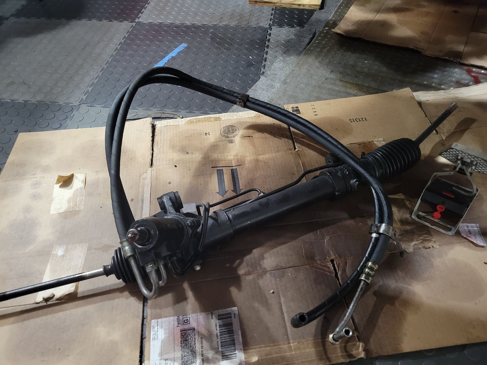

Old steering rack out - have rebuilt one to put back in. This one is leaking.
Engine supported from underneath - temporary until I get engine support bar on top
Just starting to lower
Lowered to the ground
Out of car and on a dolly

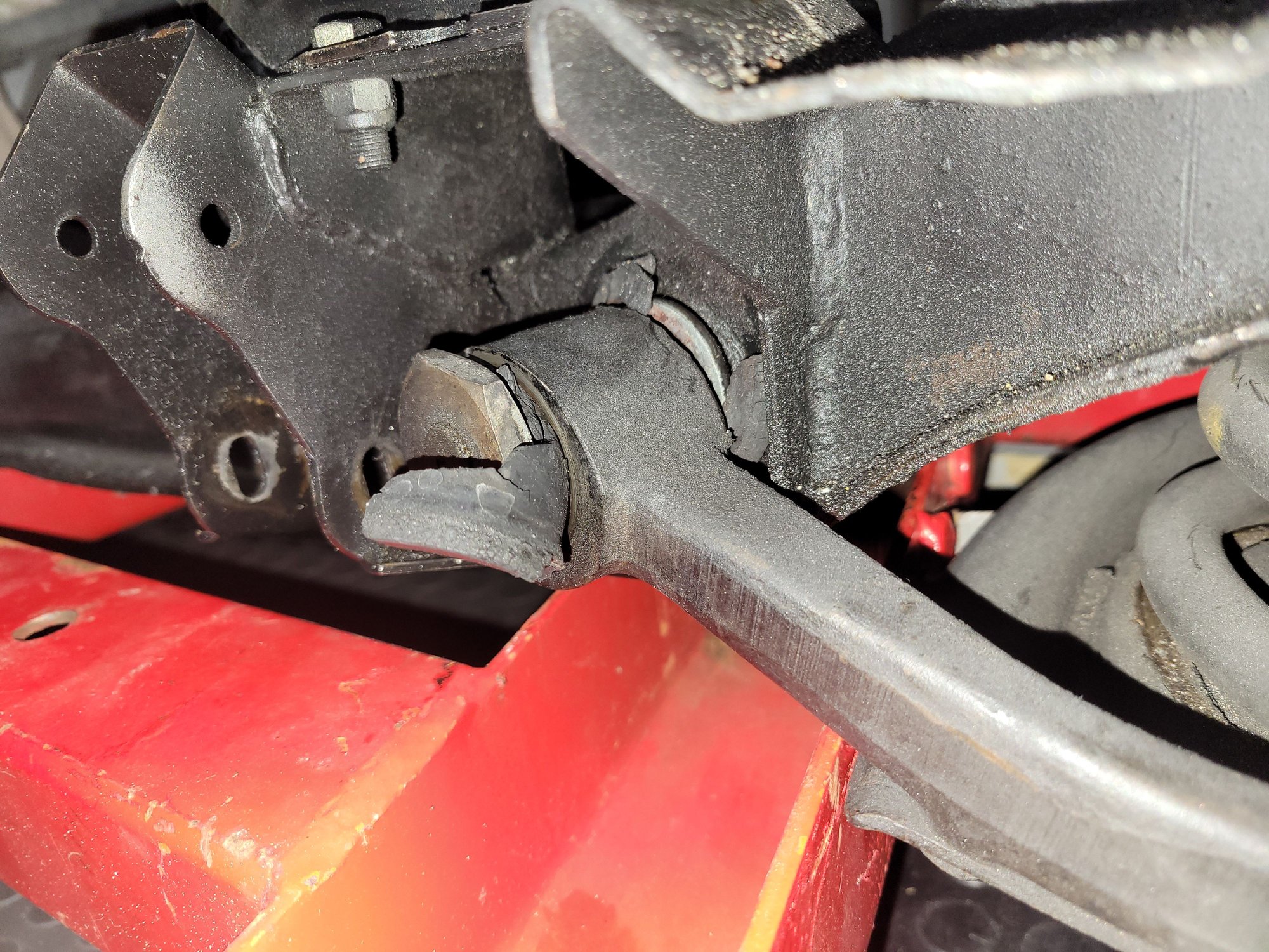

Ya think I have a problem here??

Yeah, those lower wishbone bushes do look a bit familiar!

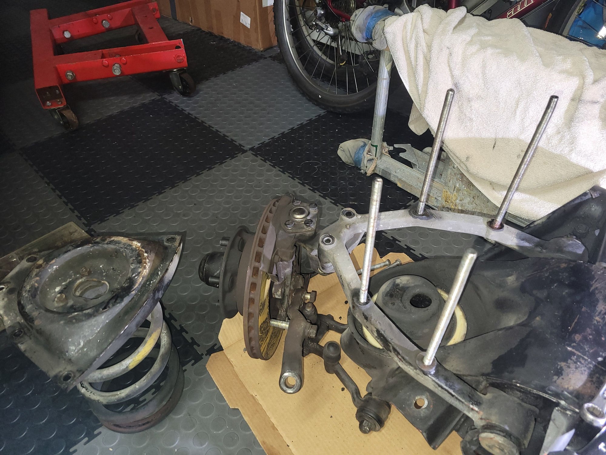

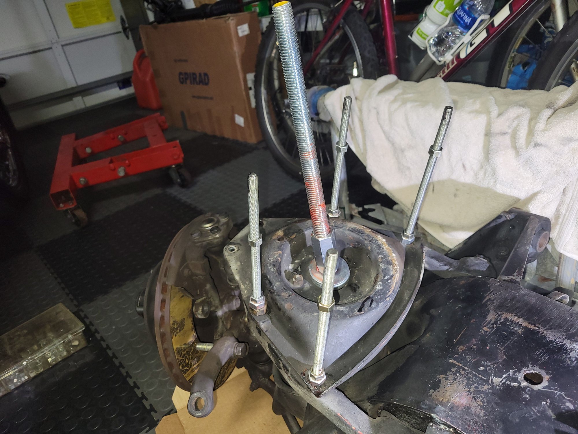

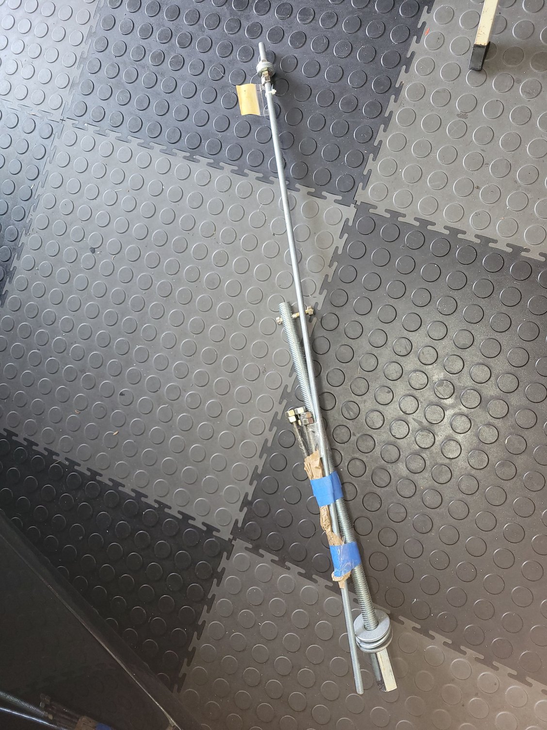

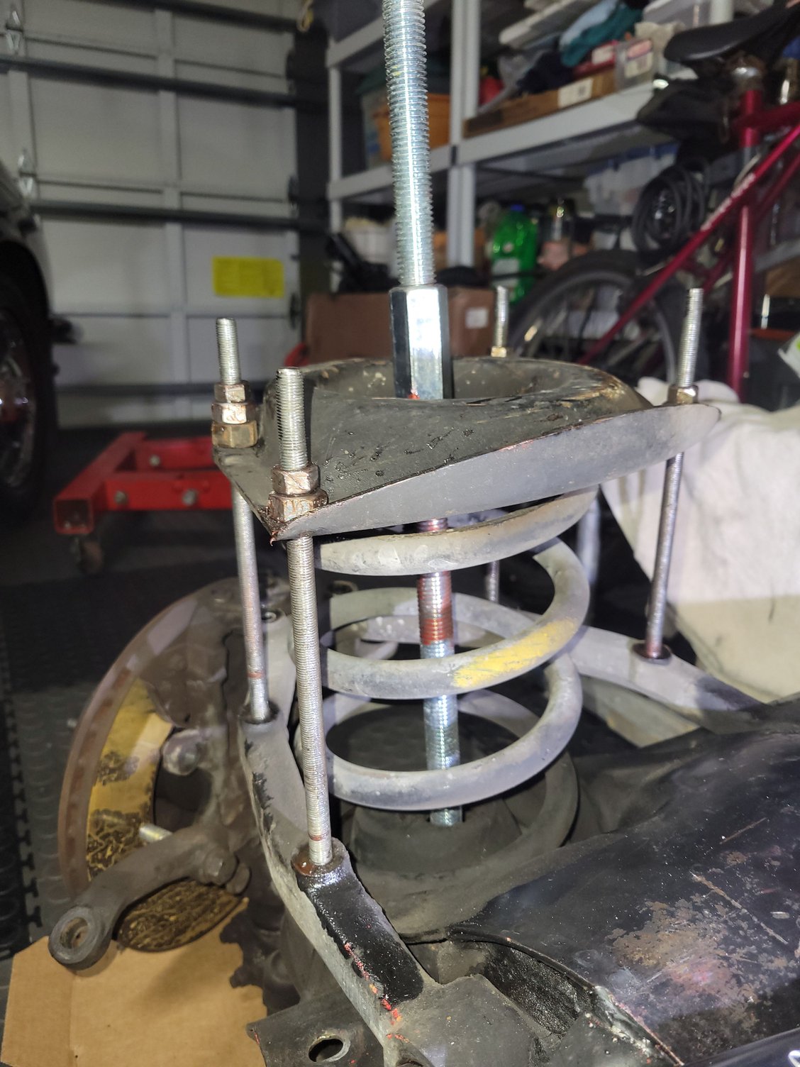

Update - Was waiting to receive the 9/16" and the 1" self-ratcheting wrenches to do the spring removal. As you may recall I got the 1" threaded bar and the (4) 3/8"x24 bars from Sanchez (thank you, thank you again). After turning the entire assembly upside down, I installed the 1" threaded bar first down the center of the pan hole to the top of the spring tower applying just a bit of pressure by tightening the 1" nut.. Applied lots of red bearing grease to the threads. I chased the threads on all four threaded bars, as they were used previously. And one at a time I removed a pan bolt, chased those threads in the lower A arm, and screwed in the 3/8"x24 threaded bar. Then tightened in the bar with a double locking nut to prevent it from unscrewing when I was releasing the pressure. Had to use a couple of oversized nuts as spacers under the 9/16" grade 5 nut on each bar to allow room for the 9/16" self-ratcheting wrench. Once all four threaded rods and nuts were all installed (all WELL greased up), I then started letting the pressure off the 1" nut, then unscrewing the 9/16" nuts, each until they were loose. Then unscrewing the 1" nut a bit more which put pressure back onto the 9/16" nuts, repeat, repeat, repeat, repeat - many, many times. It was a long tedious job, but VERY safe doing it that way. Tips: the self-ratcheting wrenches were worth their weight in gold; use lots of grease; be sure to cinch down the 3/8"x24 threaded rods into the A-arm using double locking nuts to ensure they don't back out when releasing pressure, be patient - your dominant arm and wrist are going to get a good workout.
All of the above was hours and hours of work. Now on to removing the lower tapered ball joint, then to the long bolt to remove the A arm.
Threaded rods I got from Sanchez
All threaded rods installed. Ready to start the unscrewing process.
Unscrewed completely. Ready to remove all nuts and rods to removed spring pan and spring.
Spring and spring plate removed on passenger side
Both springs removed!!

That's great Bill. Your pictures are worth a great deal for the next intrepid explorer. Thanks for documenting the process. Ian

Now that you've done it, it's not really necessary to have all the 3/8" threaded rods in the spring pans to remove them, as the function of the small all-thread is to keep the springs in alignment for proper installation and not required for removal.
This will speed up the process by quite a lot.
It is quite a Trepidacious (indeed, Frightening) job the first time, isn't it! But you have prevailed!

Yes, when I was into the unscrewing process for about 15 minutes, every little noise it was making made me twinge a bit and jump a little. After a while I felt very confident I was doing all this properly. I certainly knew what to expect more on the second side and I whistled while I worked. As a result of this forum and all the YouTube videos I did this job a hundred times in my head. So that made it much easier.
