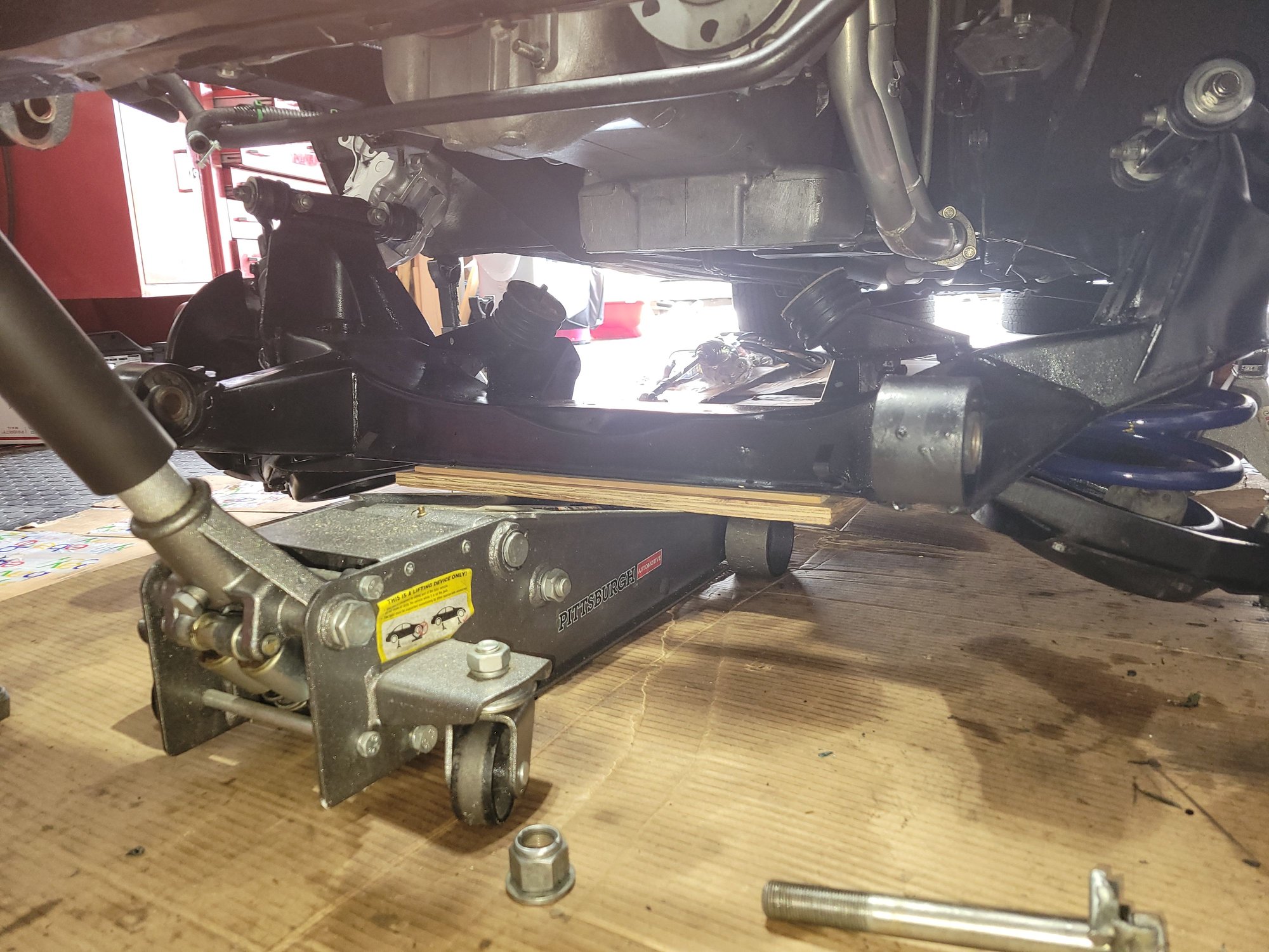

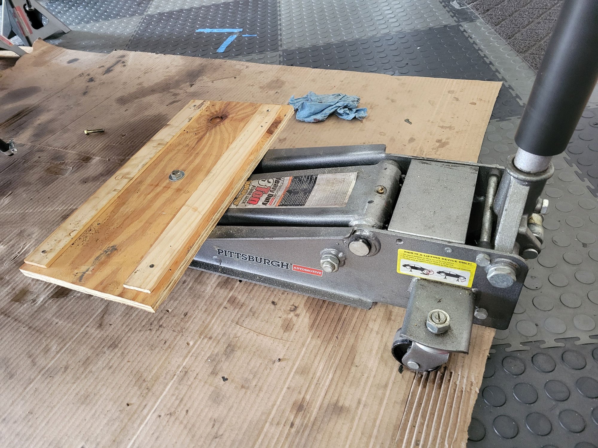

New bearings installed and torqued down, new oil pump and O-rings installed. Oil pan back on. I used a plywood board to make a 18" x 8" platform for my hydraulic jack to raise the super heavy front suspension back in place. I unscrewed the jack's OEM round plate and installed the plywood inplace. Worked perfectly. So assembly back on and tighten up, mounted brake calipers and shock absorbers. Used jack with platform to raise the steering rack into place and started connecting it back up. Only a few days away from starting her up.
Jack with platform
Raising front suspension in place
