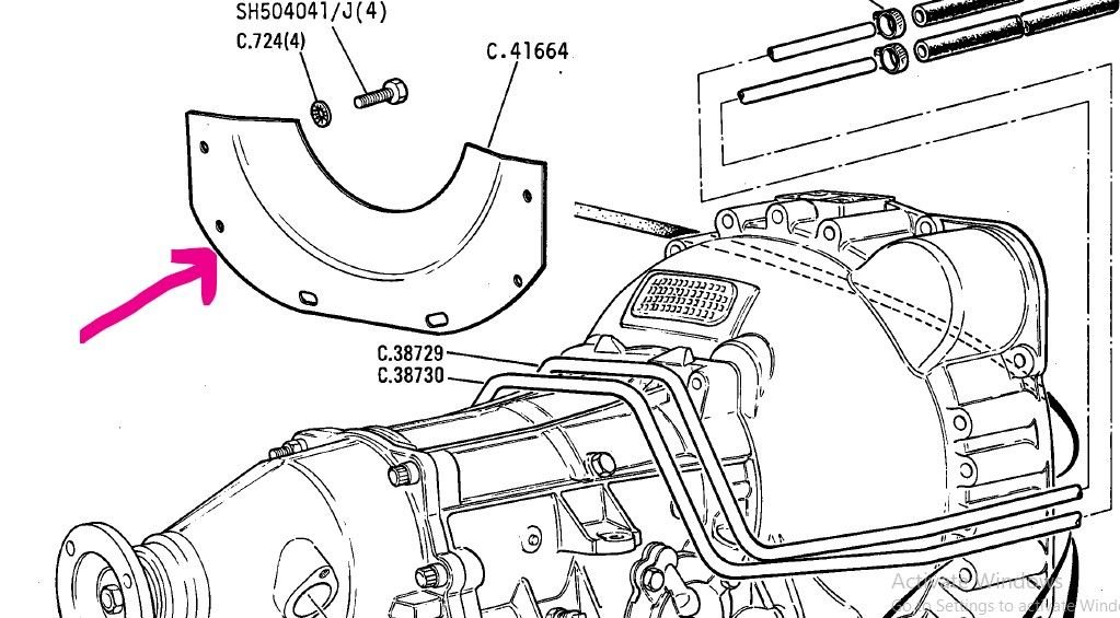

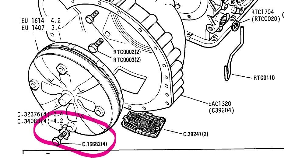

Larry - I assume this is the plate and bolts you are referring to in the below pics?

Posts: 425

I pulled the plate at the front of the transmission. And put a 5/8" offset wrench on the bolts, and put enough pressure on the bolts to turn the engine over. I would have thought if one of them was loose that I would have felt it. I had to put a fair amount of torque turning the engine with the wrench.
