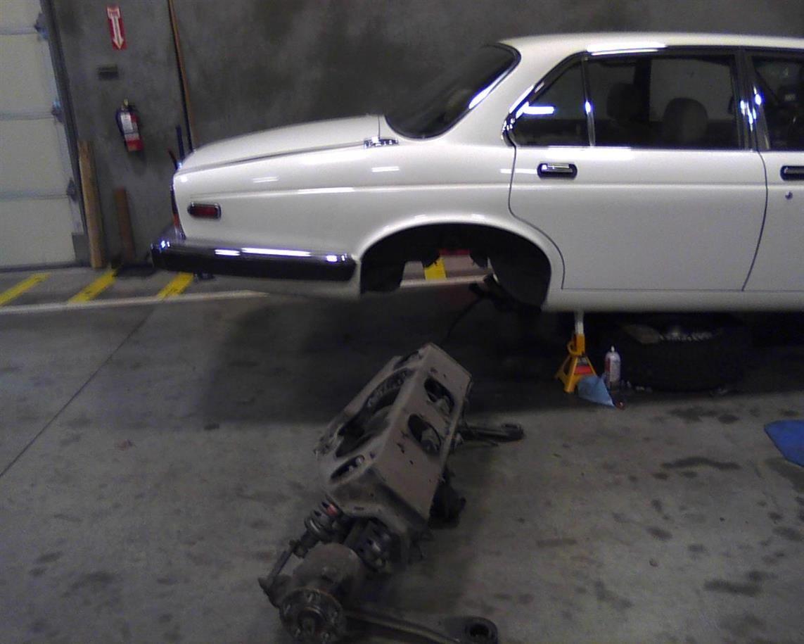

If replacing the brakes discs at the same time (and who wouldn't?) then you'll need a hoist or you'll need to drop the cage. Working on your back isn't really an option, IMO. Why? Because to replace the discs the lower control arms must be allowed to swing wayyyyy down. The only way to allow for enough swing is to raise the car obnoxiously high on your jackstands....so high that A) nobody would feel safe under the car and B) your arms won't be long enough to do the work comfortably.
As for removing the cage, if the work area has room to slide the cage out from the side the car won't have to be elevated very high. If no room, and the cage must be removed from the rear, the car will have to be elevated much higher
Note the wheels under the car. This is a safety measure. If the jackstands should fail the wheels prevent the car from pancaking right onto the floor.....with the mechanic squished in between!
