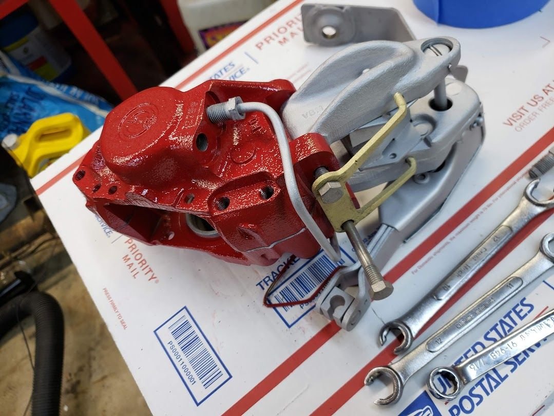

Originally Posted by Thorsen
The emergency brake calipers are pretty simple - there are no hydraulics involved. In the picture below the emergency brake calipers are silver with the brass separating fork between them. The main brakes are your typical hydraulic units and are red. The main brakes have an external cross-over pipe delivering brake fluid to the other side.
