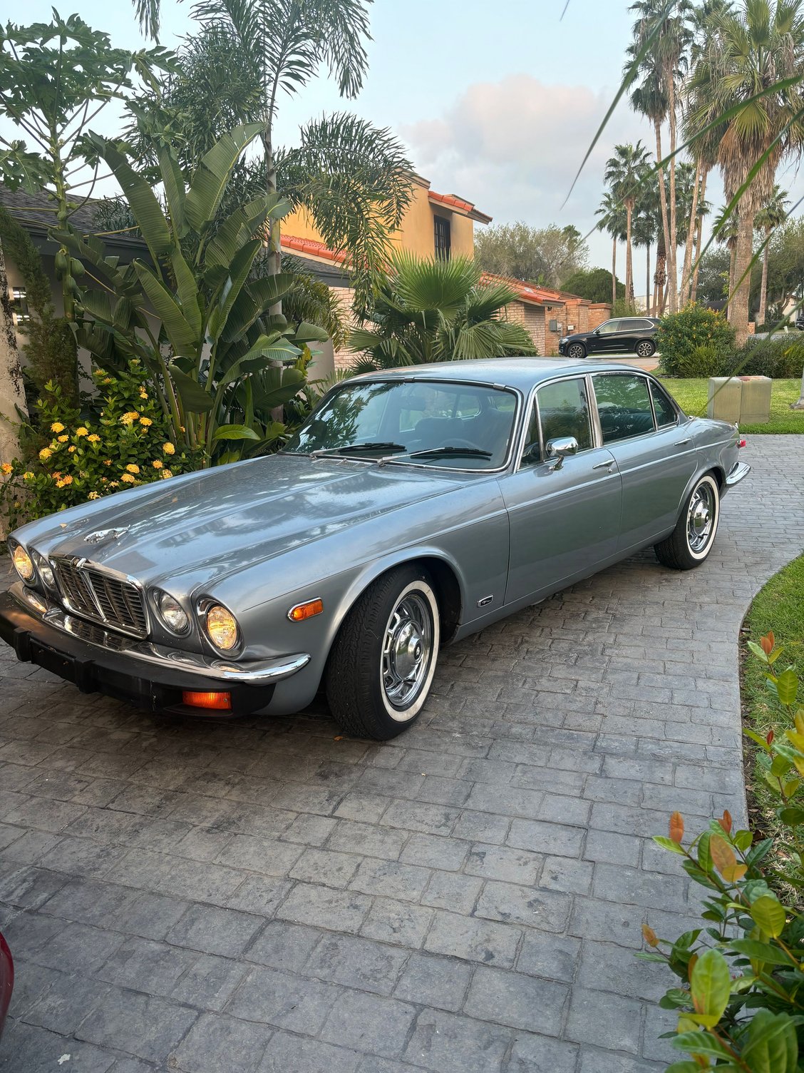

I pulled the charcoal canister. Some rust came out, pretty good amount. That’ll have to get replaced but unfortunately, it wasn’t the culprit. So I guess I’ll have to look into the fuel tanks. I’m new to this whole project car thing. Can’t say I enjoy it but I’m sure it’ll be worth it if/when I can get everything sorted out. And yes, it’s a ‘76 and carbureted. Just for the hell of it, here’s a photo:
Old Nov 8, 2024 | 03:58 PM
Jose's Avatar
Posts: 9,137
Likes: 2,659
nice example, worth fixing.

That is certainly a nice original example and worth the cost of maintenance. Looks garage kept. Looks like you're in Fl maybe, plenty humidity and rusty fuel at the canister means rusty tanks. My recommendation would be bypass all the time trying to clean components and get it running (temporarily). Just plan on new tanks and flushing out the fuel lines, valves and probably carb bowls, a little pricey but you'll have a happy classic jag. You'll want to take a peek inside the tanks just to confirm condition, remove a tail light for access to the fuel sending unit, pop that out and peek inside with a flashlight being very careful with raw fuel and fumes. Some study on the forums would be in order first imho... BTW...this system works well as designed but wasn't intended to last 48 years without replacement.
