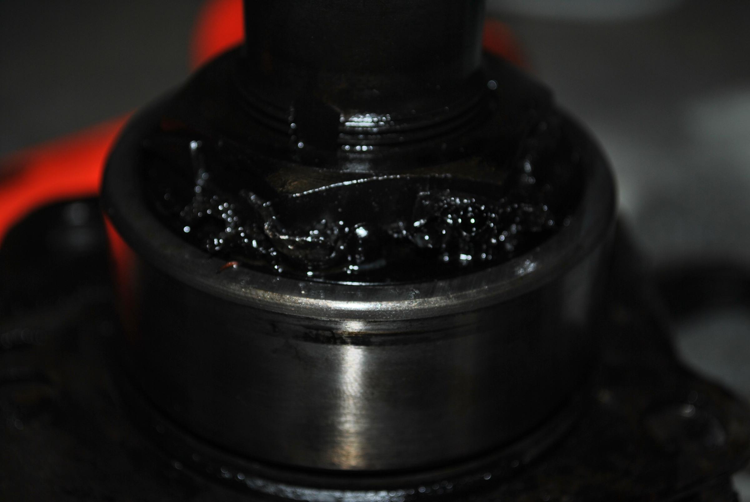

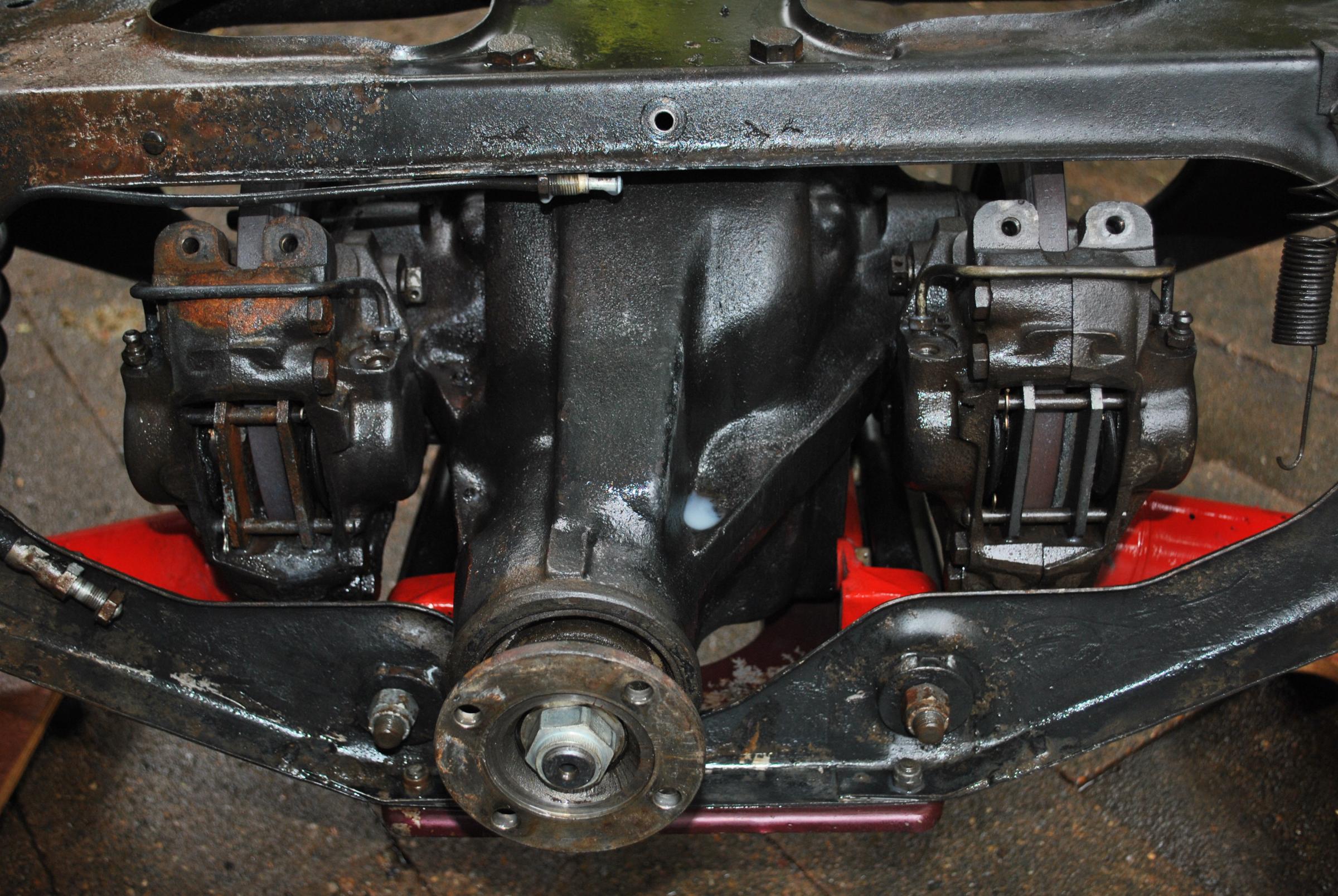

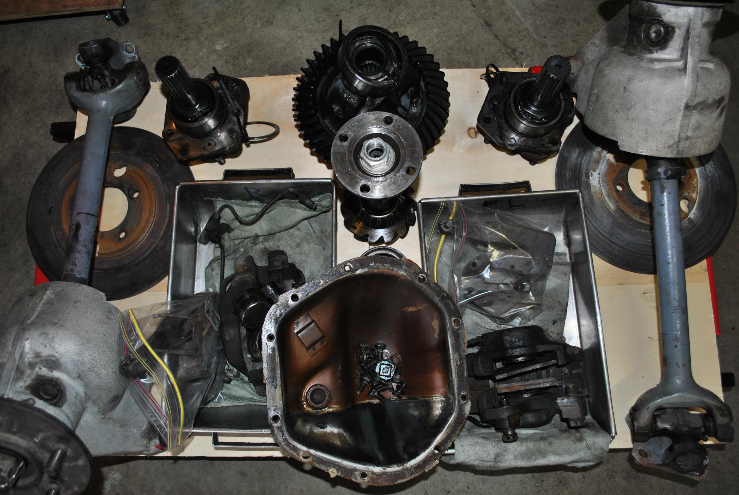

Going by my book I have Salisbury diff, Vin 1L30046BW. Went to parts store, they think I would have a Dana diff(going by the "Hexico" pinion seal part number I gave them), Can anyone tell from the pics.

The question usually comes up relative only to mid-80s XJSs. In those cases the mystery is simply solved: Dana manufactured diffs don't have a drain plug; Salisbury diffs do have a drain plug.
AFAIK your Ser I would not have anything but a Salisbury, and from the pics I see that you do have a drain plug.
However....
The situation gets bit confusing as even the Salisbury made diffs are a kissin' cousin to the widely used 'Dana 44' differential. If any of the parts, including seals, look 'Dana-ish' and/or are cataloged for use in Dana differentials, it wouldn't be surprising.

Definately has a drain plug, and a Jaguar mechanic(40+ years experience) said it was a salisbury, Just the girl at the parts store put doubt in my mind. But in saying that she has been there quite a few years and has always been right before.
I've been using the same shop for 16 years and she has been there at least half of that.
Update, I should Know about the drain plug thing as my Jeep has 2 Dana diffs and no drain plugs major PITA

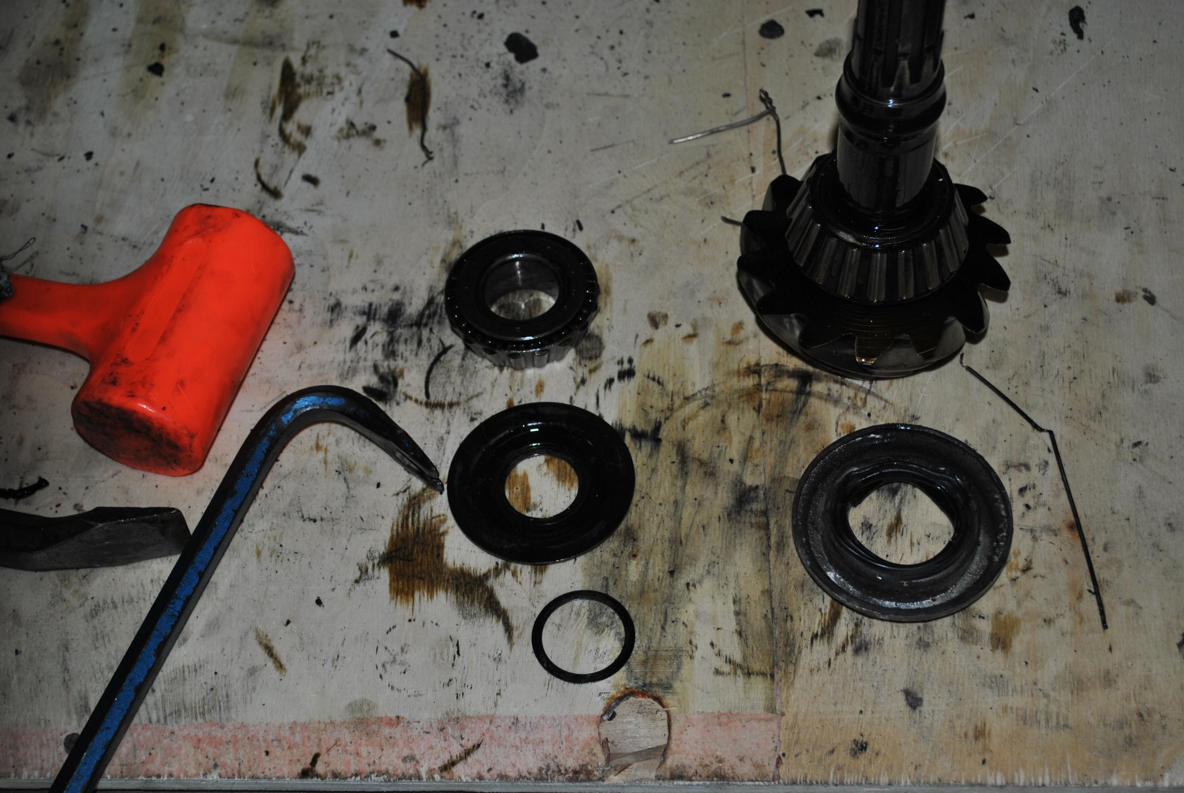

AFIK and based on my experience, the Dana seal will not work. You need part number CBC006923. From my recollection when I tried this...The Dana seal will physically fit but had the Lip in wrong place so it wont seal properly on the pinion shaft.

I need to identify diff because bearings are burnt and oil seals melted from the fire.
