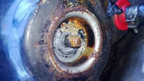

That problem has not come back since the first time, however today I refurbished the master cylinder and inspected the rest of the brake system. The rear end (thank god!) seems to have been done recently enough before my purchase. Discs / Rotors still perfect, pads have a lot of life. Front end is fine, no leaks, discs/rotors ok, pads need replacing in the next 5,000km / 3000mi.
Master cylinder, the seals and rubbers were quite worn and it was leaking from the top seals by the reservoir. So let's hope I've resolved this issue.
Master cylinder is REALLY easy to remove, rebuild and refit.
Some pics:
1. Removal (2 bolts and the brake lines)
2. Removed (traces of some really old grease)
3. Rebuilt and refitted
